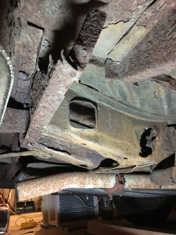

That being said and feeling confident that I will get this car on the road this spring. I checked out the next phase of removing the gas tank to flush out. That’s where the fun ends…..I have a setback and need some advice.

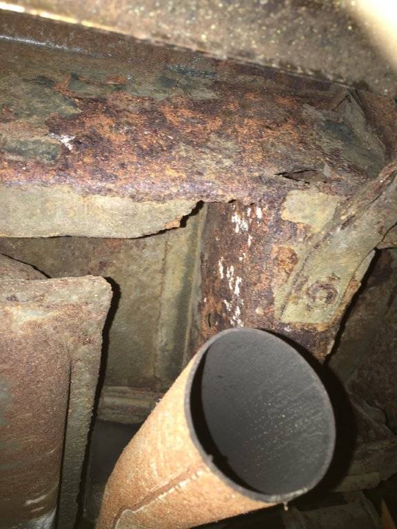

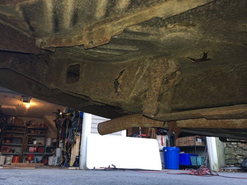

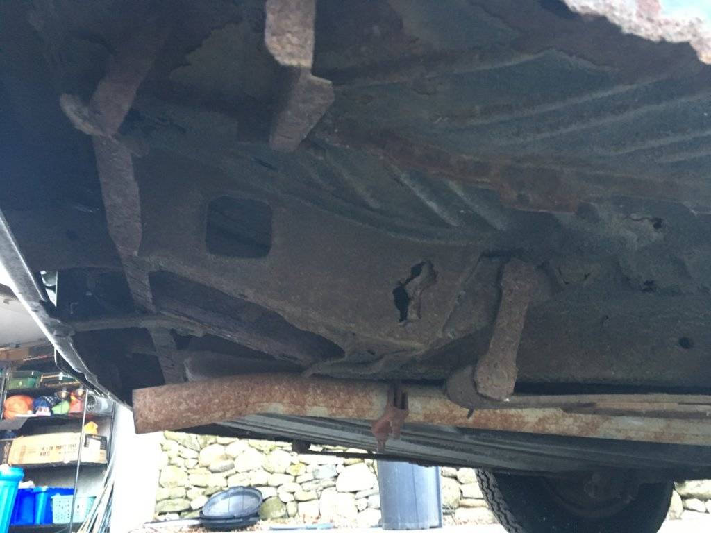

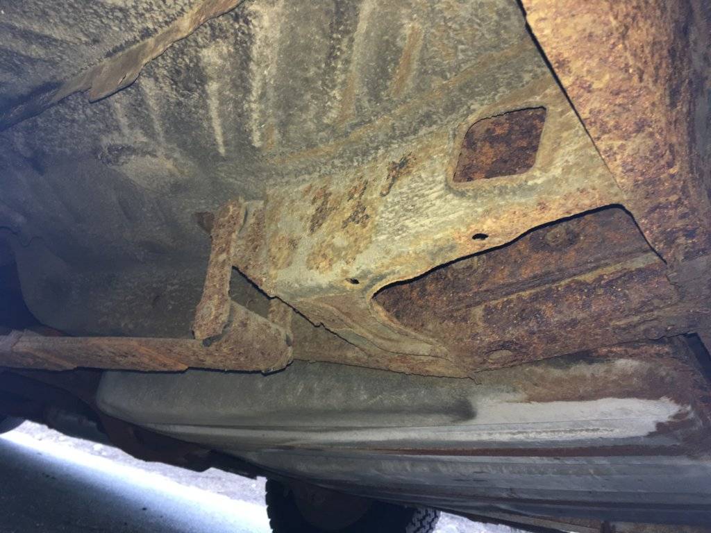

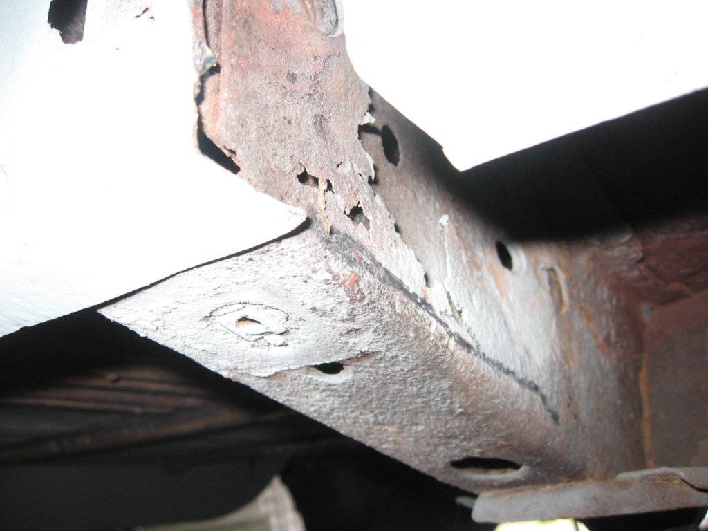

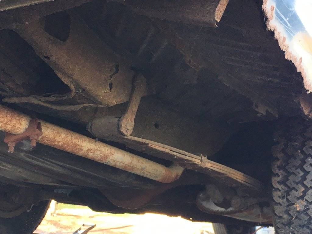

I followed the tank straps and realized the rear frame rails from the torque box back to the bumper cross rail member are rusted out and should be replaced (spring shackle towards the bumper). I knew there was some rust but I started to pick at it and now have some missing metal. (See attached pics) Trunk pan under the trunk mat has holes above the tail pipe too.
So frustrated that I did not see that before....but then again it was a garage find buried to start with. I did source new rear frame rails from a desert car in Texas over the weekend for $1000 with shipping.
Here is my question…..since I need to repair/replace the rails…it’s probably a good time to replace the trunk pans, tank, filler neck, rear spring shackles and springs at the same time. How complicated or expensive is that (I envision welded bracing to hold the uni-frame steady/square)? Is it worth it?

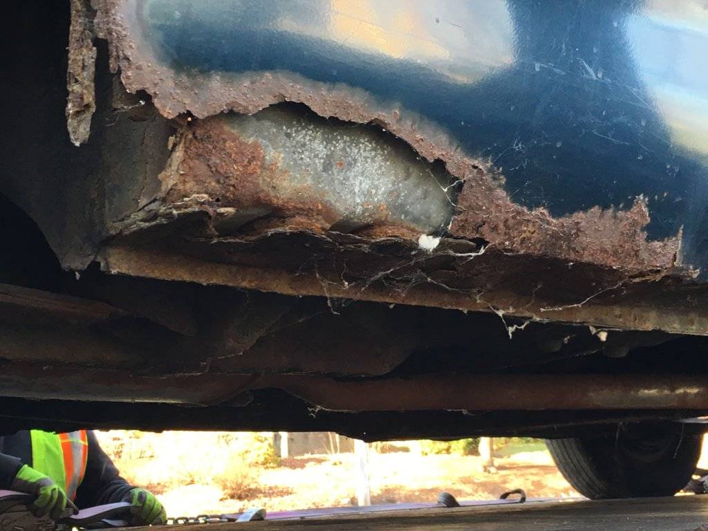

also someone asked how the underside was - I spent some time under the car after my discovery. Floors are solid. remainder of unibody rails are solid. Yes - 50 years old you would expect some rust somewhere. quarter panel edges as expected on Passenger side (which i was aware of). Did source front fenders. Got a lead on rear quarters from another desert car. That all the ugly I have found so far. Interior is "Mint".
I would start tapping the frame rails with a hammer, if they still ring, they are probably still sound enough to patch. The small hole back by the spring shackle can be patched with a gusset plate. Replacing the whole rear frame section is a very major undertaking and the car should be placed on a frame rack to be sure everything is properly lined up. You do not want a car that is "dog walking" down the highway because of a poorly fitted rear frame section. FYI having a shop replace the frame rails is not cheap and may well cost more than the car is worth. Your rear springs appear to have lost their arch and probably should be replaced. Small holes in the trunk pan can also be patched, the pan does not look that bad from what I can see from the underside photos. Be sure to check the mount points for the gas tank J-Bolts to be sure that they are still sound. The lower quarter rust can be spliced assuming the upper parts of them are solid.
Dave
From what I'm seeing, unless you are going to turn this into a show car where the underneath looks as good as the rest of the body I don't see the need to replace the rear portion of the frame rails. I think you just need a good welder to weld in some reinforcement plates. However, I would sandblast those areas first to make sure those areas are not worse than they appear.
Similarly, I'd patch the trunk floor where needed. I don't see a need to replace the tank filler tank, just the tank unless it can be boiled out by a radiator shop. Don't see the need to replace the shackles, just rebuild them when you replace, re-arch or have a leaf added to the rear springs. Just my thoughts.

Cool - I wondered about that - wasn't sure if "patching" a frame rail would be allowed or accepted during car inspections. Not intended to be a show car at this time. My goal is to get it to be a weekend driver with the kids. Definitely need to replace the springs/shackles....they are "upside down". I can definitely patch the trunk pans. I will clean off the rails to see what is good/bad. If there is enough solid metal then i will patch and continue on the fuel system. Then continue to finish the engine fluids, gaskets/rubber, brakes and tires. Ok - that is some positivity then. The lower quarter are repairable and you are correct - can patch the lower sections.

Hi folks - quick update. did a quick test ...Cleaned off the rear rail from rear spring shackle to bumper. Hit it hard with a hammer to see what was soft, scraped off old rust proofing then wire wheeled it. Good news - patching rail may be in order vs complete replacement. bad news...but looks feasible....may need to re-create the cross member that runs past the filler neck. Looks to be thin metal bent and spot welded to trunk floor - I assume 14 GA metal. Will pull car into driveway for space and remove rear bumper this weekend. I will have a better idea as to whats required on rear cross member.

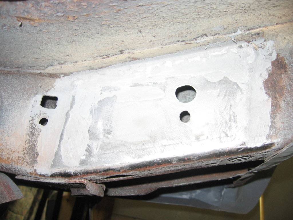

Good news that it is repairable.

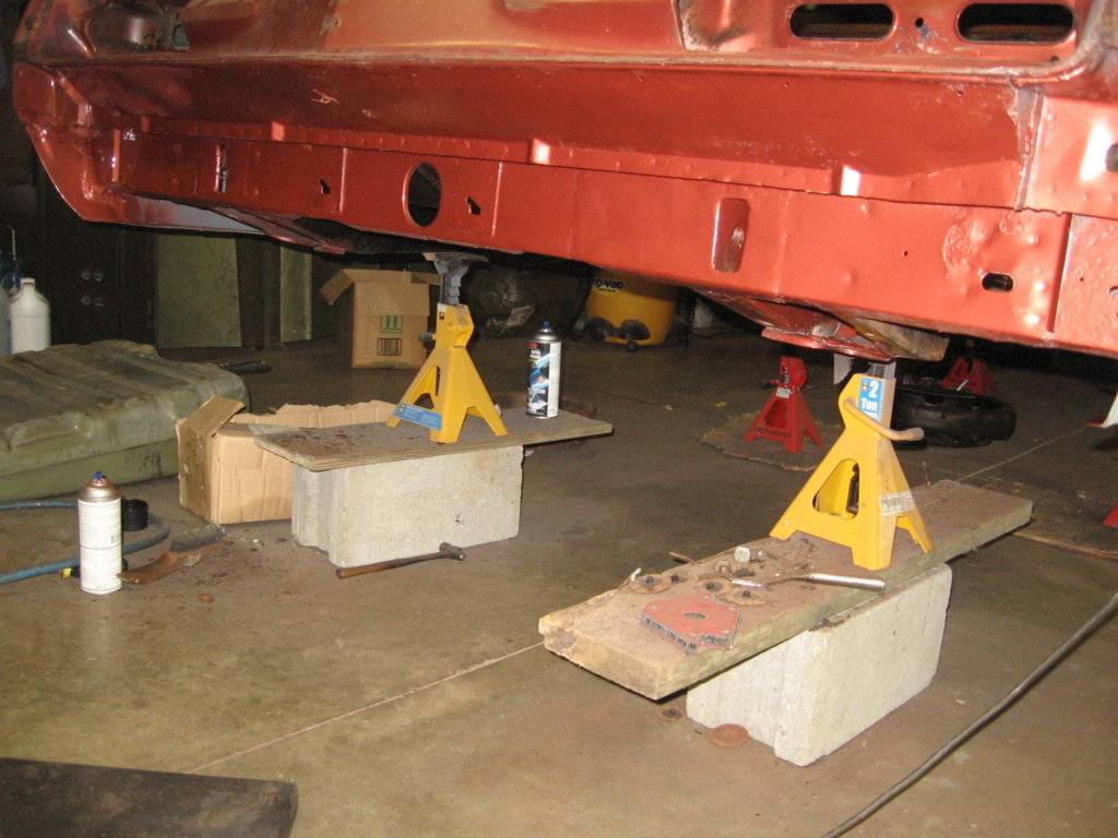

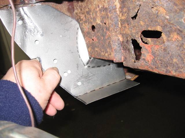

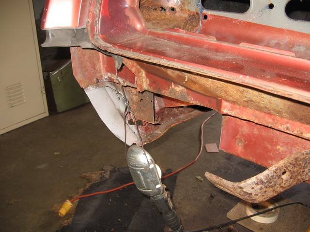

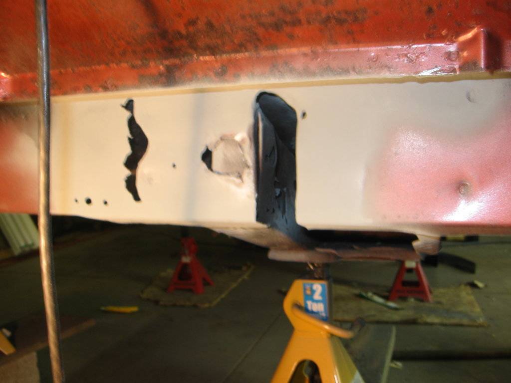

On my car I fish plated the frame near the spring shackle.
I used heavy gauge steel plate.
I removed the gas tank ,rear springs,and rear bumper to make it easier to do the repair

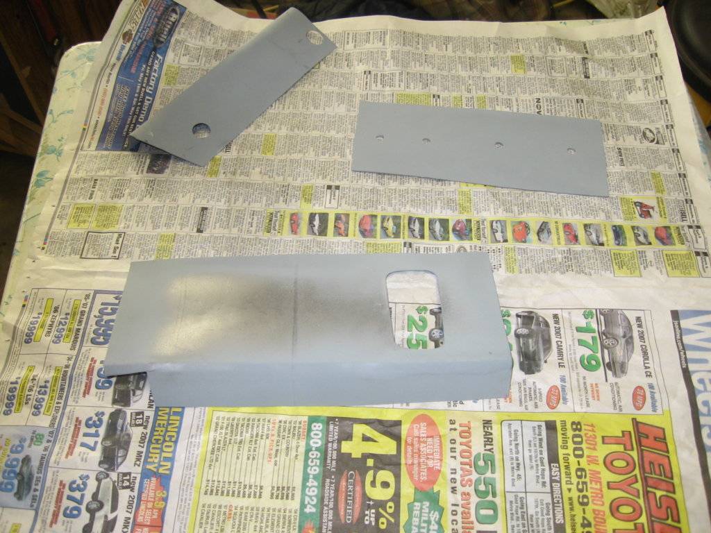

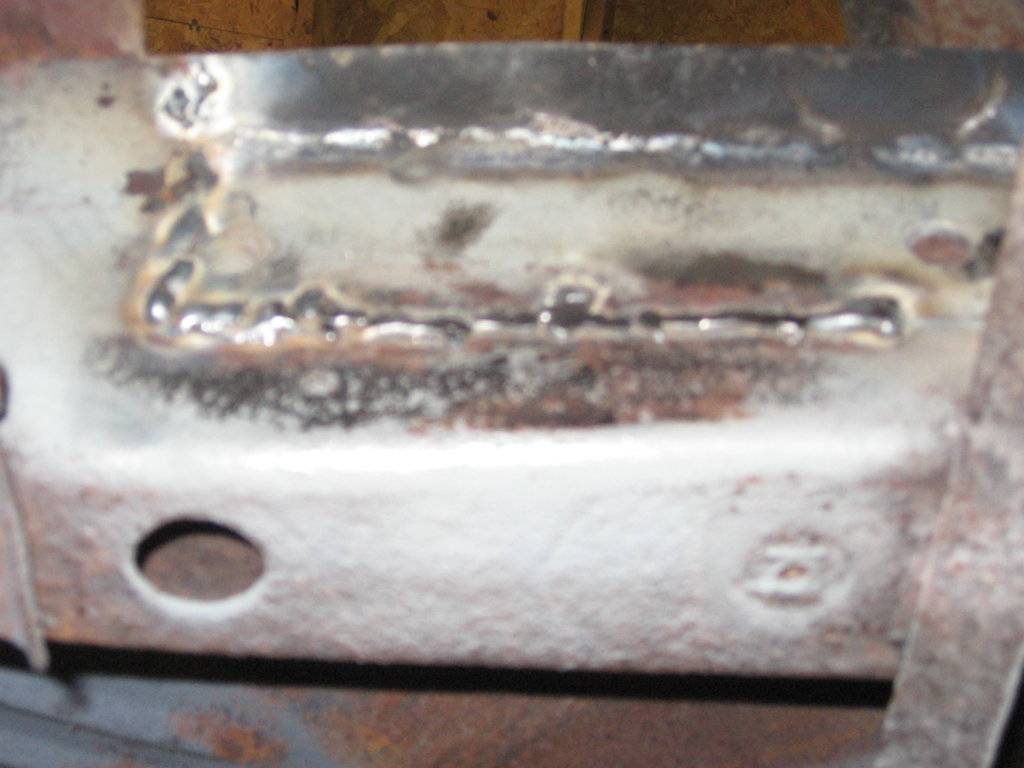

Now the tail panel is structure.
Take your time to do this right.
You can use one sheet of sheet metal of equal thickness to fabricate it.
The ends do overlap near the slots for the bumpers.
I used a brake to bend my pieces,cut the holes and then welded them in.

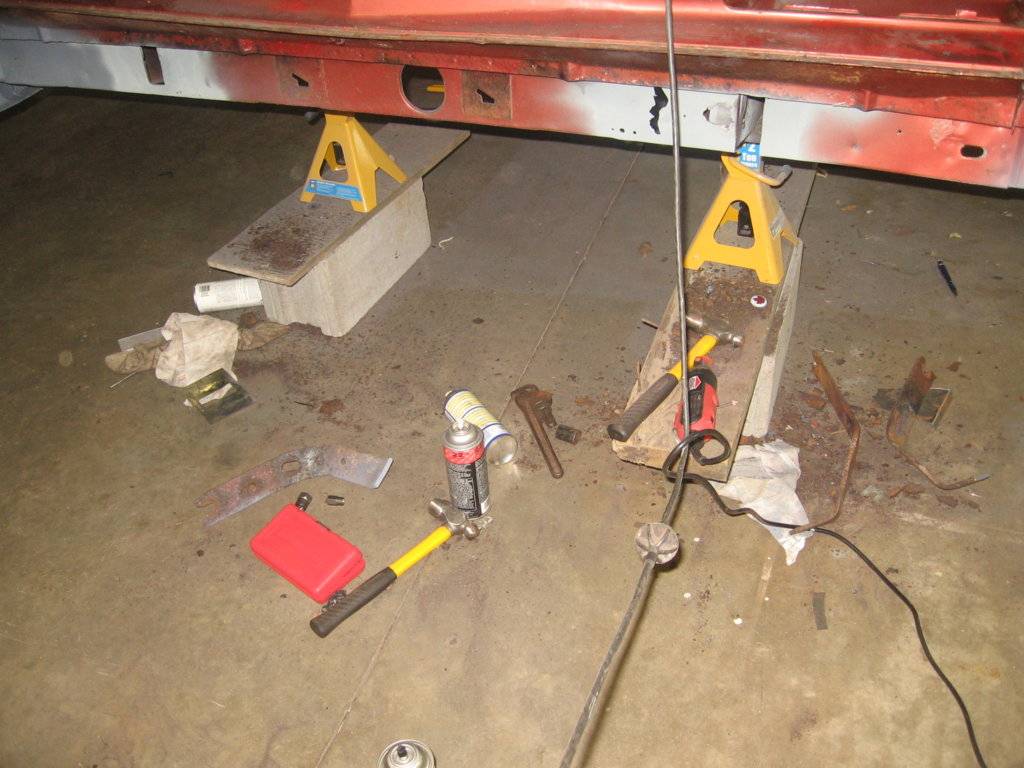

Yes - between that and a "hot wrench" may be the answer. some of the bolt heads are pretty rusted. I only had a couple hours today. I wired them off...and soaked them up with some penetrating oil. It was able to remove the smaller bolts from the lower bumper brackets (brace) at bottom of the bumper. The larger bolts at the frame will take some time. Impact gun may be warranted. I left them soaking.
I was thinking that it may be more efficient to detach the main brackets from the frame to remove the rear bumper. I did notice the filler neck bracket attached (disconnected it). I disconnected the licence plate light too. am i missing something?
I also grabbed some ziploc bags. best to get in the habit of bagging and labeling parts....along with the socket size used.
I will pull the car outside if the weather looks good next week and lift the car up on stands for more space to maneuver.
