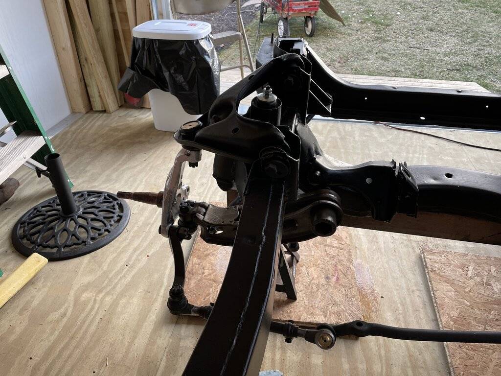

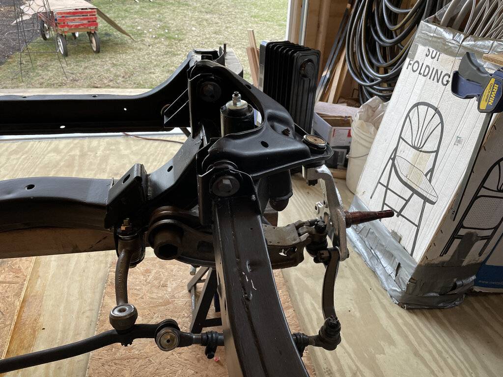

My son came home from college for Easter weekend. We had a couple hours free this afternoon. We turned wrenches and finished installing the front suspension- struts, shocks, spindles, ball joints, etc. that feels good. Next will be steering linkage, tie rods and sway bar. Although it feels good to pull it together, I am thinking about repainting the spindle and strut rods more of a cast gray. Spindles look to much like alum/chrome. Strut bars are fine but would make for a great accent. OCD...what can I say. Anyway glad to move ahead.
Had some free time this afternoon. Installed tie rods, center link, idler arm. Using a temp bolt on idler arm for the moment to hold every together. Will likely swap bolt with the one on my fury since the whole assembly will replace the one that’s there. Sway bar is next.
View attachment 450754View attachment 450755

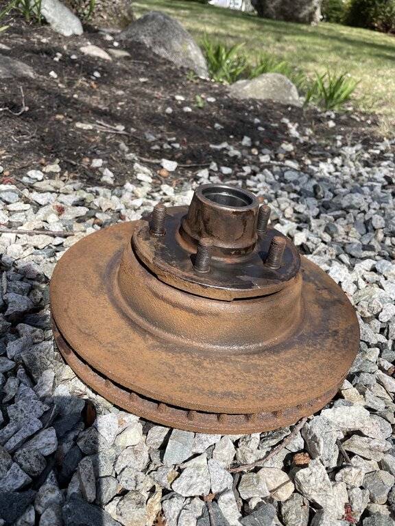

My daughter and I are cleaning up two part rotors that came w whole assembly. Mics at 1.25 and 1.24. Question for all - 1. how do I separate the hub and rotors (I will dip in evaporust). 2. How do I remove seal/bearings?

To remove the bearing you need to pull the seal. You can also use a punch to tap the bearing and push out the seal, but you have to be very careful as to not damage the bearing. If going that route you must put the punch on the inside bearing race surface. If your replacing the bearing then just knock it out.
The rotor will come off after knocking out the studs and then you still may have to drive a chisel between the hub and rotor to separate them.
Why do you want to separate the hubs & rotors? From the look of your daughter cleaning the rotor surface I take it you are going to use these rotors, I wouldn't clean anything but just put in new outer bearing races (or use old, your choice) send them to get resurfaced and if they come back out of spec/unusable scrap the rotors.
On a good 'steel' workbench I've wacked out lug studs with a 24oz ballpeen hammer, they are 'swagged in' from the factory so it takes some hammer talent to do it right, some make take more than one hammer blow but it can be done fairly quickly. Now if you want to save/reuse the lug studs or don't have good hammer skills, use a press as also if with 3 good blows with a hammer they ain't out you may need to press them anyways after 50 years of being together they don't like to part company too quickly.
