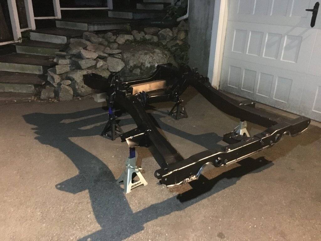

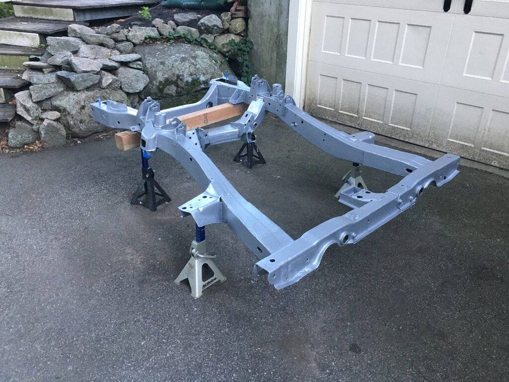

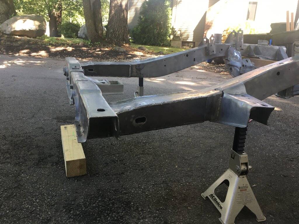

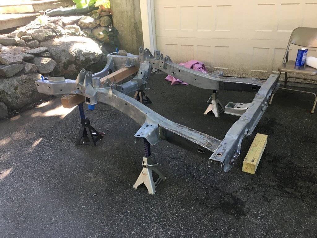

Today I took a break from house Reno’s and worked on the frame. I got it back about a month ago. Since i had some reinforcements plates welded on....it was time to clean it up again. Grind/Sanded (PIA), primed and painted. Used Eastwood Platinum For the primer and Extreme Chassis Black (satin) for the frame. Needs another coat...but a productive day just the same.
