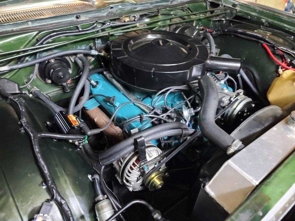

After much ado, changing water pumps, putting new fan clutches in, pulling block plug... it's time to consider the heads. I pulled of the radiator cap and observed the coolant. Right away I could see bubbles and foaming. My guess is that there's a crack in one of the heads. Currently, the car has these heads = 2951250 – 1968, 440 B/RB-series big-block, 2.08/1.74 valves, 79.5cc
Should i find it's only a head gasket I'll just plane them and get a valve job. Otherwise, I may need new heads. This is where I'd like some advice. Would it be better to find old usable heads or buy new aluminum heads, which appear to be plentiful? Also, I have my eyes on some used heads but they're from a different years 383. These= 2406516 – 1964-1967, 361/383 B/RB-series big-block, 2.08/1.60 valves, 73.5cc, 300L
Would these be usable? Thanks!
