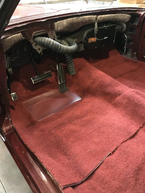

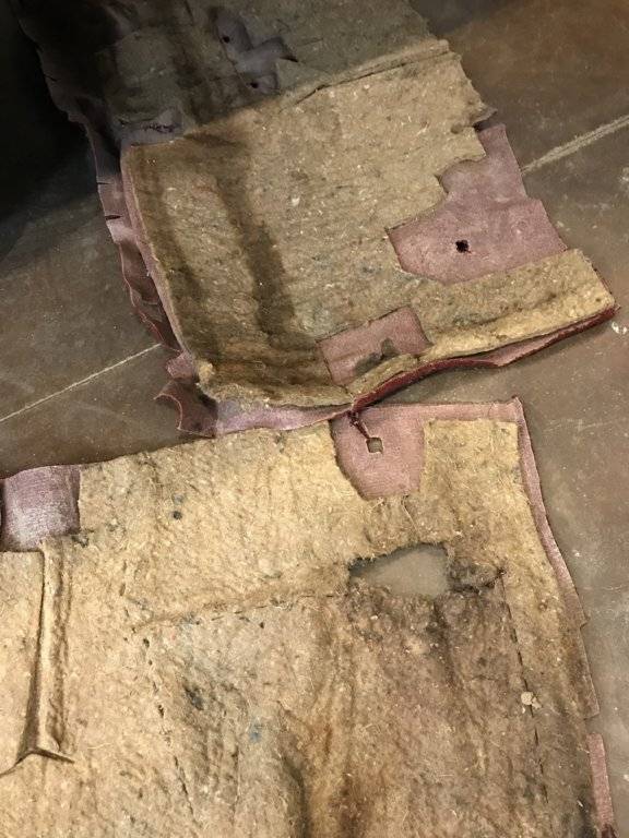

Brought my old carpet down from the attic and trimmed my new carpet closer to size. I think I need some more insulation padding. The padding on my old is twice as thick. I think I will trace out the pad on the old one to new padding and add it to my new carpet.
Ordered my window trim clips today. Next I need to start thinking about finding a front windshield. I would really like to find someone to come install it and the rear window. It would be such a pain to haul the car somewhere vs someone coming to me to install. My goal is to have the interior finished except for the seats by Christmas. Then I can get back to my seats.

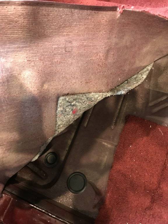

Clearly the reman carpet padhad much less thought put into it vs the original.

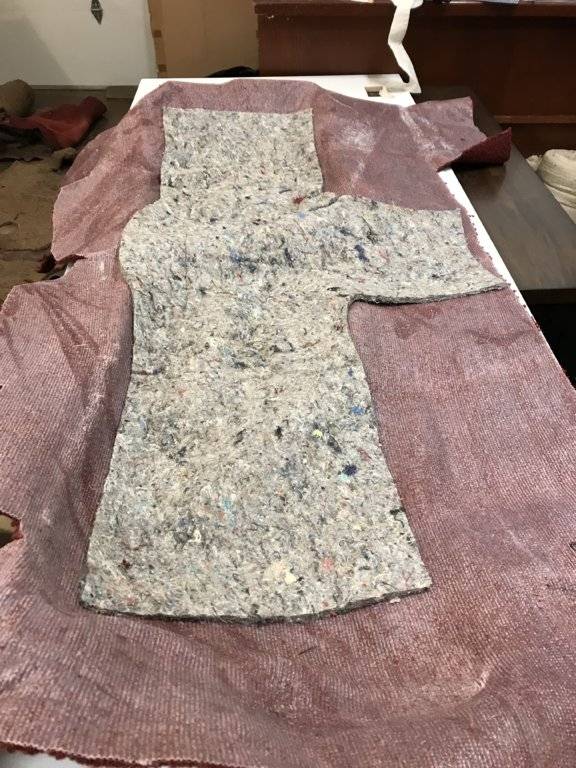

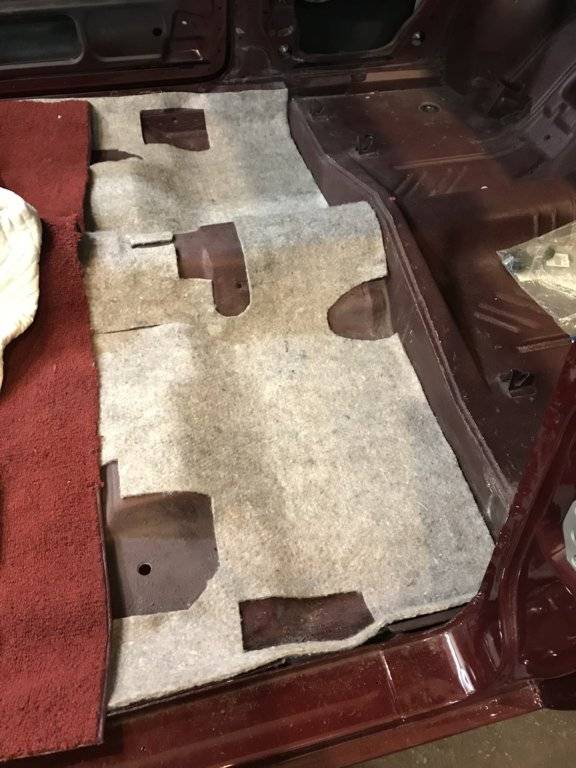

First picture pad on new carpet. Second traced from my old pad.

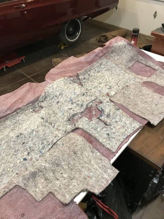

Added to the carpet padding on my replacements. Looks better now and with both layers it should be about the same thickness as the original.
Normal, especially for a carpet that was purchased decade(s) ago. I think ACC has improved the supplied backing over what you used to get.

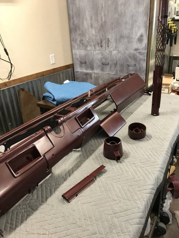

I got my dash parts back from paint today. Seems to be close to original color although maybe a little too smooth as it was a suede finish. I wonder if a Satin clear would “rough it up” a little? Maybe test a spot under my dash pad.

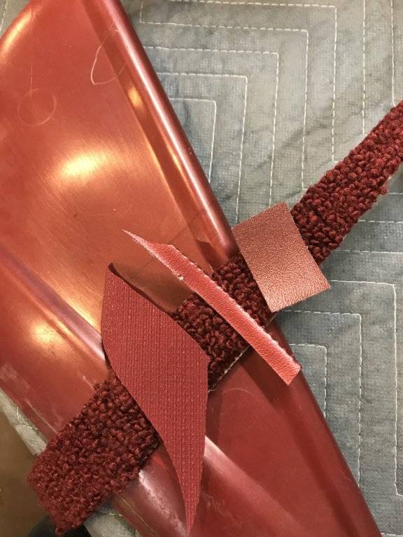

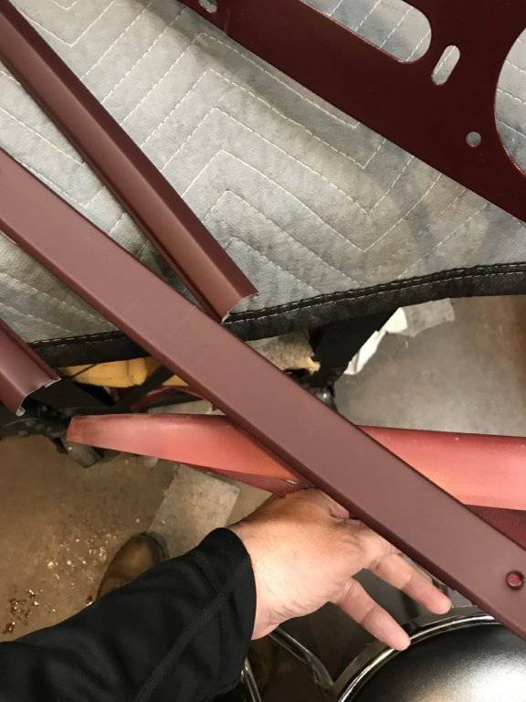

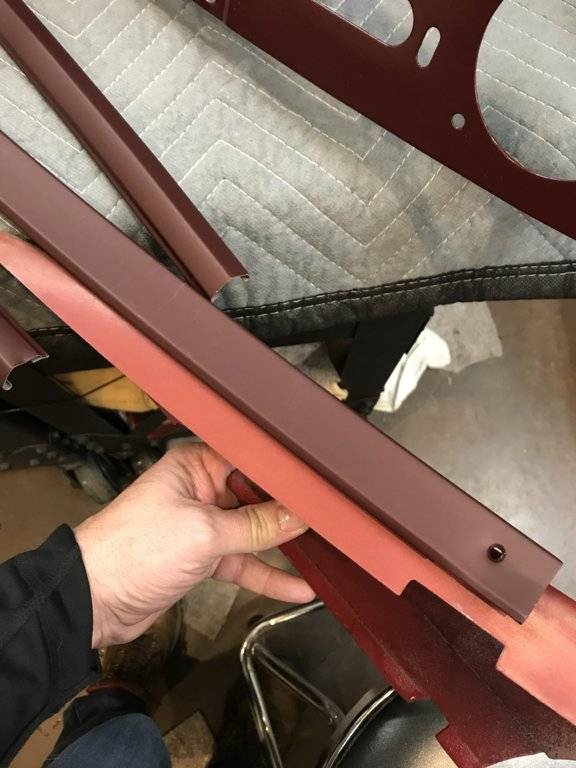

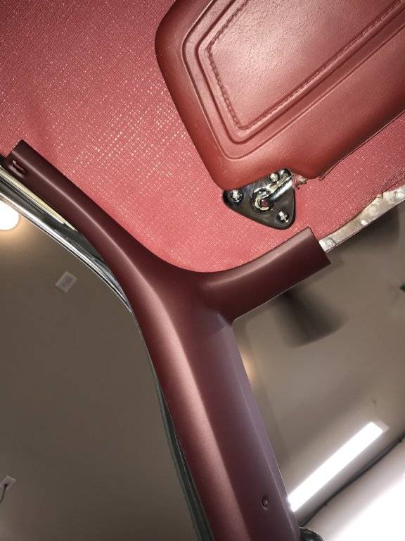

Roof rail and window trim needs to go back. It has the right finish, but the wrong color. Is supposed to be A low gloss “Rebel Red Metallic”. It is more of a Maroon color. Should be closer to the color of my seat, headliner and sail panel. Although I am noticing that my new fabric is a little more maroon than red. Either way the trim should be closer to my sail panel color and visors.
Original vinyl is the long narrow strip.
New is the rectangle. Along with my sale panel, headliner and carpet.
As far as I know, clears of different shine levels do nothing to the roughness of the surface. When it`s the shine that matters, a satin or totally matte clear would fill the need.
You haven't seen me paint, I am not that good. My finish is sure to have texture. Although not not in the right places.
On the flip side the smooth finish will probably clean better. Of that big dash 90% is covered by padding. Only below the lower dash pad shows paint.
The paint guy mentioned they were having trouble finding something they could spray.
I have been unsuccessful finding the paint on my own as well.
Dropped a couple of coats of satin clear coat on. It got rid of the gloss and now looks closer to what it did. Still not the suede texture, but it won’t bother me as much now, until I see a car wit the same color with a suede finish. I will let it cure for the rest of today and give it a quick polish.
