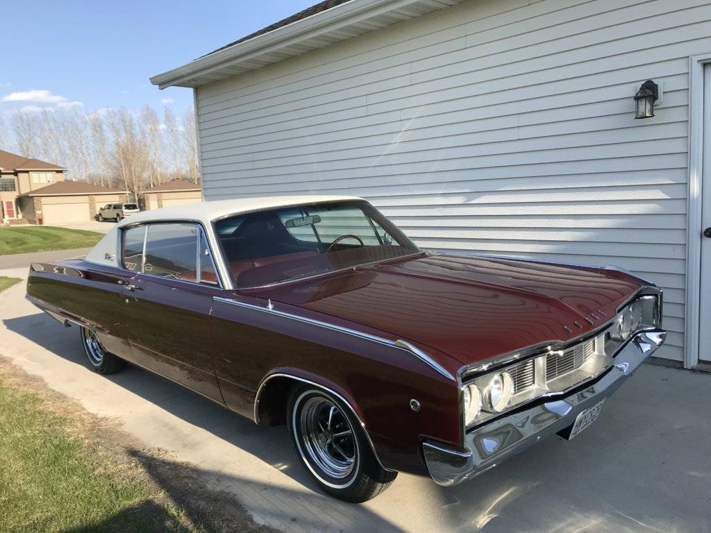

On the way to get exhaust finished.

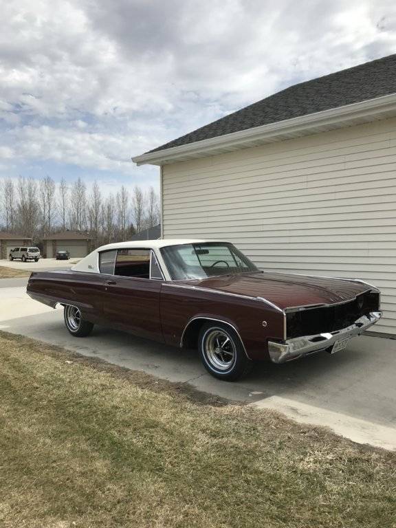

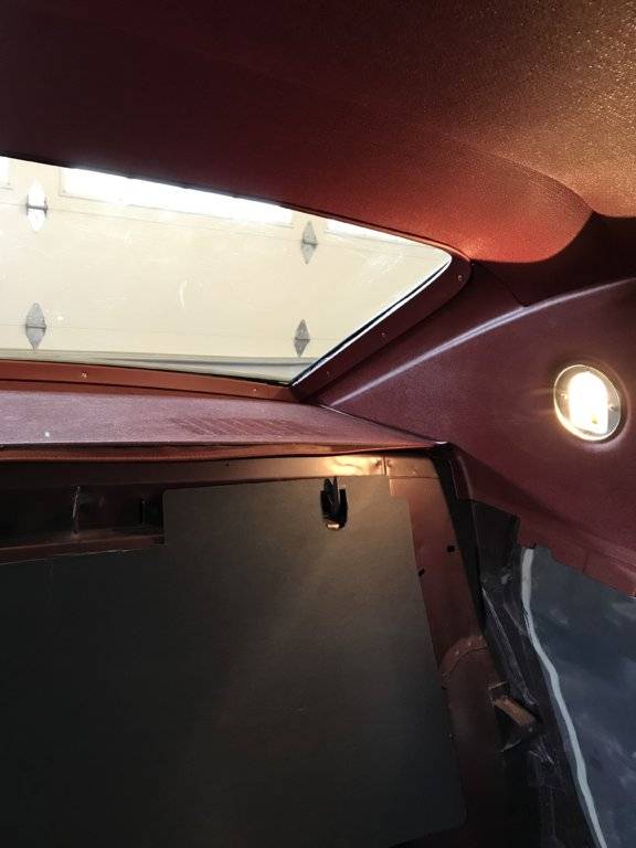

Of course it rained all night. It was going to happen sometime. You can’t always drive in sunny weather.
Good news I didn’t see any water getting in the trunk or leaking through the windshield.

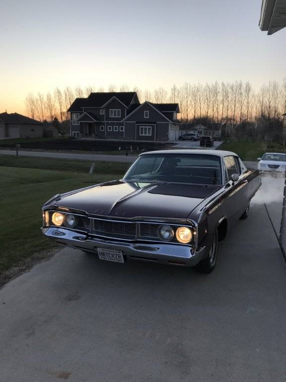

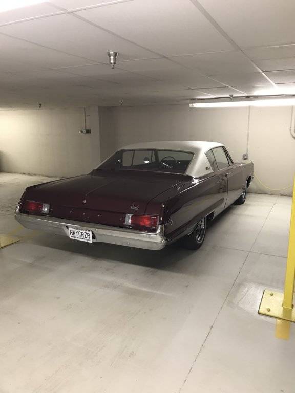

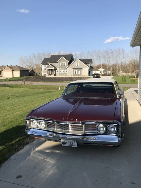

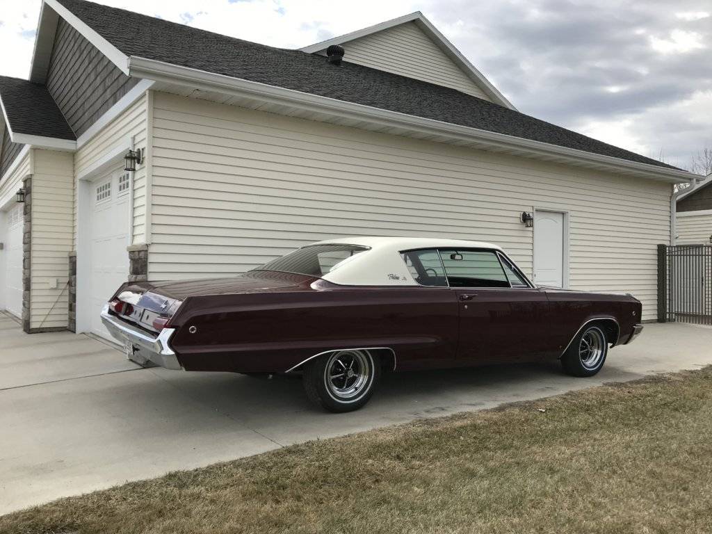

Last night in my driveway.
This morning at work.

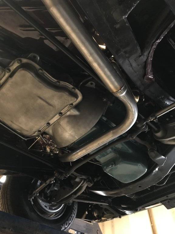

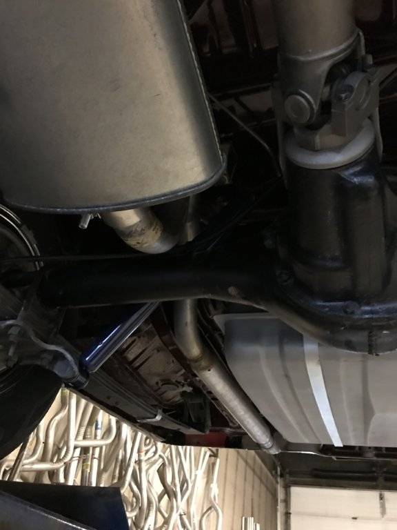

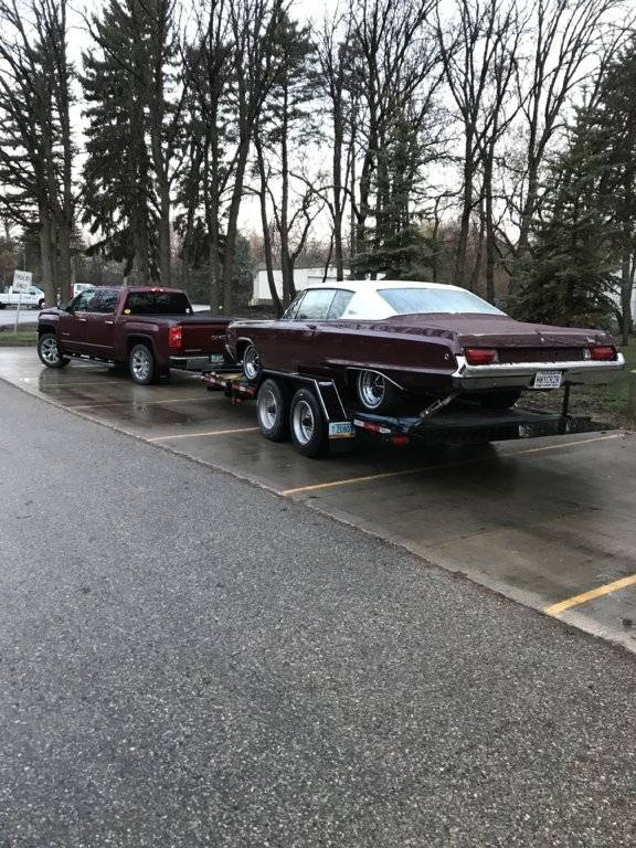

Exhaust is done. Rained both ways so trailered it back. I haven’t put on my wipers yet.

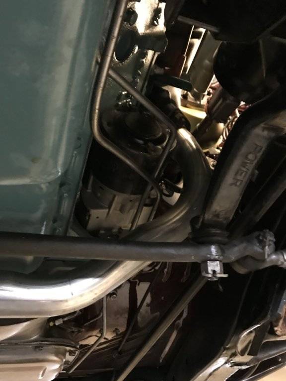

When I first started it and drove it off the lift I wasn’t sure if had even started. He had the original bend cards. And a sample of my original where the two sides come together. He talked me into band clamps instead of the original u- bolt style. He said once the u- bolt clamps are on there is little adjustment because it crushes the joint. With the band clamps, if I want to tweak something I can. I don’t think I will have to. He did a great job. He also is the only shop in town that will re- core a radiator.

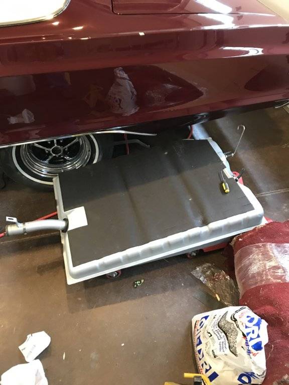

On the way home from the exhaust shop I stopped to fill the gas tank. I had spent a lot of time cleaning the tank and re-sealing. Gas started dripping out of the seams. I got it home and siphoned 10 gallons back out. I guess I need a new tank. I guess I should have pressure tested it.
I guess I will have to go tank shopping.
Two steps forward and one back. I guess not as bad as one forward and two back.
New tank ordered from Vans, new gasket and ring as well. I do still have my original ring. New vent and fuel line clamps ordered as well. Should have everything by Friday. Plan to re-use the donut for the fill tube as it is brand new. Maybe I can do the tank exchange next weekend. Will be busy next week as the rest of my chrome will be delivered Monday.

Any rattling, vibrations, tinging etc from the exhaust?
No touching the frame or engine anywhere. He did an excellent job of mocking it up and laying it out before the final welding. He did a great job on clearances with out sacrificing ground clearance where possible. The closest point to the frame or the ground is where it transitions from the engine compartment past the stub frame to the uni-body. He tucked it up as tight as he could making sure there was clearance on the top side. His bend cards said to use 2-1/4" whereas my original pipe through that area was 2-1/2. It may have changed later to the 2-1/4 for better ground clearance. The 2-1/2 is pretty large through that part.

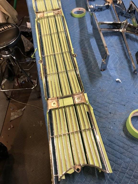

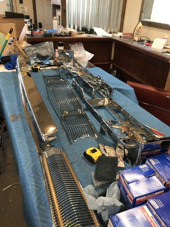

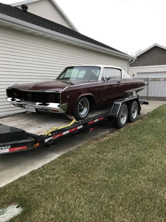

I finally received the rest of my chrome parts.
Now I have to mask it and paint the argent. Seems a shame to cover th chrome.
Old fuel tank out new one in. Arrived via UPS at 8 tonight. I think I was the last stop of the day.
Old. I need to crush it so it doesn’t get re-sold. It looks brand new.
New tank in

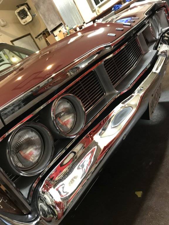

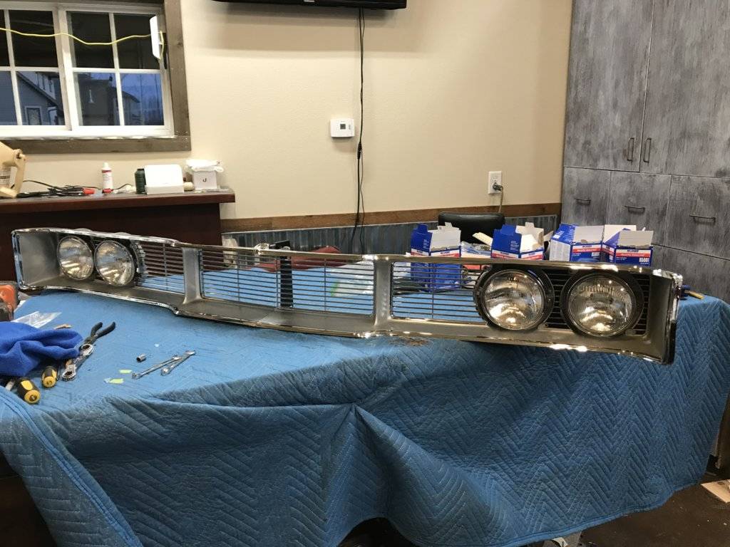

Front grill complete. May need a couple of bumper adjustments. Also need to aim the headlights.

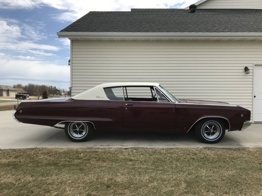

To work this morning. About 30 degrees. (Was in heated garage). Purrs like a kitten.

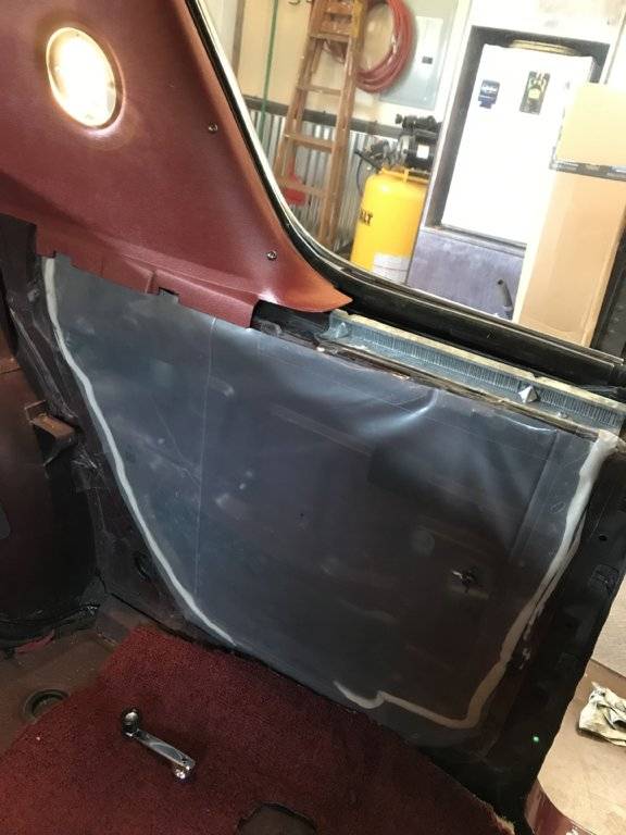

Install plastic sheeting and plugs on front doors.

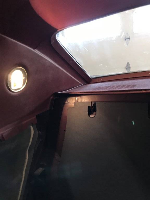

Install door panels.
Arm rests door latches and window rollers.

Install door protectors

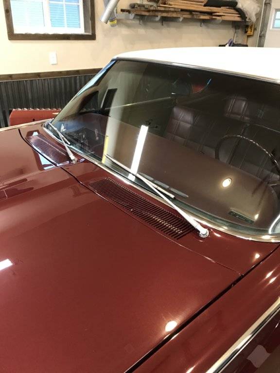

Almost forgot the wipers

Wipers on.

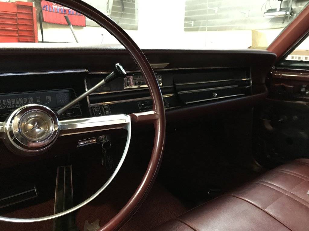

Dash bezels installed ( need glove box bumpers)
