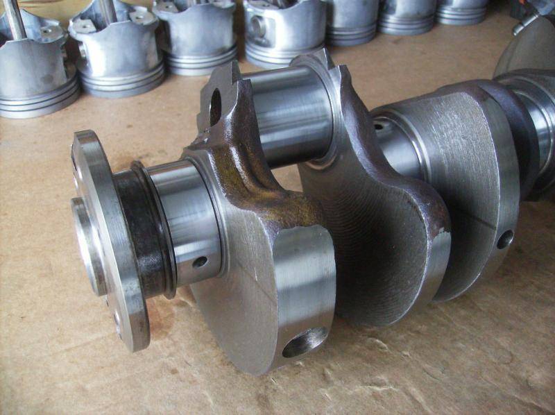

Looks fantastic. Have you mic'd it and if so what bearings do you need to use?
Standard bearings, .003 clearance mains and .002 rods. Clearance on the mains is a little on the high side, but... it is what it is. Rather have bit more clearance than be to tight.

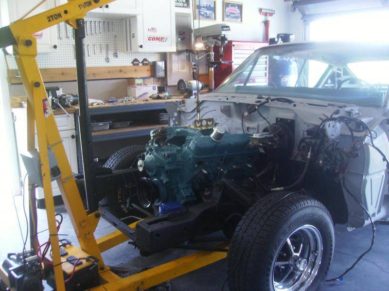

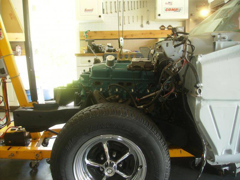

Got some work done over the weekend. She's bolted in and patiently waiting for me to finish.

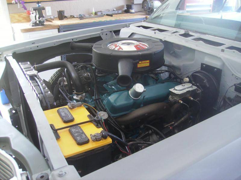

Haven't posted in a while so here's a quick update. Engine fired up yesterday. Original start up I think I had the Oil pump drive 180 off if that's possible. Couldn't set timing. Got that resolved today.
Slot in oil pump drive should be parallel with the cam when #1 is at TDC on compression stroke. Then drop dist in with rotor pointed to #1 on the cap.
Thanks Dave, I think I had pump drive off one tooth which put the rotor slightly after no.1, rather than slightly before. All good now though.
