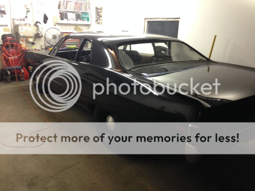

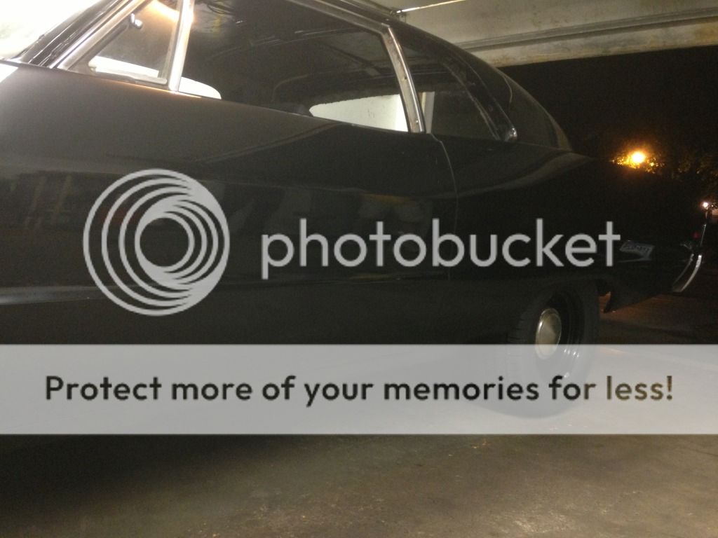

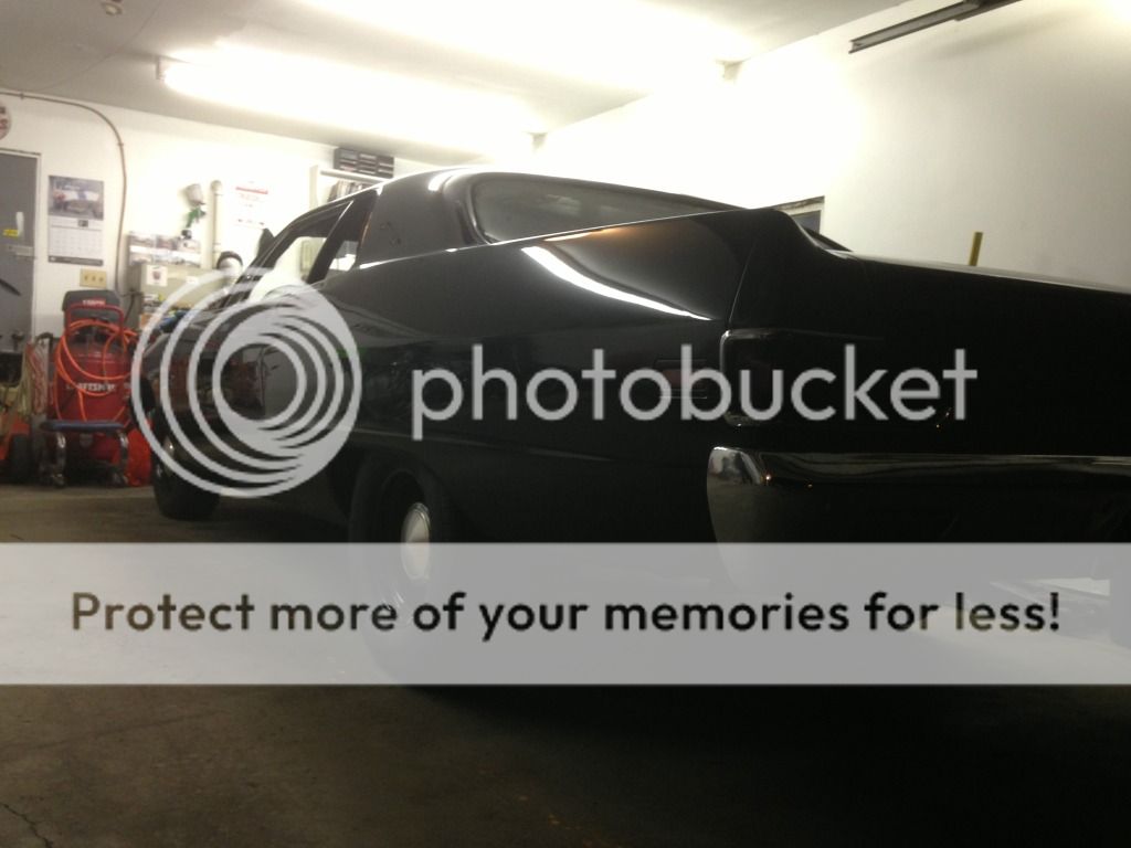

Lol, no commando I did not! Looking like friday will be the day of buffing, or at least getting started on it. Lots of paint to buff on these c bodies. I did get the steel wheels and BFGs on it and it looks really good I think. I will try and some pics up tonight.

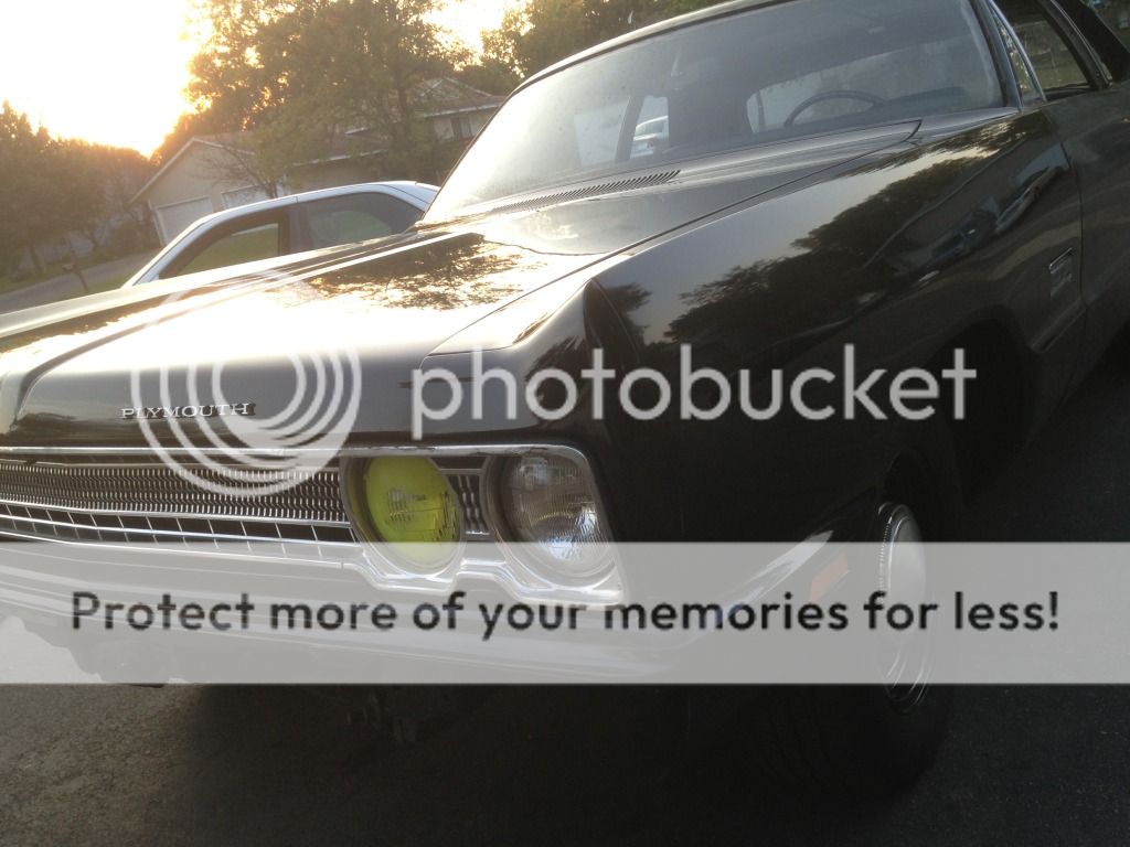

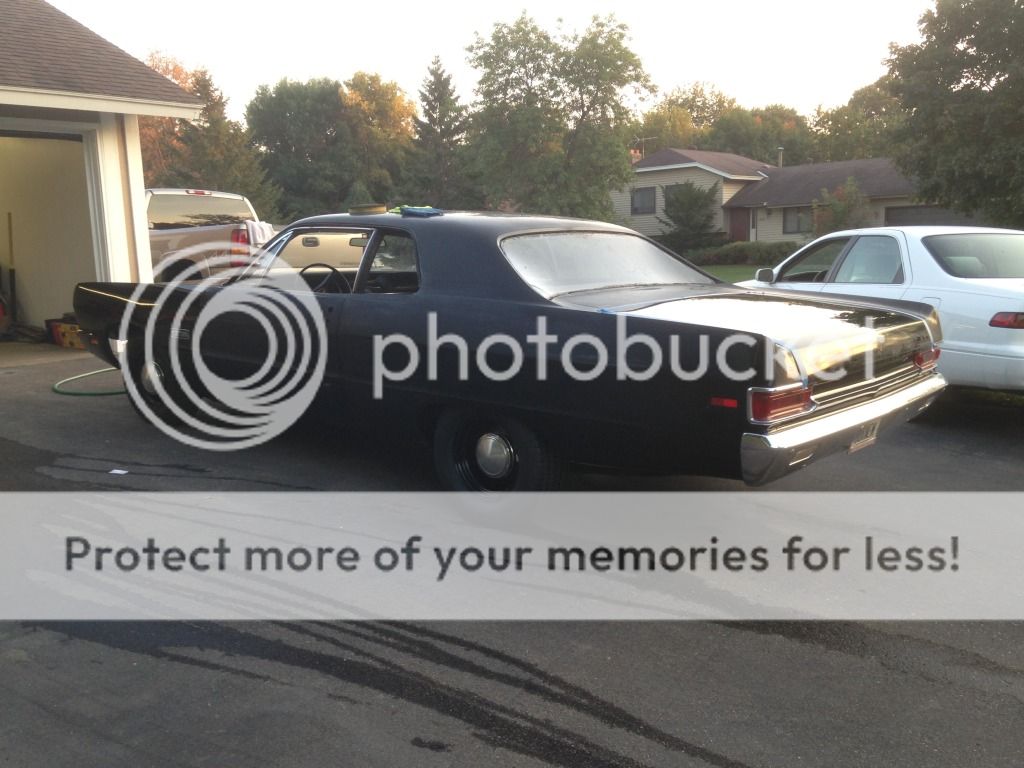

We got the deck lid done last night. It looks great! spent the rest of the evening wetsanding the rest of the car. We are hoping to finish it tonight or tomorrow. I will get pics up as soon as its done!
Finished all the wetsanding last night. My buddy came over last night and he buffed out the d/s fender and hood. Looks like wet glass! Turned out so nice. The pics I took are hard to tell how good it turned out as it was kinda late and with the garage lights it looks pretty dark, I will have to put it outside and snap some.
Great looking car! I am looking forward to some new pictures including a few of the interior.
