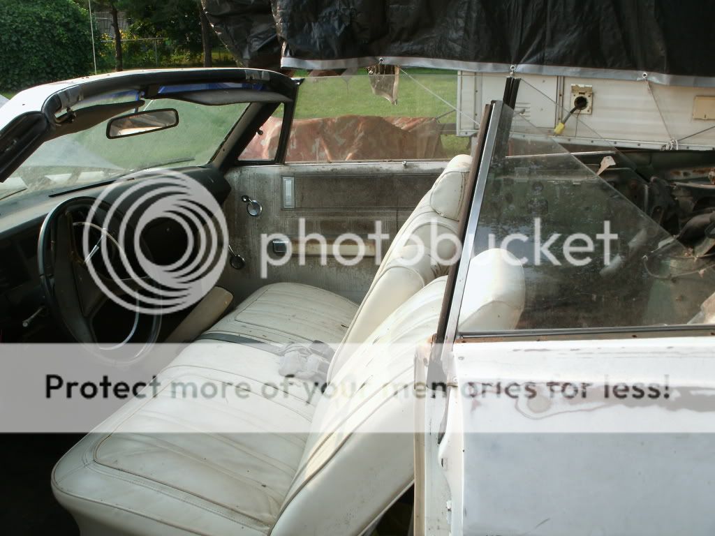

Nick, repost a pic of the way you found her again, please?
Don't have how I exactly found them (In the guy's backyard, the white car in a homemade garage, the brown car in the corner of the yard sinking into the ground.) But this is what they looked like when I got them to my uncles.
These first two are photo's he had in his ad on Kijiji
The night I brought the first car home, I took this photo at 11:57 PM, it was a long day.
And this is how they looked at my uncles as aforementioned
