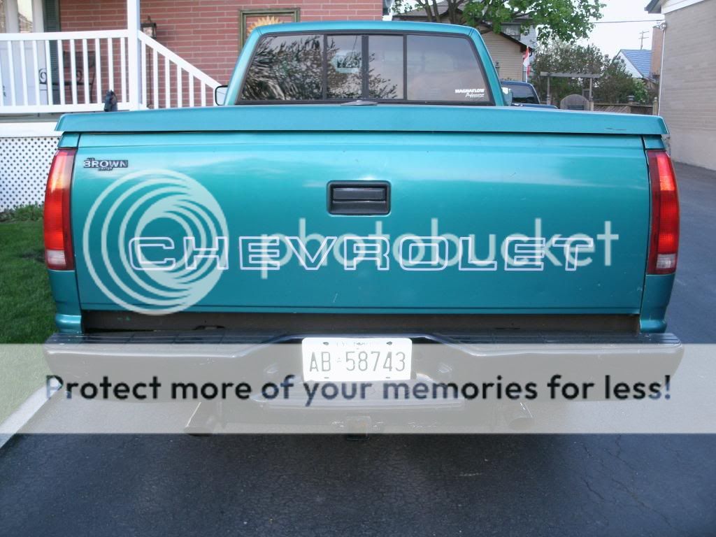

Spent some more time on the car today, Also installed my new-used lightly modified Receiver hitch a buddy gave me when he cleaned out his shop, makes hauling a car trailer a bit easier on my rig, And yes my Truck is Green (Teal actually) too.
And yes the left pipe is hanging lower than the right, I had to use the hole the factory made that the exhaust shop used for the hanger when the previous owner did the exhaust.
