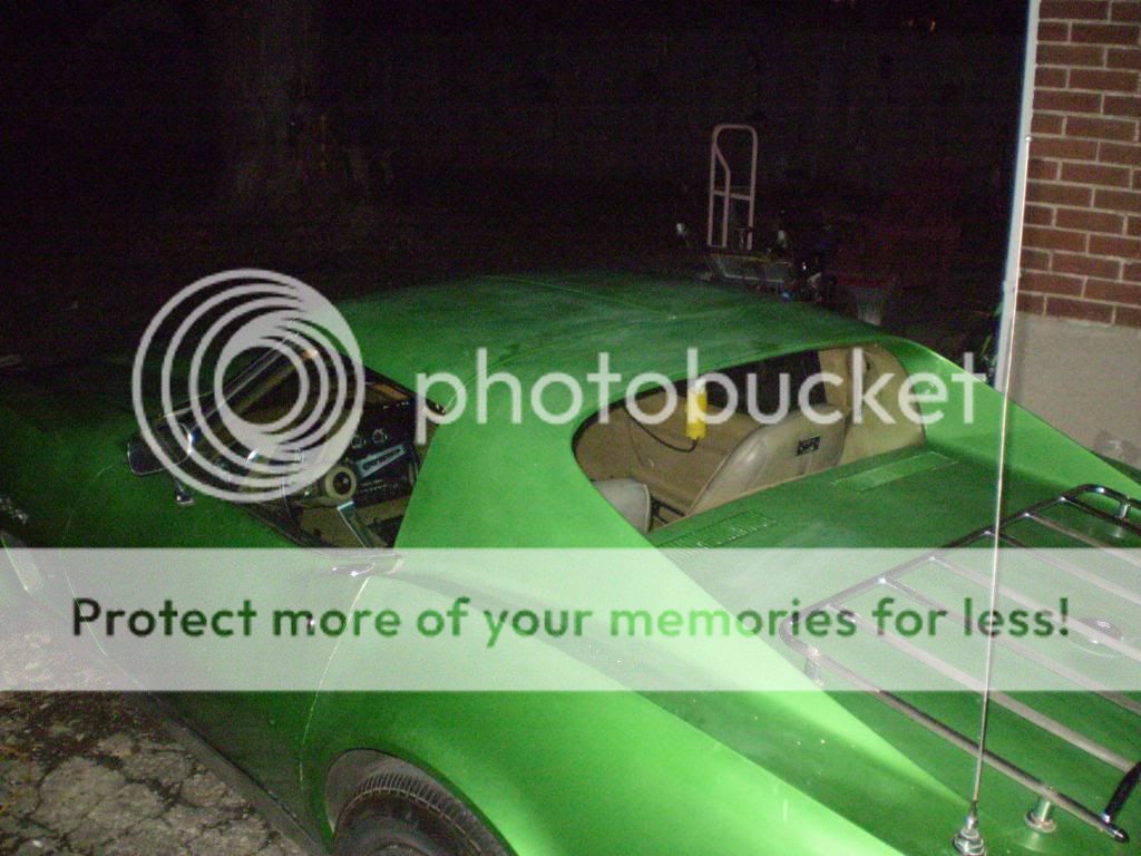

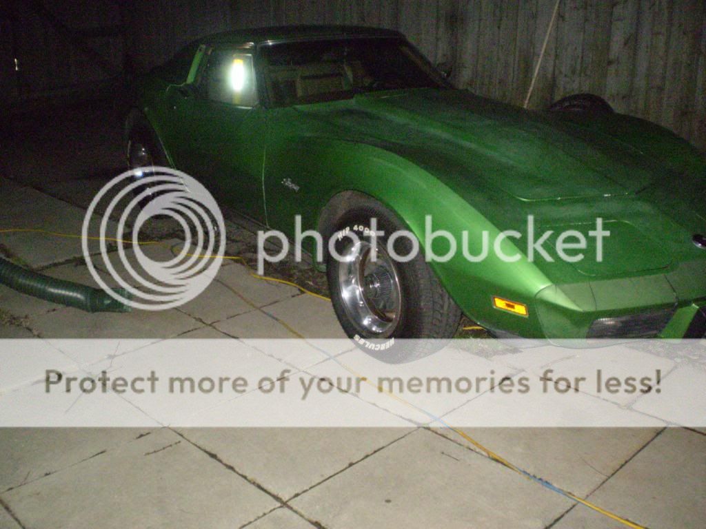

Ran into the previous owner today while he was out cruising, he now has another toy.
He bought a '75 Stingray that is all original and was bought new in Ontario, he had it painted and has refreshed a few things.
He still has this one too, it'll get paint this winter, it's an all original car, bought new just outside of Denver Colorado, it lived it's life 1/4 mile at a time till the 90's. 340, 7 leaf rear springs heady duty suspension and cooling package.
He told me to stop by and bring my photo album (of the Fury) after work one day next week. He's a good guy and is glad the Fury is being saved not Parted or Scrapped.
Nick
And yes, that's the same backyard my Two Plymouths lived and the Plates on the Duster were on my Plymouth before I bought it.
He also seems to have the same kind of workshop and garage as you according to the last pic. :)
