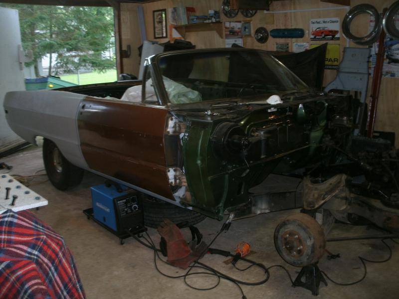

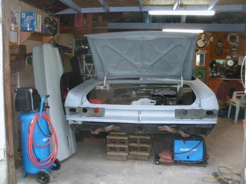

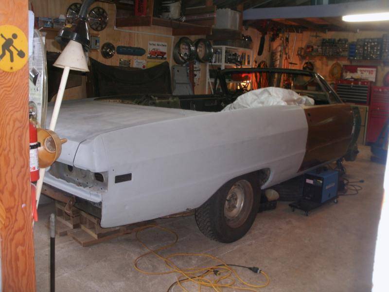

Anywho, tinkered on the weekend. Did what I physically could, Helped the father in law figure out what was wrong with his '98 F150 Plow truck. Pump was replaced with the wrong one, so it had a low volume pump in place of the correct high volume unit, it was only putting out about 10-15 PSI instead of the 35-45 psi it should of, we took the bed off because he can't and I don't like to lie on the ground.

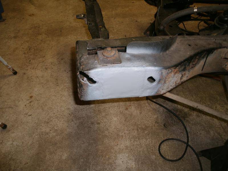

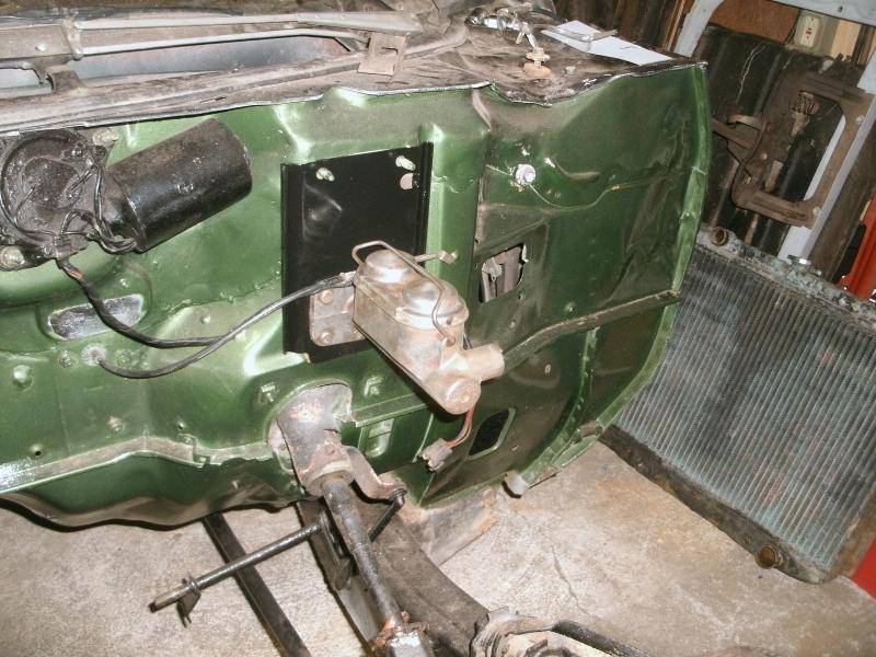

Anyway. I'm going to run manual disc brakes for around the yard until funds allow and driving creates necessity, I tested the old master and it doesn't leak, so I cleaned it up and re-painted the plate, new gasket and back together it went. Started getting my disc brake parts ready to go on. And patched a new found hole in the front of the frame, actually had the father in law advise me on that. Also turned the car around, which was a bigger ordeal then I thought.
