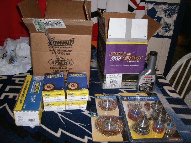

Picked up some stuff for the Fury. I buy the cheap Wire wheels because well I care less about them. Gonna give the Royal Purple a try.

The Royal Purple will do the job, but it's a really co$tly way to get it done. Living in Whitby, you probably can't turn around without seeing a GM dealer. Go in to the parts counter and ask for 992869 Engine Oil Supplement. The stuff is less than $7/bottle and it works really well. It's a 500ml bottle, and one bottle does me for 5 oil changes.
Kevin I assume the supplement contains zinc?
Yep, and phosphate.
Reading the label is rather interesting. Mentions using the stuff as break-in oil on a rebuild, dipping tappets into it before installing them in the block and pouring on the cam lobes as well. Mentions that it should be used with SF,SG and SH API class oils. But we're up to SM and SN now which are fine for roller tappet engines but bad news for us neanderthal flat tappet types.

Glad to hear you're going to get that rad sorted out. As for the Princess Auto wire wheels, make sure you're wearing damn good googles, and keep that pretty lady of yours well away when you're using them. Those suckers shed shrapnel like crazy. The Royal Purple will do the job, but it's a really costly way to get it done. Living in Whitby, you probably can't turn around without seeing a GM dealer. Go in to the parts counter and ask for 992869 Engine Oil Supplement. The stuff is less than $7/bottle and it works really well. It's a 500ml bottle, and one bottle does me for 5 oil changes.
I know they shred, I generally work alone and they do their job good enough to warrant their cost. When it comes to my oil, I'm not worried about cost, I'm worried about effectiveness, however I will buy that supplement from now on. Anyway, we got a fair bit done, we also believe my car had a sway bar at some point. We are going to finish the motor this weekend.

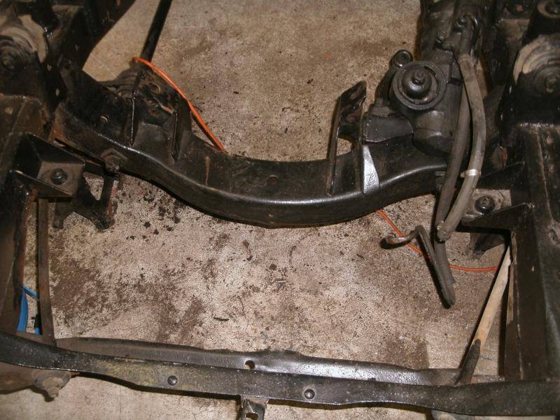

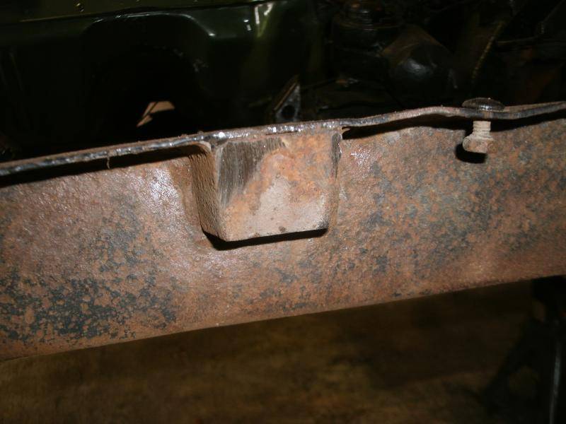

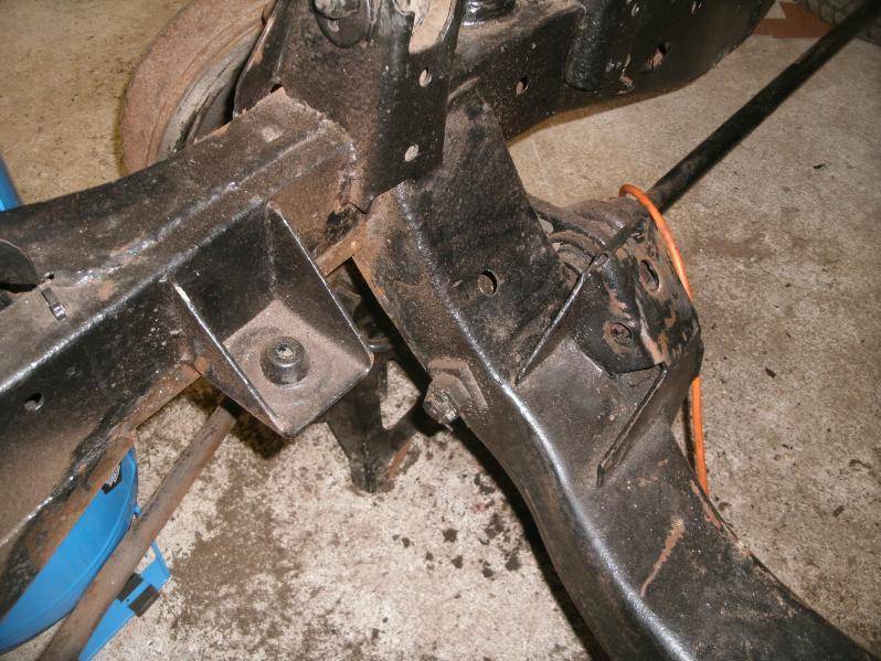

Nice NICE cleanup of the stub frame.
I try, it's getting a coat of paint soon.........literally a matter of hours.

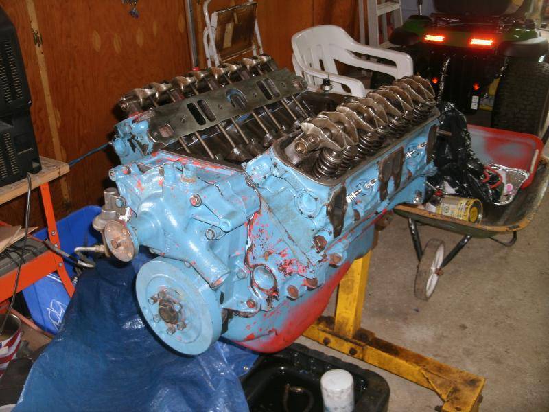

Anyway, Leaving shortly to go up, I figured out I have 4 weekends left this year, no matter how much I beg, plea, kick and scream thats how it is, so I'm stuck really.
I'll spend the winter doing some small stuff for the car. I can at least hunt parts and buy everything I need to attack the car in the spring, I'm actually now not sure about the cam I chose, I think I may have gone too aggressive.

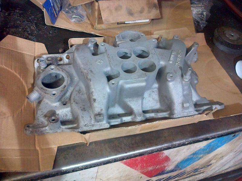

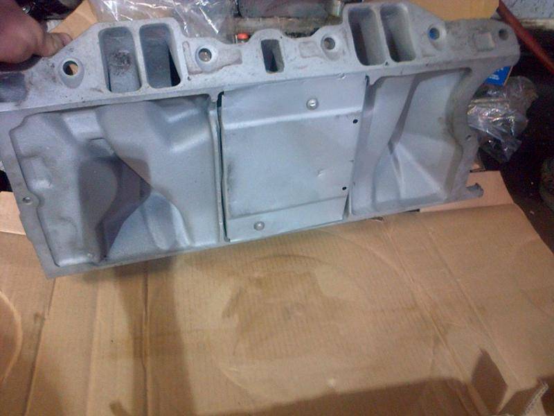

So I've tinkered. Got my intake back from being blasted. Pulled the rivets and cover to clean it out. Gave the bottom side a coat of paint to seal the cast. Girlfriends dad helped me get the rivets out, he also taught me how to fix the broken off bracket for the rad, and we managed to get the plugs out.

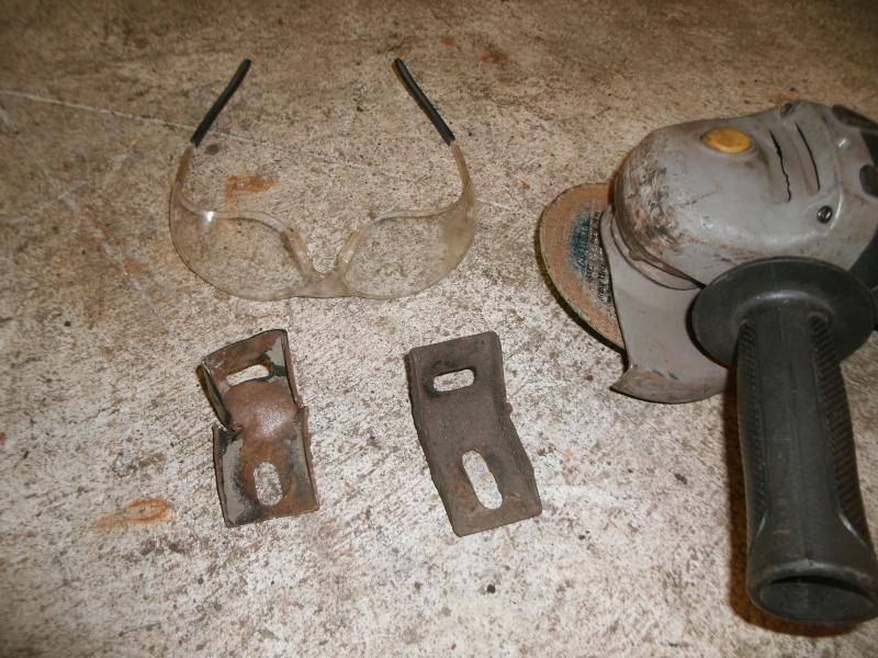

I cleaned a few things up and such. Removed a bracket someone welded on after breaking off a bolt.
10675728_10204547414342766_8452559801540385268_n.jpgGEDC0327.jpgGEDC0328.jpgGEDC0329.jpgGEDC0330.jpgGEDC0331.jpgGEDC0332.jpg10659390_10204547414382767_8590591771223471116_n.jpg
Turns out some one has gasket matched and polished the intake.

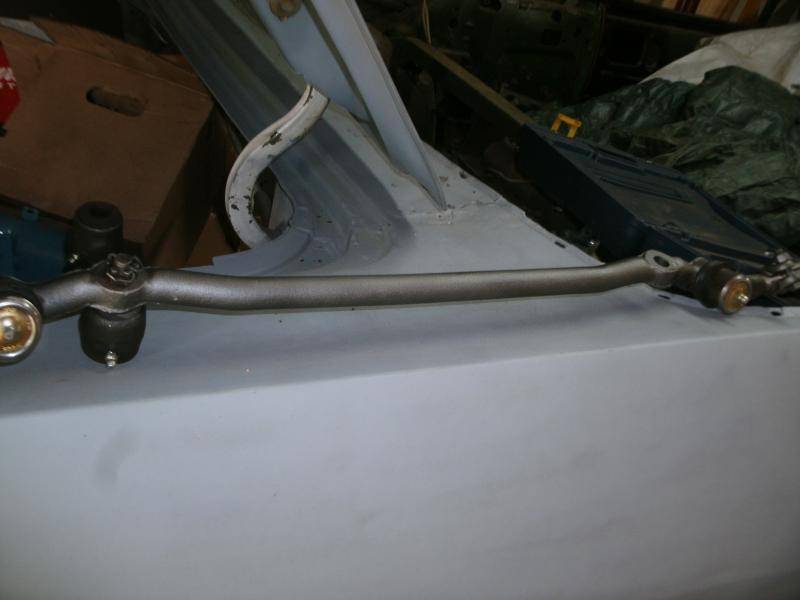

Learned from experience that two steps up on the torsion bars does wonders for the handling of a car, and I believe the same will apply to the front sway bar as well. So if you can find yourself a bar from a 383 or 440 car, I highly recommend swapping that in. You will be pleasantly impressed at the results.
