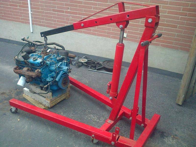

Today the 360 left my posession for good, it will become a 408 Stroker in the near future. The guys were quite nice and told me if there's anything I need, let them know because they would love to be able to help, "I don't mind helping out young guys like you, we need more guys your age, your not playing with honda's, you know whats good,if you need anything, you have my phone number, don't hesitate to call, you'll have to come see my Road Runners"

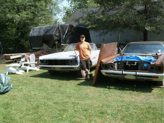

I spotted a '68 Fury sedan sitting in the bushes after we exited his building, he saved it from the crusher but only because he wanted original bolts for restoring his cars, it's a 318/727 car. I was told if I wanted anything off it just say the word.

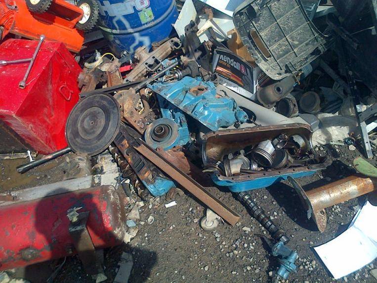

While I was there I saw the carnage that was the 360 after it was opened up and apart. Conn. rod bearings were toasted, it was crusty inside, water passages were plugged.
Today I stopped at the scrapyard and found everything I saw on the floor of his shop lastnight.

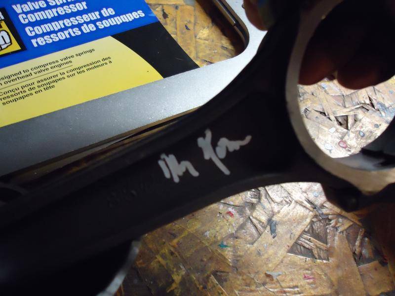

I also kept a piston, I decided to see if I could get someone to autograph it. He was more then happy too.

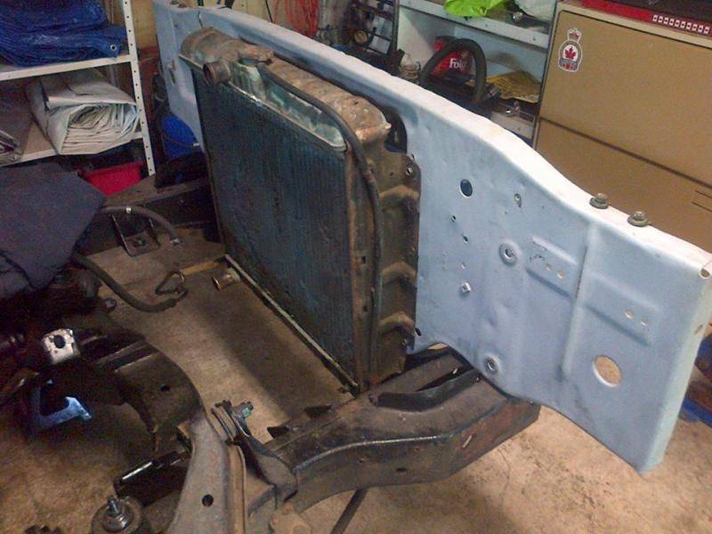

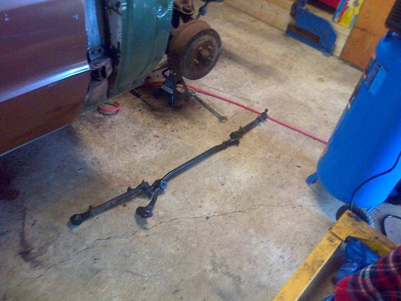

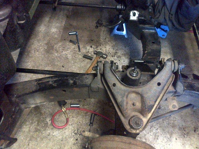

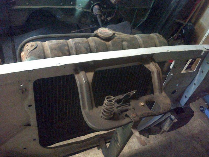

Well, I haven't been really talkative lately, took my girlfriend and my new best friend/playmate (She asked me if I was taking her dad on a playdate the other day) over to see the guy's car collection, and It was nice seeing him that "wowed". The next day (Friday) after I came back from pulling some parts from the '68 Fury he showed me some pictures he dug out of his Pursuit Package '75 Gran Fury, that was cool as hell. but I've also been picking away at things, clubbed the crap out of the tie-rods with the sledge till they popped (forgot my fork in my tool box at work) but there out, should have those new parts by the end of the week. Got my parts too, test fitted the rad, I'm gonna run a transmission cooler as well, just for safe measure. This weekend I'll do the steering, we'll put the 318 together, I'll paint it, then in it goes. I have new U-joints I'll do this week too, paint the driveshaft then thats done too. Next is Ball joints, control arm bushings, and strut rod bushings, then my spindle swap.
Very good. Just make sure you run from the transmission to the cooler to the rad and back to the trans and not the other way around.
attachment.php
Just me being paranoid, but if you could close up that gap at the bottom of the rad so that it fits better to the core support, your cooling will thank you.
I'm still playing with the fitment, Due to someone's messing around, I actaully can't run the trans cooler the way it should be. I have the one in my Cheyenne set up like that, but someone put two plugs in the bottom of this rad and even with heating I can't get them out.
