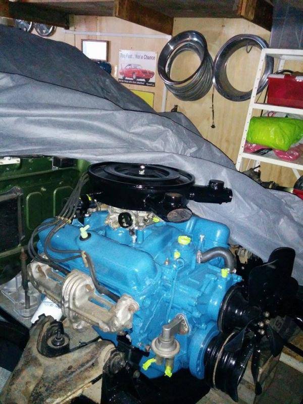

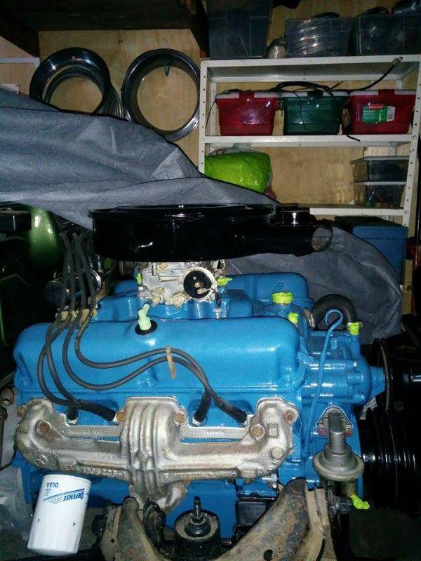

The Engine on my 69 Fury III Convertible is Red. However, 69FuryIIIConvertible has done a nice job on the engine paint and Turquoise was available in 1969. Seems to me that I read somewhere that 318's built in Canada were painted in Turquoise, but I could be wrong on that. My 69 will be undergoing a body off restoration. I will be modifying the 318 and upgrading the internals of the transmission and rear end, but the engine will remain red.
This is what I found searching the Web on Mopar Engine Colors for 1969.
1969225 SixAllRedMopar Paint P4349218
1969273 V8 - LAAllRedMopar Paint P4349218
1969318 V8 - LAAllRedMopar Paint P4349218
1969318 V8 - LA - Police onlyPolice engineH-OrangeMopar Paint P4349216
1969340 V8 - LA - See Note belowAllRedMopar Paint P4349218
1969383 V8AllTurquoiseMopar Paint P4120752
1969383 V8 High Perf/PoliceHigh PerfH-OrangeMopar Paint P4349216
1969426 HEMIStreet EngineH-OrangeMopar Paint P4349216
1969440 V8AllTurquoiseMopar Paint P4120752
1969440 V8 High Perf/PoliceHigh PerfH-OrangeMopar Paint P4349216
I believe all of your work has produced the correct results for a U.S. built engine. The Windsor Engine Plant was it's own animal and did things their own way. I think you're both correct.

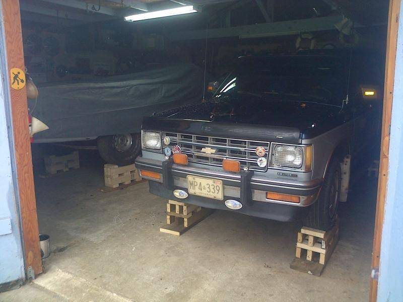

Well, I'm done for the season guys.............[iurl="http://www.forcbodiesonly.com/mopar-forum/attachment.php?attachmentid=40174&d=1413861589&d=1413861589"]
attachment.php
[/iurl][iurl="http://www.forcbodiesonly.com/mopar-forum/attachment.php?attachmentid=40175&d=1413861591&d=1413861591"]
attachment.php
[/iurl]
I would say this has been a most memorable season for ya, Nick.
Keep us up on your post season antics :D
Posted via Topify on Android
Ironically, last night it was warmer in Whitby than it was down here in the `banana belt'. So, it's all relative.
My car is 2.5 hours north east of me. I wish it were closer, but thats how it goes.

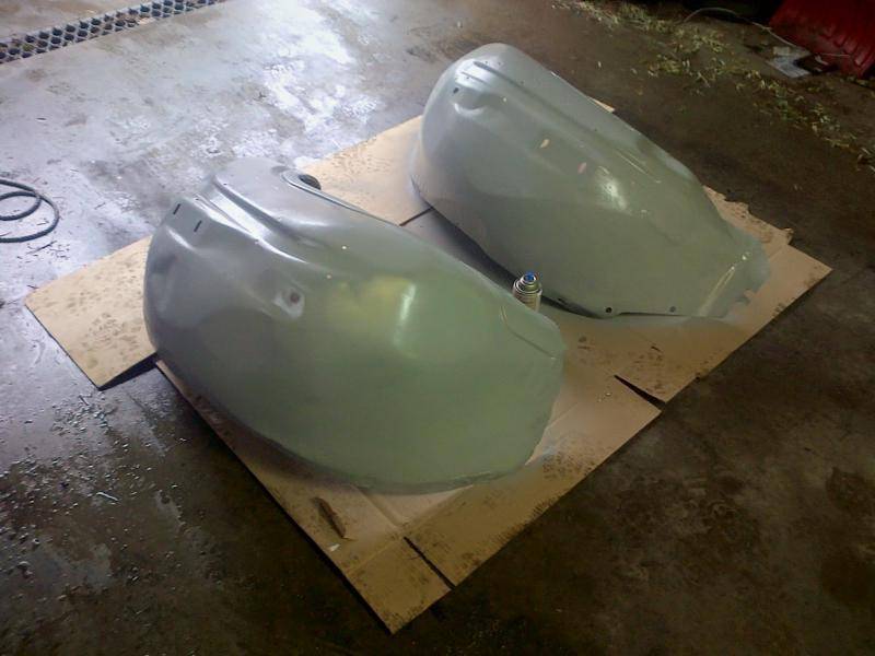

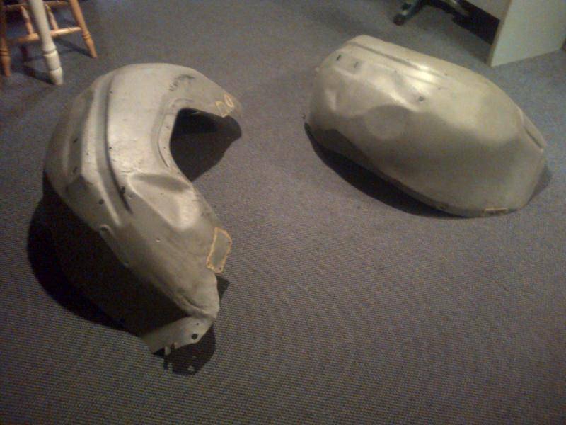

I can do that. My inner fenders are being sandblasted as we speak.
Nick

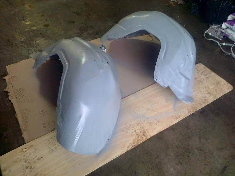

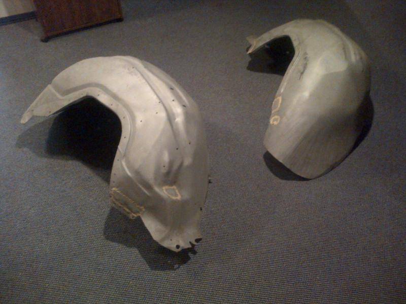

Well since we spoke last, I have collected a **** ton of parts, A second job (thank to my girlfriend and her mom) and a nasty thought that I need another C body in my life, this time with a Big Block and two more doors.

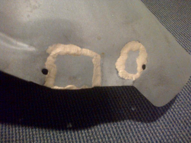

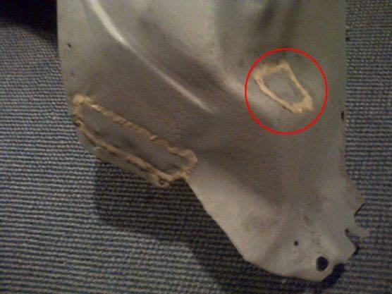

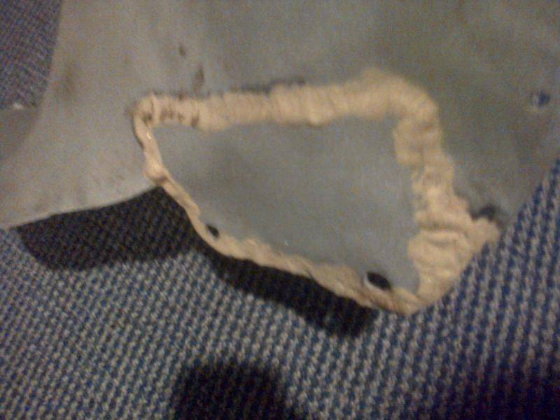

Got the inner fenders back from being sandblasted. Found some old repairs I didn't know existed in them, one will have to be cut out and replaced (they decided to patch over the rust, naturally the rust ate through both)

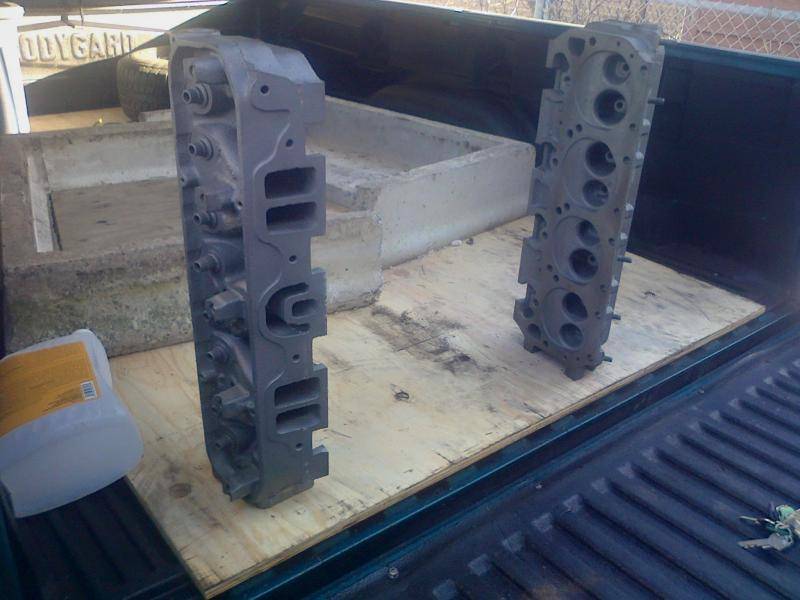

Anyway.......Pictures......also some pictures of what I picked up on Saturdays, some 906 440 heads..........$75 already Mag tested and sand blasted, my machinist says they need one valve guide (cracked) and two seats re-cut. For my next toy.............140 MPH Speedo should show up this week too....also for my next toy........Nearly bought a radar gun for it too............my girlfriend should have never shown me EBay and told me she had paypal I could use.

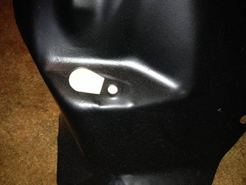

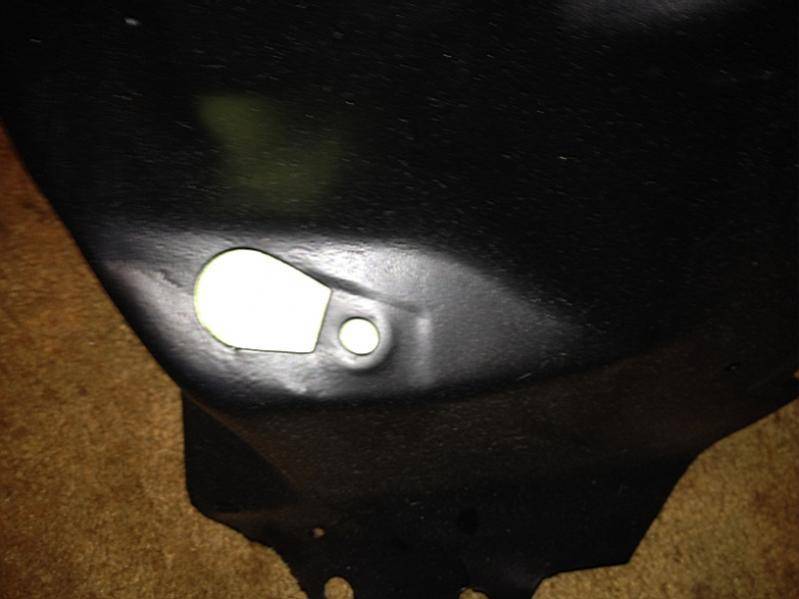

This patch should be a hole to drain the battery tray.
Alan
Do you have a photo of how it should look? I might as well fix it.

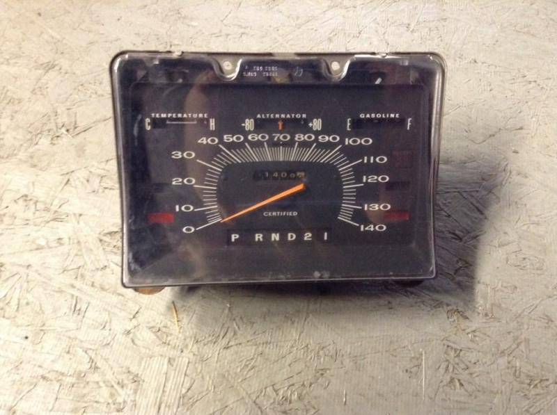

X2, glad all is well Nick. Lets see the new speedo! What kind of 4 dr are ya looking for?
I'm looking at a '73 Fury sedan, 318 car at the moment. But I'd like it to be a 440 car.
anyway, Ebay picture. Came from a NYSP '72 Fury

Here are a couple, the smaller hole is for the bolt, the flat spot on the large hole is to put the c-clip on the small hole.
Alan
Alan
Thank you!

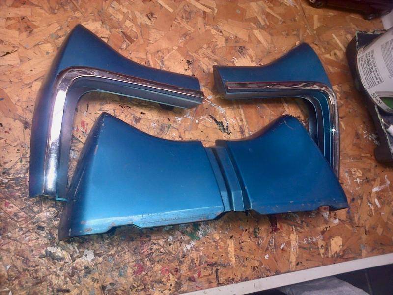

I like those chrome moldings on the front extensions. Nice touch. My 69 wagon doesn't have them. I might need to locate a pair for him.
