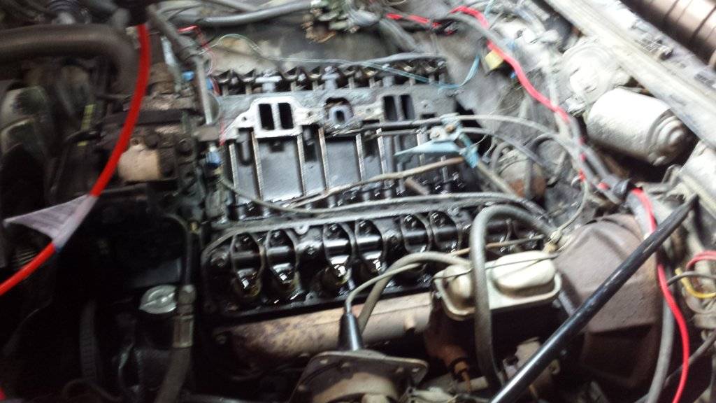

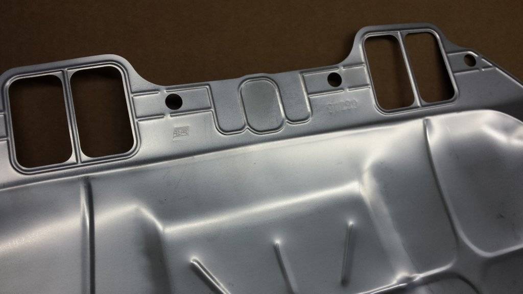

when it gets hot in traffic the carb hesitates from the heat so I put on a valley pan with the heat block of and flush the rad and a new 180 thermostat...ready now for next year. done this lots of times and works awesome

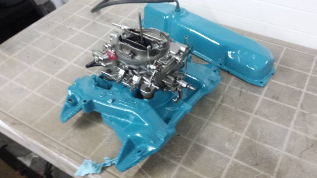

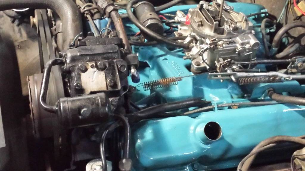

Engine paint looks good.

I ran those Fel-Pro valley pans with the heat block offs in them. A word of warning: those plates will blow out.
During an engine teardown I found that the driver's side heat passage plate had blown out of the intake. I found it bent almost in half and shoved way down inside the left turbo. It was barely rubbing on the turbine wheel. It essentially plugged the exhaust and lead to a loss of power and blown head gasket.
That stinkin valley pan cost me a lot of money and time.
I now run Eddy heads and don't worry about the port that isn't there. :)
Yup those thin gaskets will blow out under 100km. Use thin stainless steel sheet as support. Those last a lot longer.
