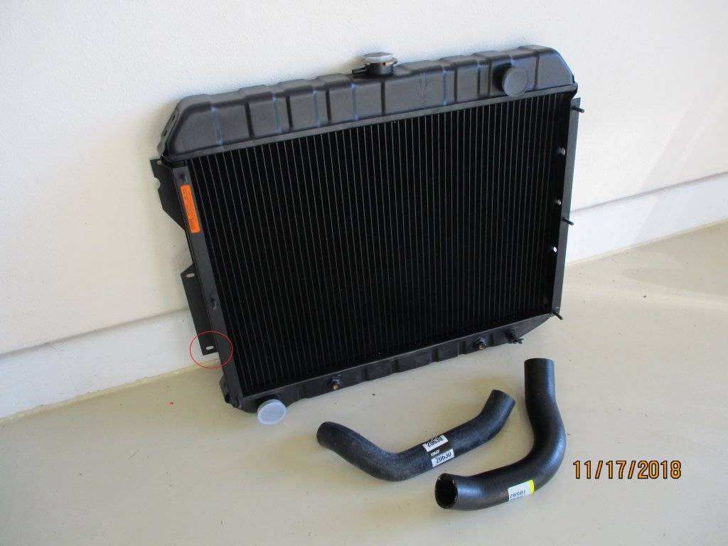

I had outstanding results with my "332" radiator as I've discussed here years ago. And other than the absence of the OEM part number and info stampings on the top tank, it looks entirely stock, unlike the very ugly aluminum units. My TNT would run between 190 and 200 depending on the weather, which are proper operating temps. I've noticed that guys install 160* or 185* 'stats and then expect the engine to run at that particular temp. Good luck with that, because that's not what a thermostat is for. The intent is that the engine won't run too cold in freezing weather and will warm up quicker by recirculating the coolant until that 'stat opens. And remember that the cooling system is pressurized. If you're using a 16 psi cap, that raises the boiling point to approximately 250*F, so if you're running it hard on a hot day, 225* is not out of line. Mine would do that and then return to 195 or so when I returned to driving like an adult.
This pic shows the lower holes that needed a slight mod to open the bottoms so that the rad slips onto the bolts loosely installed in the core support, but otherwise the fit and finish was perfect. The original shroud nicely aligned the the six mounting studs, btw.
Also, I installed a brand new Chrysler approved repro clutch from Tony's Parts. Store - All Reproduction Parts | Tonys Parts
could you give us the part # for the hoses and which one is upper and bottom thank you.
I simply went to RockAuto and clicked on standard quality hoses, the radiator, etc. for a 1970 300. No big deal.
Gates 20630 Upper
Dayco 70592 Lower
I see that the Dayco is no longer listed with them. Now it's a Continental 60659.
