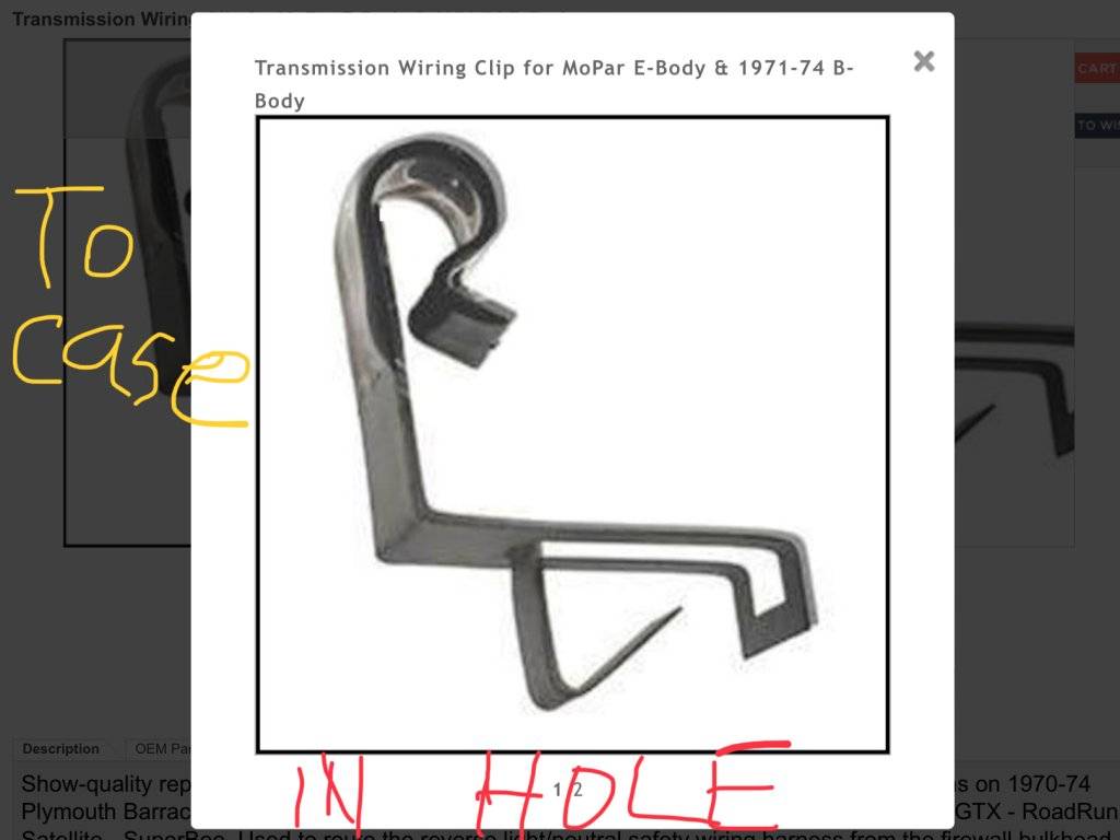

Can anyone provide a picture of how this clip attaches to the transmission?
Clip...
The drawing doesn't provide enough detail. I removed it on my transmission to clean and don't know how to reattach it.
Thanks!

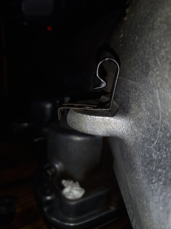

it goes in the ear with a hole in it sticking out the side of the bellhousing. There ar 4 total on the trans.
The stand up part faces the case, the tab facing down goes into the hole.
Click on your link with a phone or tablet....you can zoom right in and see it clearly.
