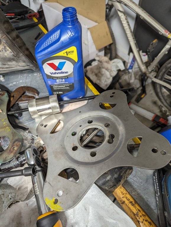

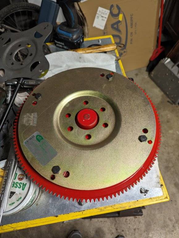

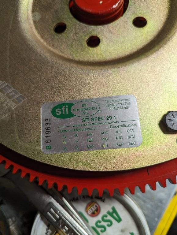

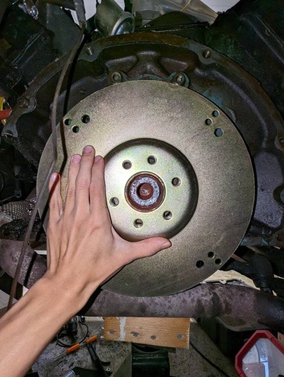

I managed to get another Flexplate that substantially looks more beefier than the stock/silver aftermarket Flexplate.
It's SFI 29.1 rated for 3 years, let's be honest, not that I have any intention on replacing the flex plate after 3 years.
FYI: Just mocking the Flexplate into place, it will come back off when it gets bolted to the crankshaft first!
I was holding my breath on weather the Flexplate bolts holes were going to lineup with the crank bolt holes, no problem here!
That looks great! Much better choice!

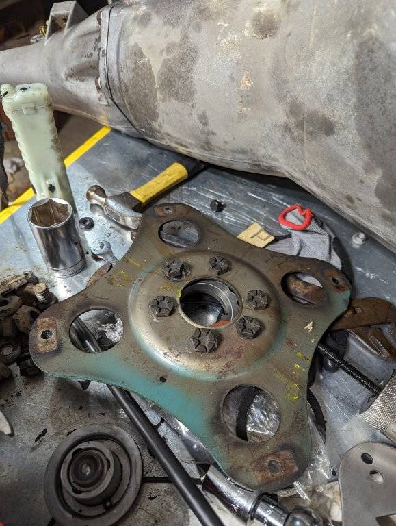

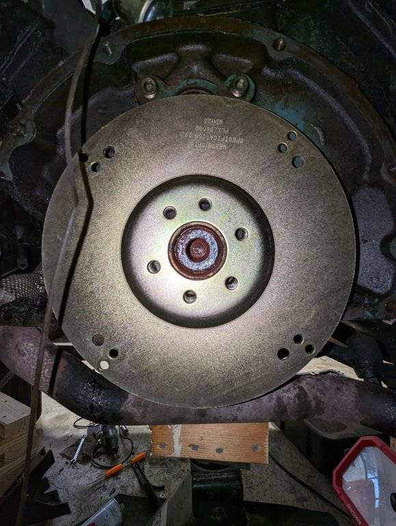

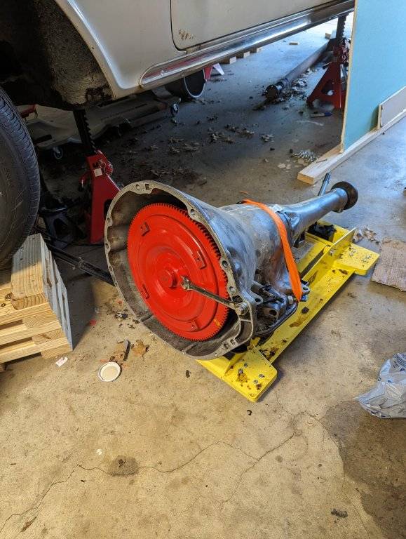

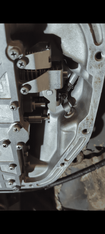

So a few days passed, I have got the valve body rooster comb detent gear selector adjusted, the engine cranks only in Neutral/park. and doesn't crank in any gears.
I've confirmed and marked the offset Torque converter/Flexplate bolt holes ahead of time to ensure everything is all lined up when the transmission is tucked under the transmission tunnel.

The gear selection is in Neutral and the Rooster comb "finger" is centered on the neutral safety switch.

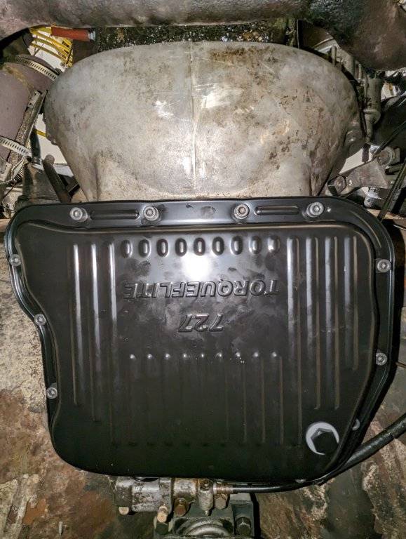

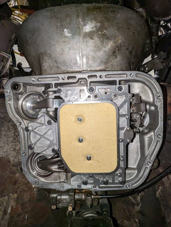

The filter/valve body before putting the pan on

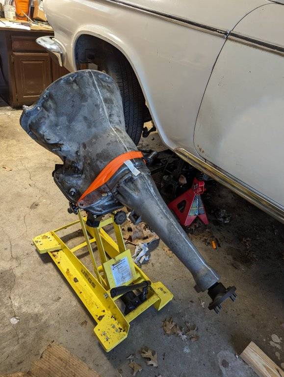

Transmission on the jack, ready to be installed.

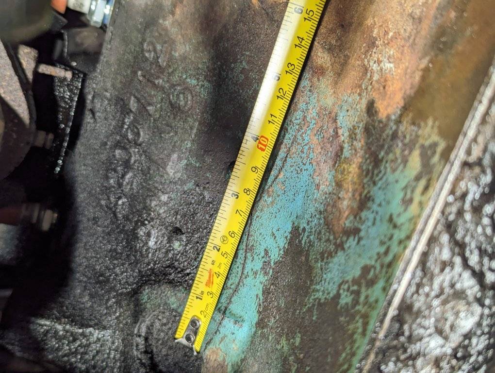

The crack in the block... That's for another day to tackle that job/fix.

When you get it put back together, fill it with water and drive it around the neighborhood, get it warmed up, and see if that crack leaks, it might not leak all the time?
You know that's the thing, I only discovered the crack after I wiped some of the surface grease off of the block.
May have been cracked all this time when I was daily driving and I was non the wiser.
Metals expand with heat. If it's 'one piece', it expands outward in all directions.
But with a split in it, it still expands outward. So the material on both sides of the crack seemingly would be expanding toward each other, to try to close it.
But the block is also expanding to become taller/longer.
So only reality will tell us.
I also wonder if you drilled a 1/32 hole at the end of the crack (to stop its progression) if there is some new space-age goo that could seal up the crack.
Somethign akin to driveway crack sealer but chemical-resistant and flexes with heat.
Might be a easier to attempt this than the lock-stitch, which will be time-consuming.

If you run it without fixing it, it will likely grow. You always drill holes at the ends of the crack to stop it from growing.
Agreed, going to clean up the block a bit more as right now the crack looks like it has spread to the other core plug, albeit a hairline crack.
Drill holes, As in drill at the end of the crack as in drilling through to the other side of the water jacket?
Just asking for clarification.
