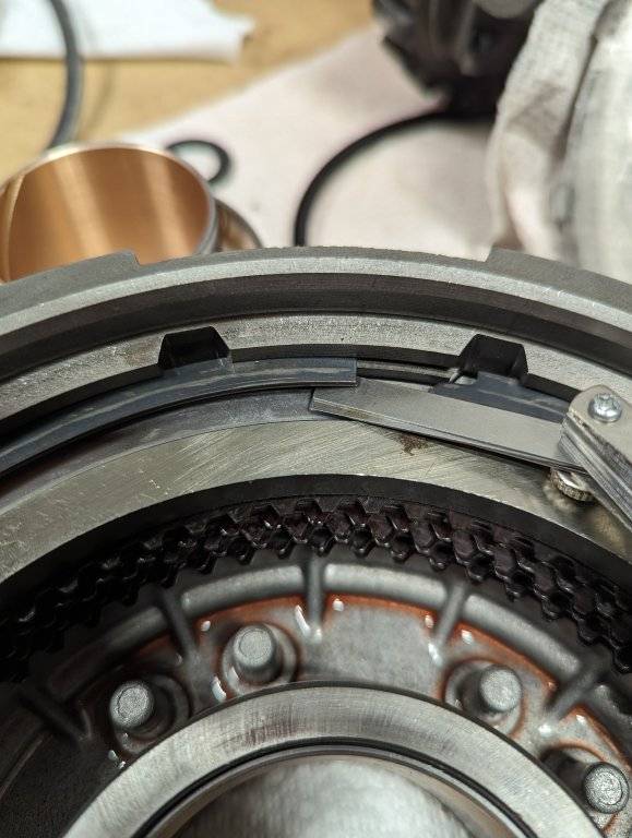

I managed to fit 6 friction discs on the front clutch drum,

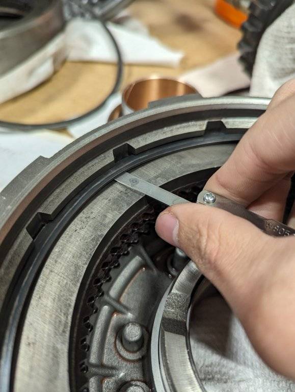

Here's the conundrum I'm currently in.

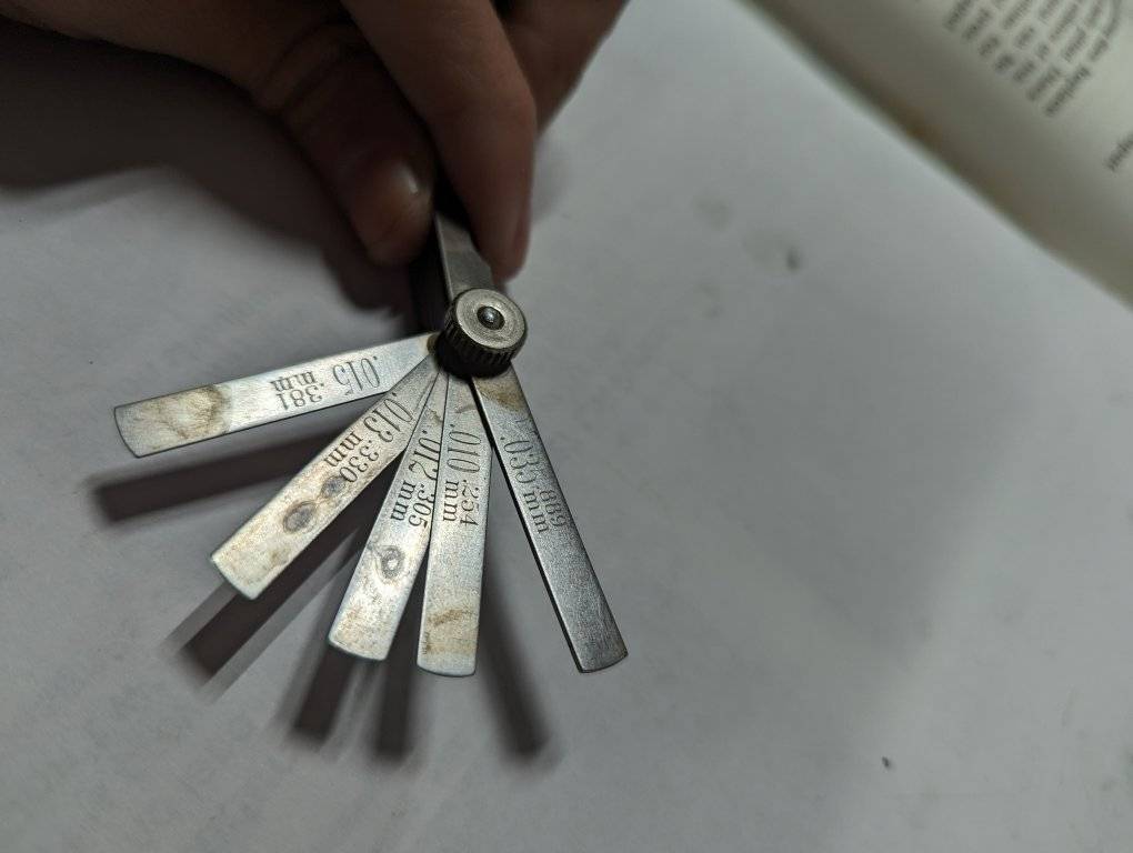

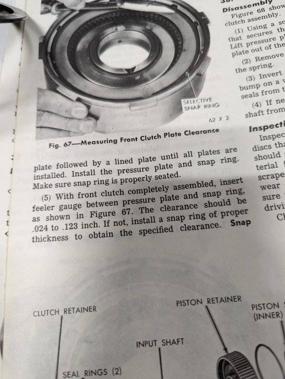

The manual calls for .024 to .123 between the top pressure plate and between the snap ring.

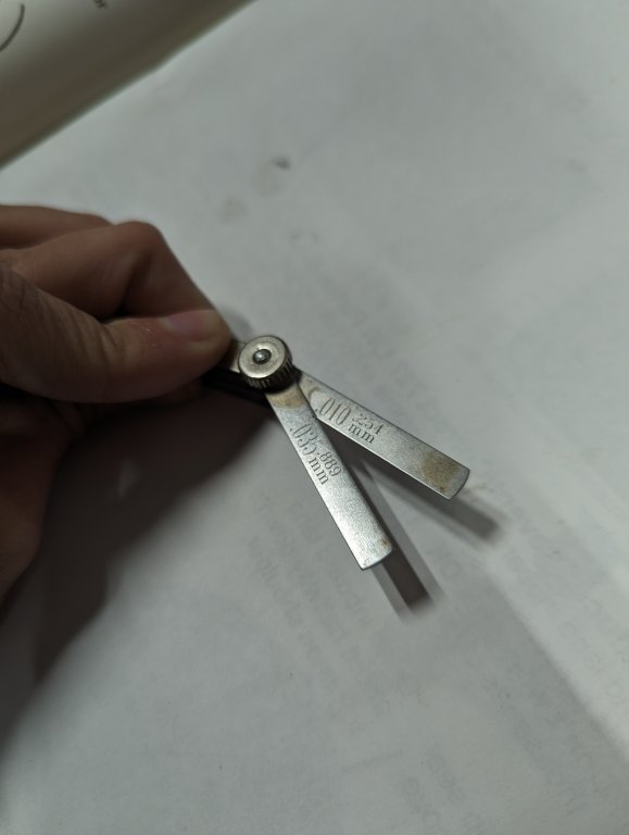

I've got a .045 to get a snug fit.
But I've also got a machined pressure plate that allows extra clearances to be made.
I've read around and the consensus is .012 to .015 per clutch.
That brings me to around .090 clearance, is that right?? Awfully seems sloppy with a big clearance like that.
Currently there's X6 .064 clutches.
There are X 5 .068 kolene steels in place
Any clearance's that you have run with in your A727 would be much appreciated.
Will edit the post if necessary.
If I swap to the machined pressure plate, there's a lot of clearance, I'd assume .140 or so. But if my measuring is to be believed, it's about .073 clearance, measuring the clearance is difficult at the angle I need to measure the snap ring clearance at.
If I swap back to the stock pressure plate, the snap rings that fit are snug .045
Now I suppose I can get different clutches/steels, but if I do that, I can run only 5 clutches.
Thanks for your input.

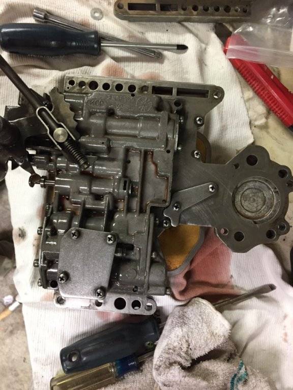

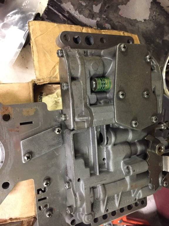

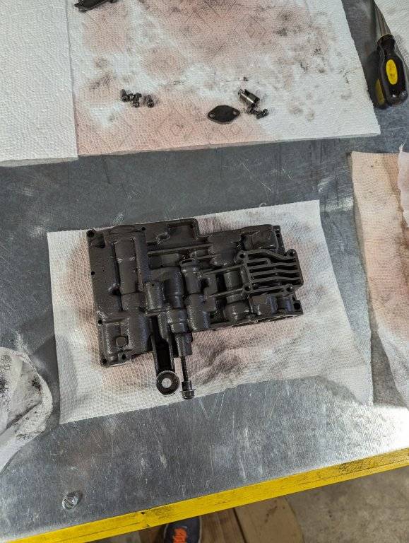

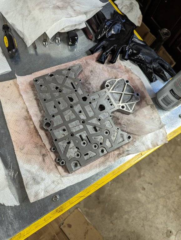

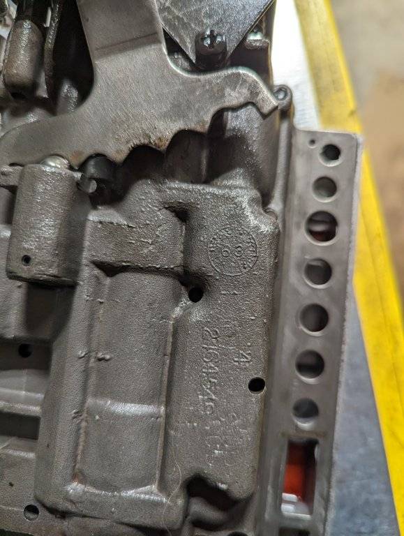

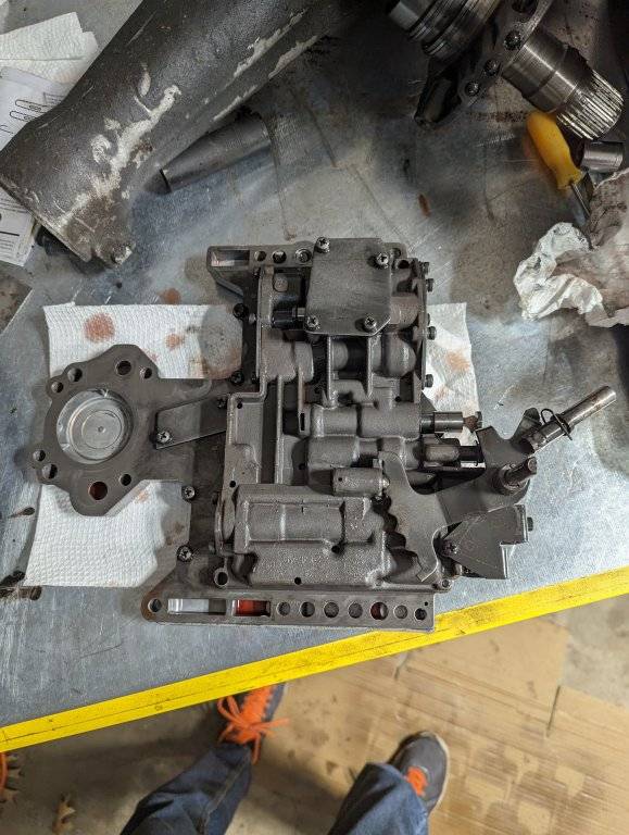

I just got around to disassembling the valve body, reassembled with the TransGo TF-1/TF-2 in place with the "B, C" separator plate 1-2 shift, 2-3 shift holes drilled to .125 (1/8)
Reassembled, now waiting on the bands to arrive for transmission assembly!

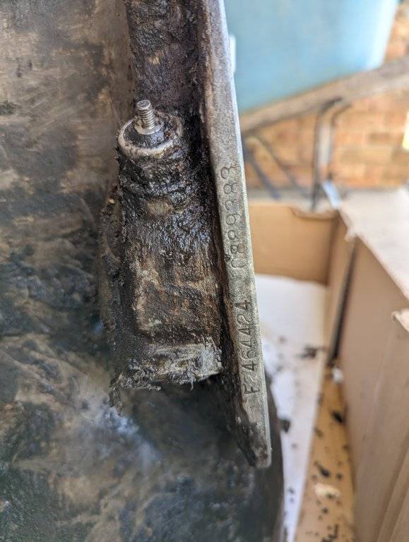

Cool thing to note both aluminum & Zinc castings had a 63' marked on it.
With the DPCD, and the forward look mark stamped on them

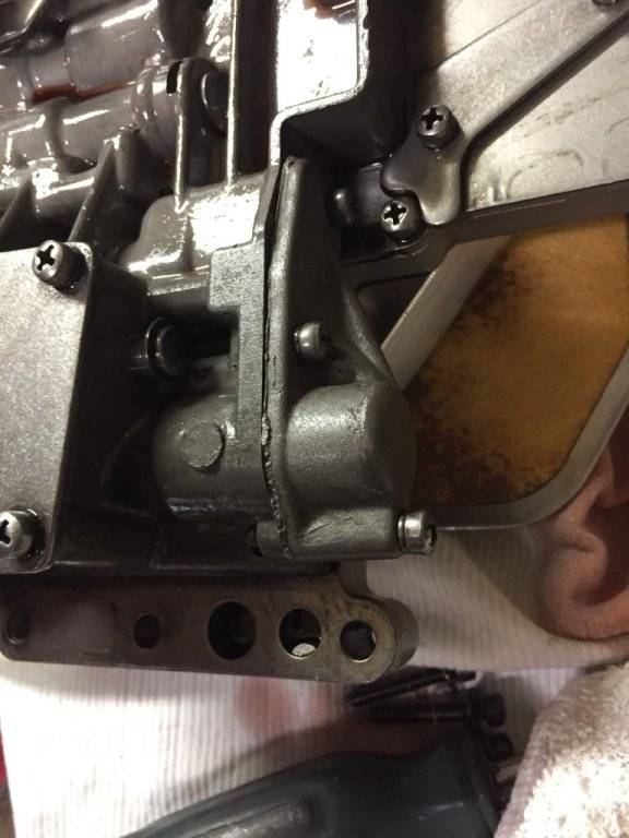

no external mods needed, just your stock kick down linkage properly adjusted.
Much Appreciated, I'll consider getting one to strap on.
How did you like the performance of the part throttle kickdown after modification?
I suppose the merits are not lugging the engine at low speed with throttle near 65% open.
It's great for an easy pass when you don't have to hit the floor to get it to kick down for a little increase.
So I've just got in touch with Pat Blais from eBay, he mentioned I need a 68' valve body casting to make the PTK work. Kind of unfortunate, but I'll focus on the transmission re-assembly and maybe touch base on the PTK kit at a later date.

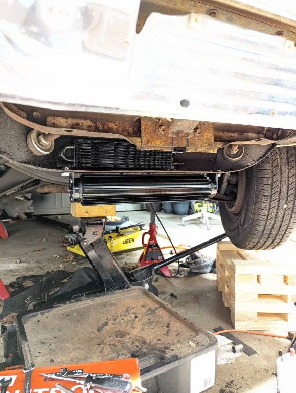

Just a few things I decided to add before the transmission gets buttoned up and ready to put back into the barge.
I suppose this may be considered "butcherd"
But I decided to run an auxiliary Transmission cooler, while I was at it I added a power steering cooler also.
I'm aware that some factory Chrysler Newports (1970?) Had a power steering cooler, but finding one (even in good condition) seems like a needle in a hay stack.
So I'm going with a Fin/tube style witch is for the power steering, it's not smashed against the frame as the picture suggests but spaced away slightly from the frame.
The lower one secured to the frame is a heat sink style, that is for the transmission.
Routing the transmission cooler lines will be:
Transmission -> radiator -> Auxiliary cooler -> Transmission.
The astute observer will notice there is no in-line Thermostat to control the ATF fluid temperature on whether it will by pass the cooler or not.
The temps in Texas is a constant blaze, and the temperature emanating from the bell housing,
(When the transmission was operating few weeks back) even in winter months it's still hot, I think I'll be fine without a Thermostat, but time will tell, if not, I'll add a Thermostat in-line.

Your location of the cooler is asking for trouble, road debis, curb at the drive in, etc...
Yes, I considered as much, I'll re-adjust to a different location I have in mind.
I considered the area just behind the front bumper,
in front of the radiator,
but some of those locations I had in mind for something else...
More on later!

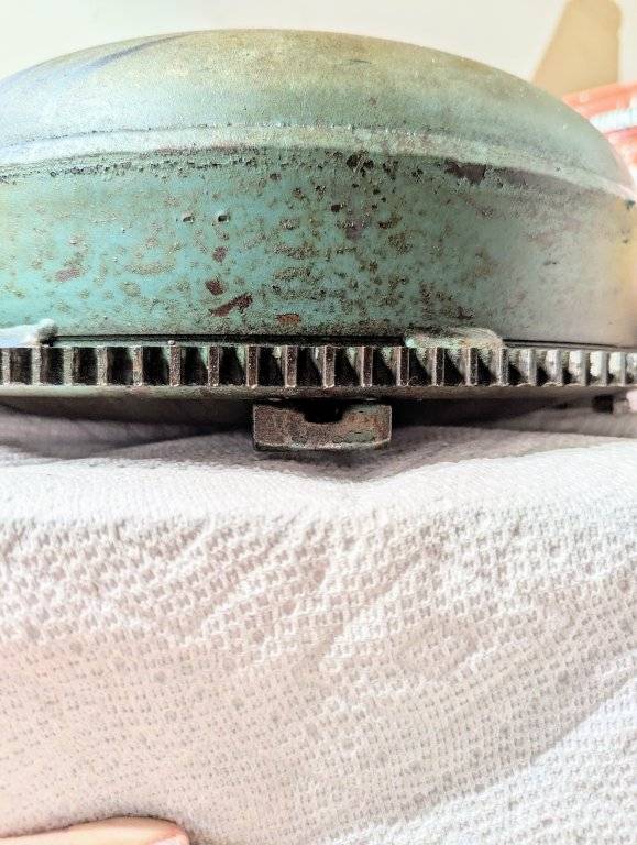

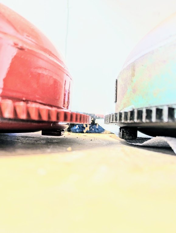

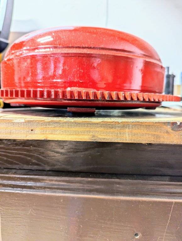

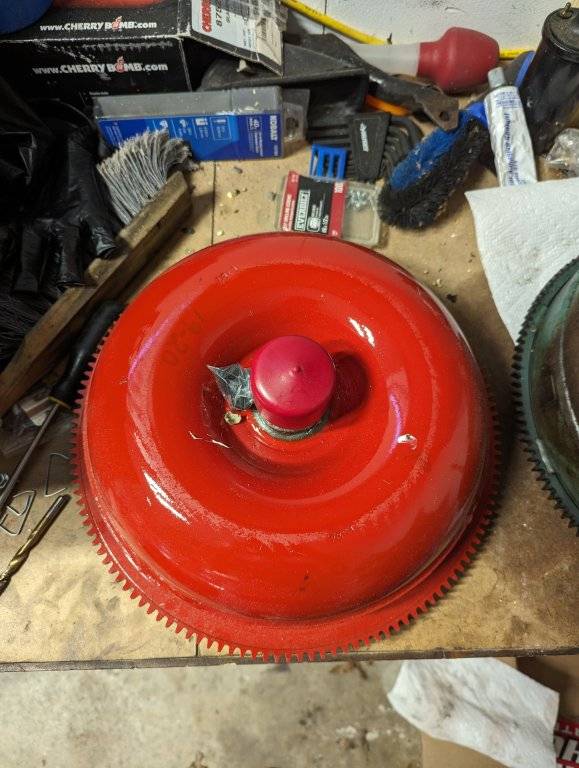

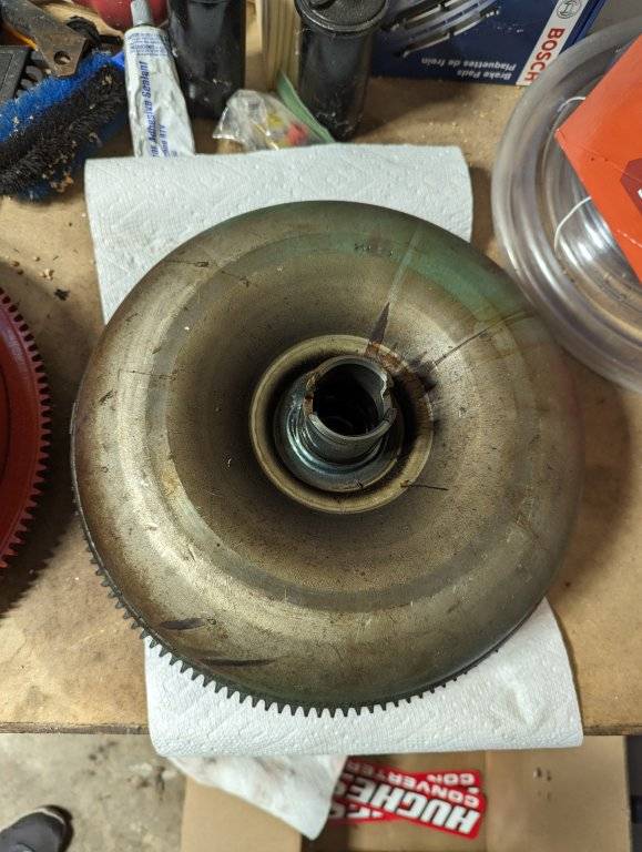

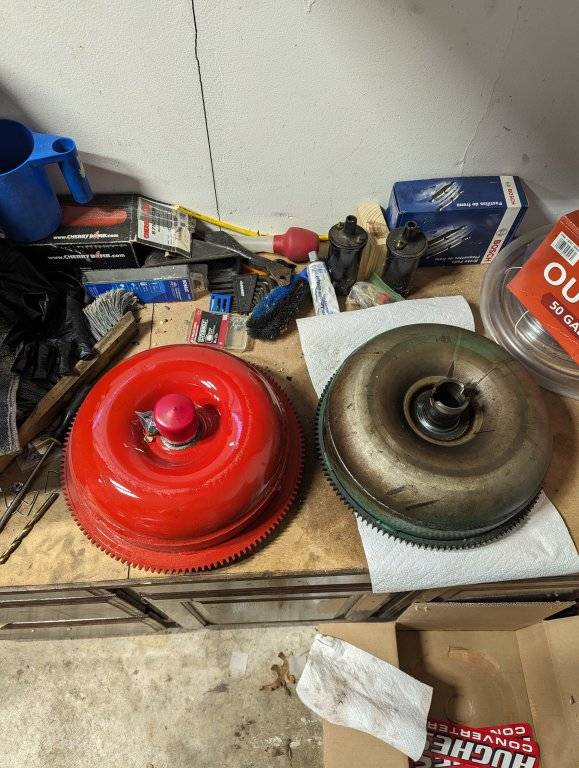

New Torque converter has arrived!
Comparison of the old/new.
New looks slightly smaller.
I can surmise the old converter is maybe a 1750/1900 stall?
New is Hughes performance Torque converters part number #19-20. 1900/2000 stall.
The flex plate mounting areas looks to be at the same height?? So I can reuse the flex plate if able.
Picture brightness has been modified to be able to see the underside of the mounting areas better.
It's in red so maximum HP numbers! XD
Original in Cyan for maximum patina XD
You're gonna need a different flex plate.
Smaller convertor has smaller bolt circle.
Check the bolt size too... Some performance convertors used a larger bolt. Actually they use the same bolts that attach the flex plate to the crank.
So I presume, to get a new flexplate.
you need to measure the new converter bolt circle size and go from there?
