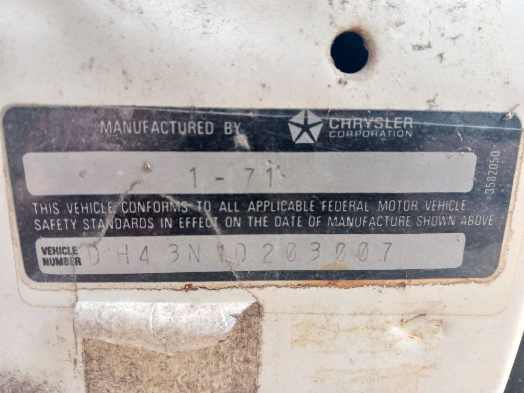

I thought you folks might be interested to see the door sticker. There is a large Ziploc bag in the glove box with service records for the car. Those should be interesting to look through. I was kind of surprised there wasn't a window sticker included with the car.
Thank you guys for all of the good information.

I think it's fair to expect to find at least some N codes from that time. Page 61 of the 10/69 Order Guide lists E63 383-4bbl as being available as an option.

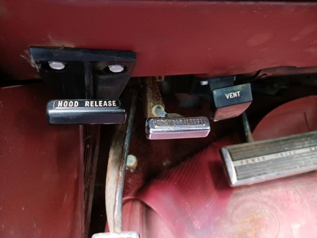

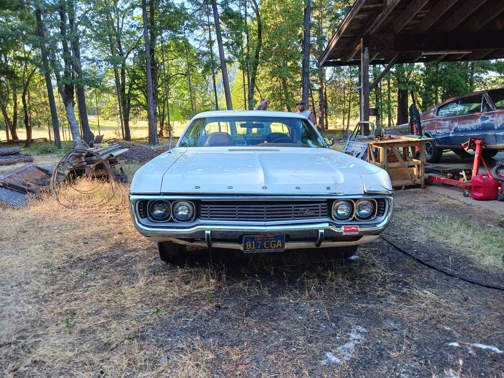

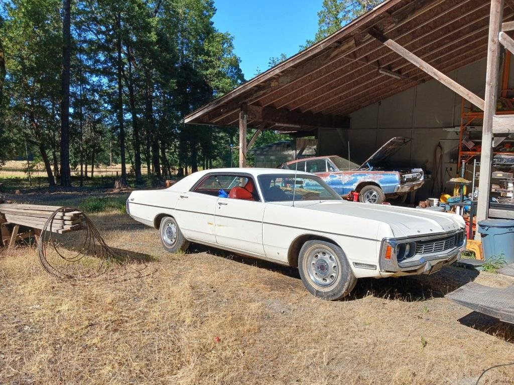

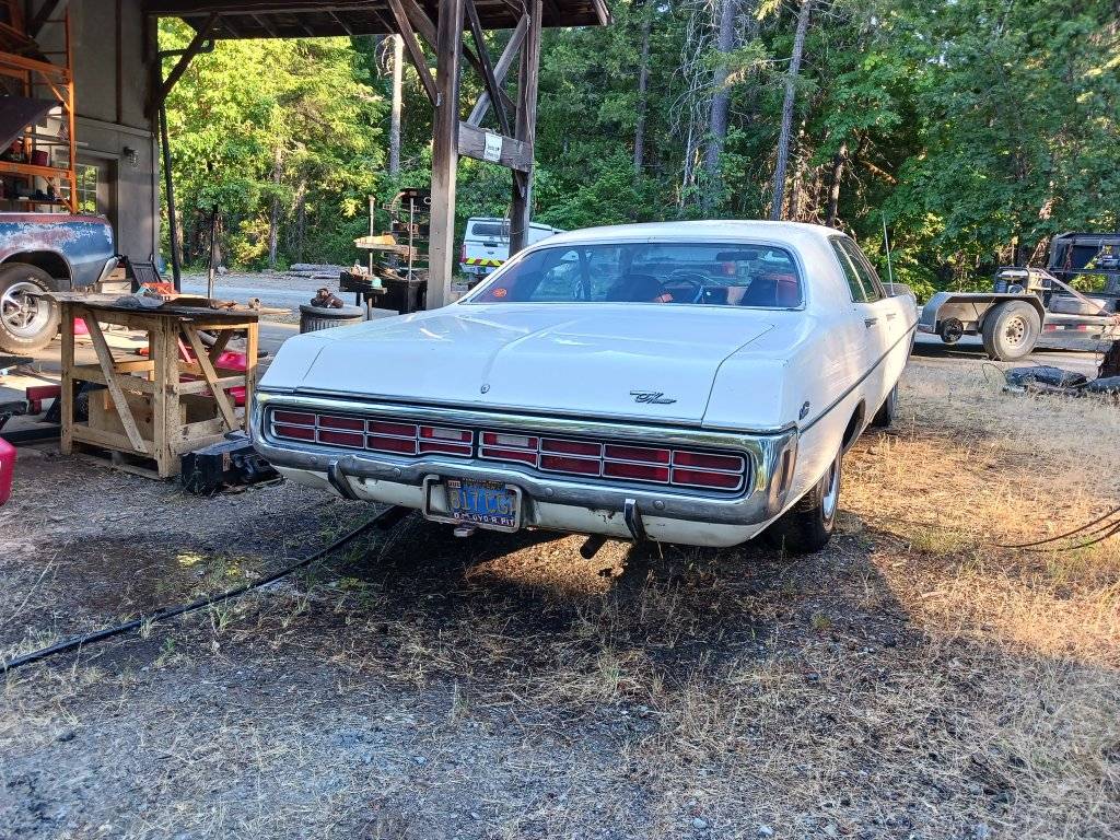

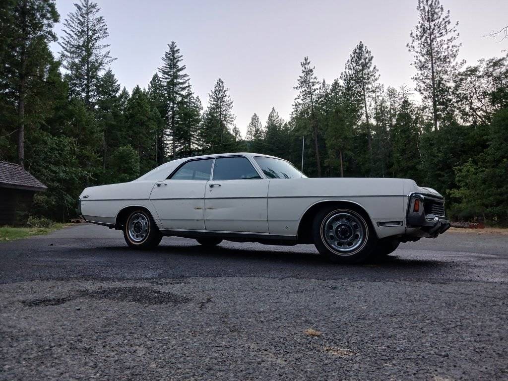

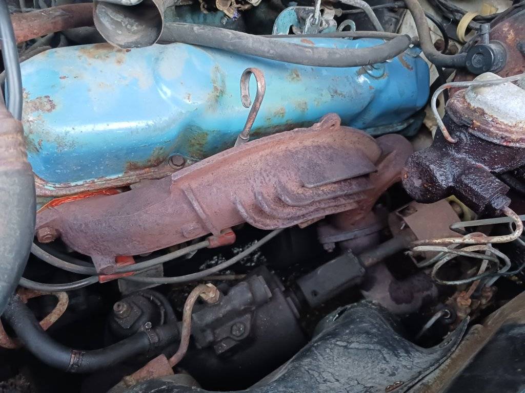

A friend of mine that runs a tow company brought this to me. It was found in a barn outside of Mt Shasta, CA. It has 64k miles and runs aside from a cracked driver side exhaust manifold.
In my opinion it has an odd combination of options:

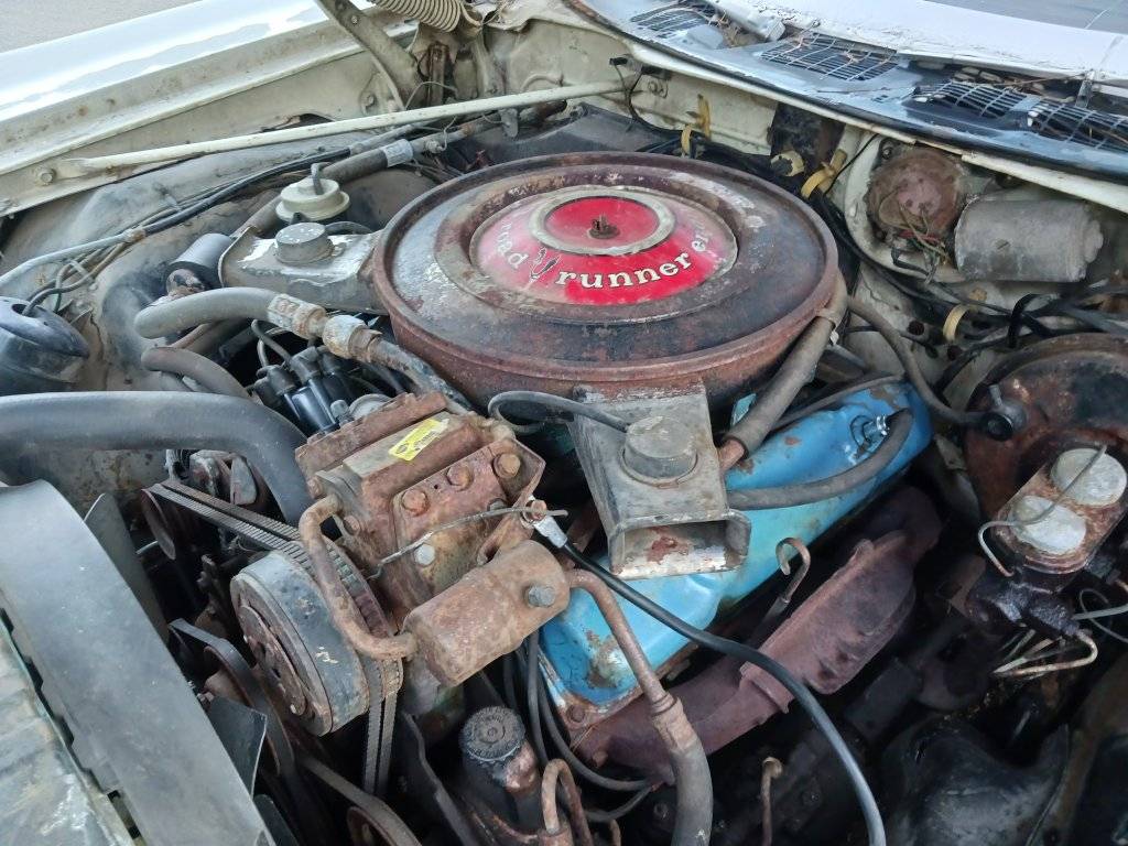

383-4bbl, N code
A/C

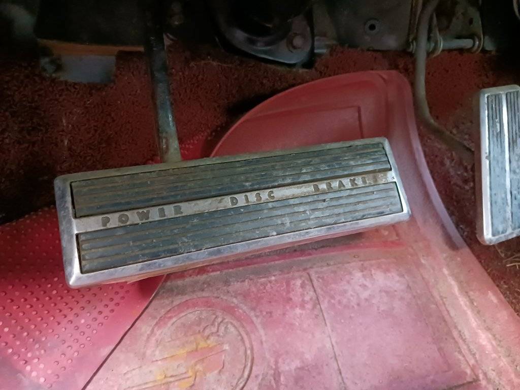

PDB
Remote hood release

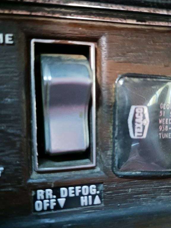

Rear defog
Rear speaker with fader
No power anything in the cab (windows/locks/seat) gives it a bit of police car vibe along with the alpine white exterior.
Hopefully it has a 3.23 suregrip!

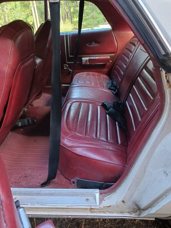

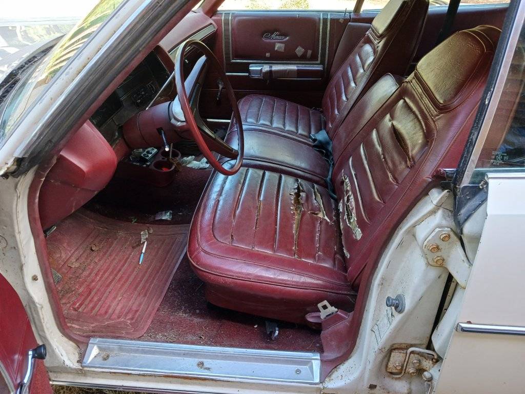

Wow what a nice find! Love the red interior!

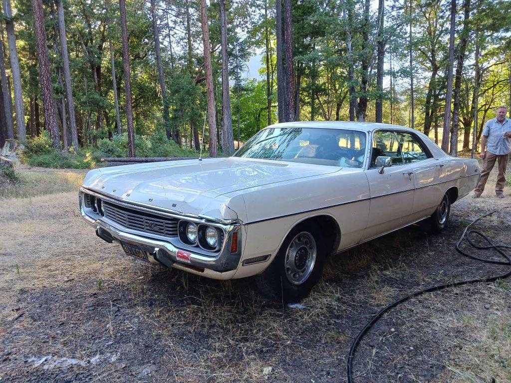

We have located an exhaust manifold! Hopefully we can tackle that project over the weekend.

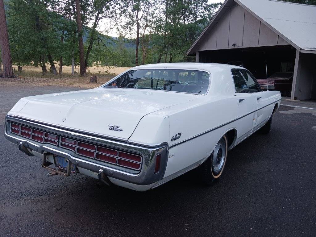

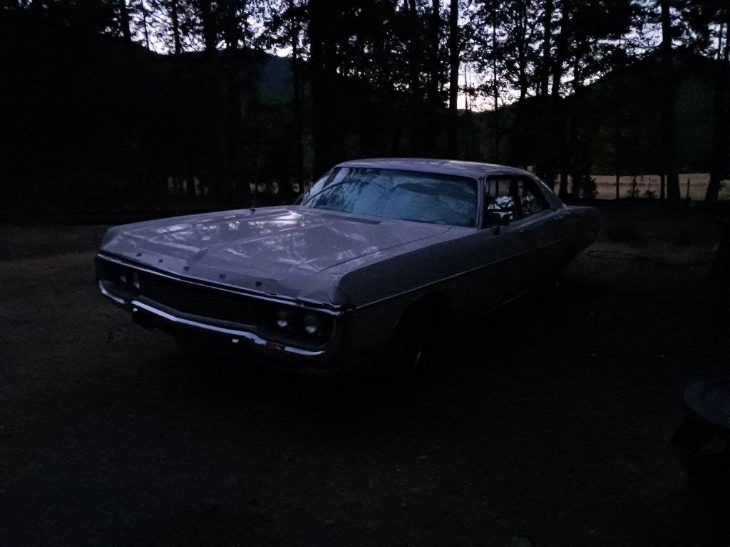

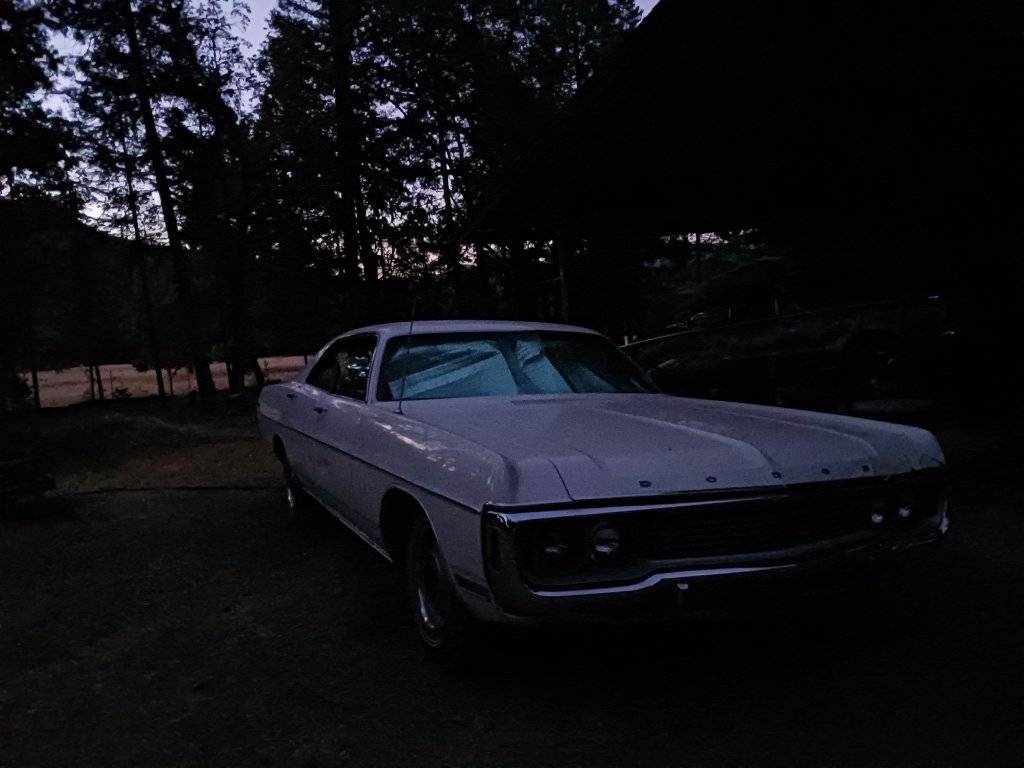

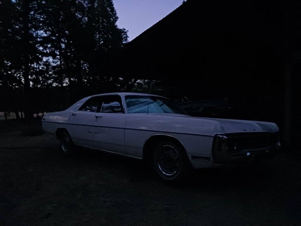

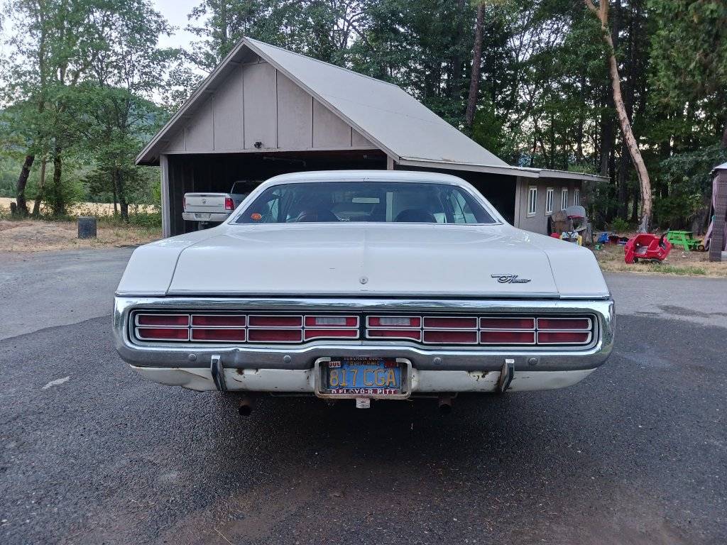

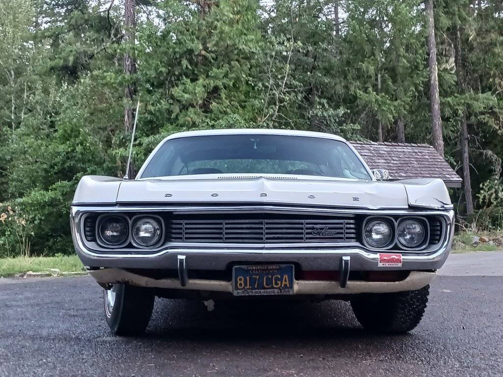

A few twilight glamour shots you might enjoy:
Manifold is installed! We made our maiden voyage around the ranch without incident.

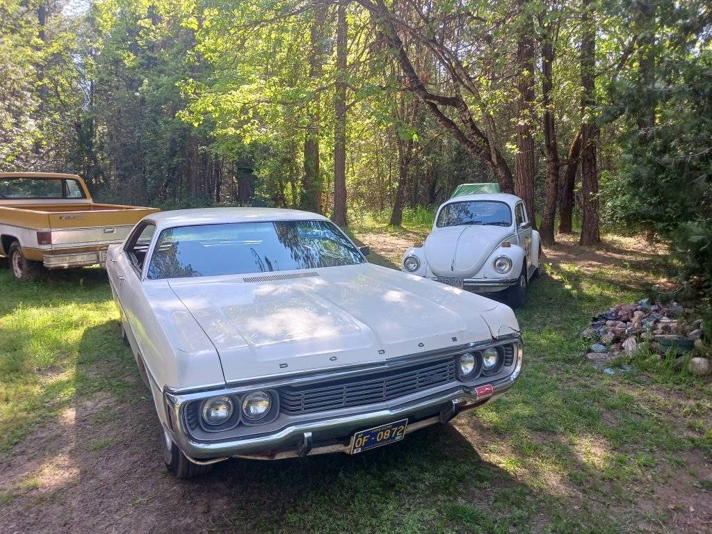

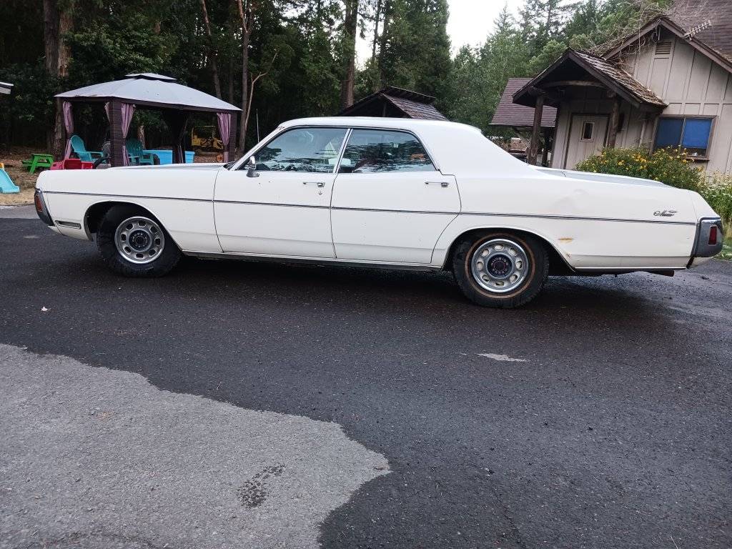

We are making progress!
Since the last update I found a owner-driver for this car. A good friend that is retired said "let's do it" and off we went.
That development predicated a large Summit Racing order for everything needed right down to the carb cleaner and motor oil. With the prices at the parts houses
through the roof it is easier for the stuff to come to me. I was also fortunate enough to score a 10% Summit code to help out my friend.
Here is a list of work I performed:
Tires replaced
Brakes serviced
Carb rebuild
Spark plugs/wires/pertronix
Transmission service
Lube-oil-filter
Replace water pump
Replace acc drive belts
Replace radiator, 1 cooler line
Service brake system
Replace headlights
Lubricate all hinges
Replace mufflers
Replace inner/outter tie rods
Replace idler arm
Check alignment, correct toe
Clean fuel lines, r'n'r rubber
Remove gas tank for cleaning
Repair gas tank sending unit
Replace fuel pump/filter
Repaired broken sway bar link
So far, the car runs great with a few exceptions. The major issue I am having is with the front brake calipers.
I have been exploring options to either rebuild or replace the calipers. Can you folks give me some insight on my options? The rotors only appear to have been cut one time so they are likely usable along with the pads if necessary (we are on somewhat of a budget).
I also have a replacement windshield on order while we round up the parts to repair the driver front fender.

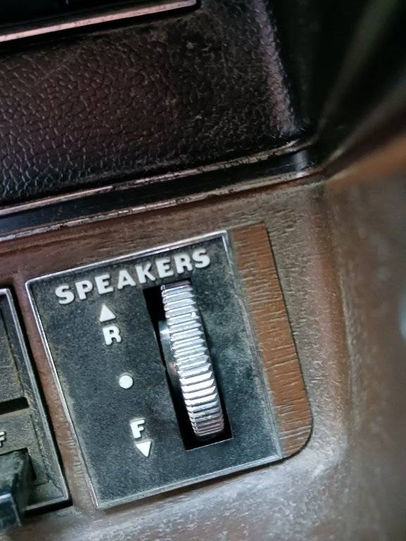

The AM radio with fader works perfect. I felt pretty dumb the first time I went under power lines with the radio on. Instinctively, I moved my phone from the seat up to the dash board.
Then is dawned on me....this isn't Pandora playing lol. How soon we forget the past!
Thanks for any insight on the brakes.

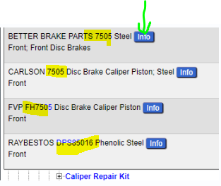

Calipers are AWOL at hte parts store and must be rebuilt.
Pistons and seals can be used from E-body calipers, those parts are available new.
To clarify, if I order a two piece seal kit for a 72 Charger or Challenger this will work? Is the piston identical also?
Yes to both.
Rock Auto has a good interchange tool (it is sometimes not completley accurate, though).
If you click on a part# (yellow) it shows interchange amongst vehicles.
The 'info' button often shows some dimensions or other good info.
Yes to both.
Thank you that is where I was comparing part numbers. Sometimes RockAuto isn't 100% depending on the year and model so I thought I'd better double check. I'll report back when I get some seals in have everything apart.
Based on report by @david hill and perhaps some others, the pistons/seals are a known interchange.
I hope so anyway, I bought 4 sets for the 4 core calipers I have on the shelf. Bought the calipers as cores in panic-mode when I learned reman calipers went OOP.
