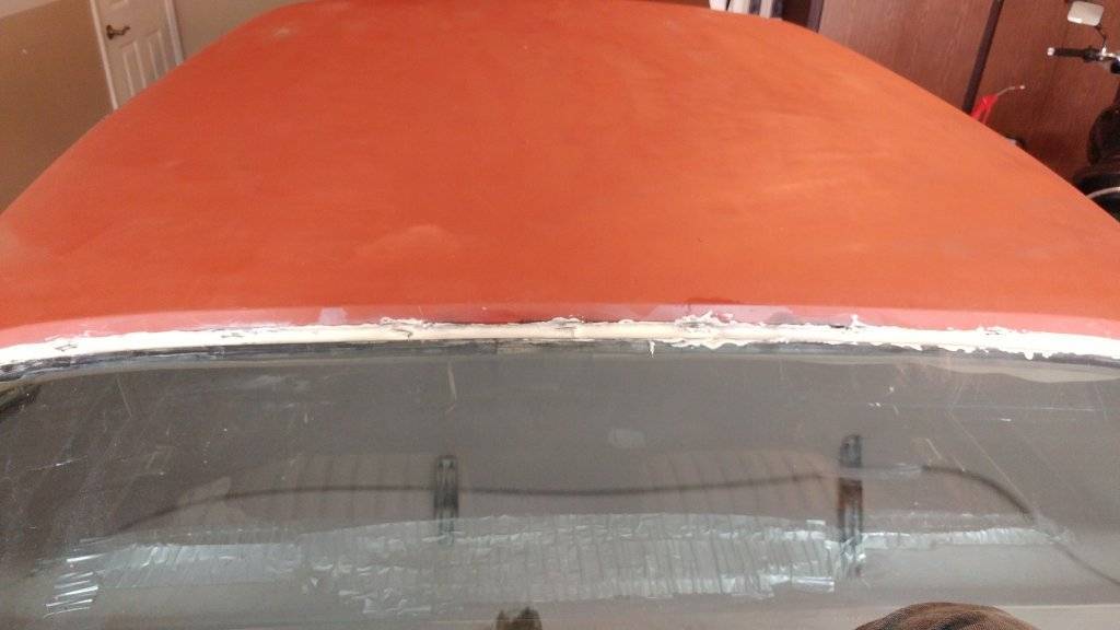

Currently the Fury is leaking water into the cabin. I guess the sanding must have taken out the little bit of rust that was holding the seal on some of the seams. It's inconvenient but not really that bad right now. I'm just patching up the issue right now until I can either have the rust holes professionally repaired or until my Dad gets the time to help me out (Which could be late fall or winter, But then again thats how long I have to wait for a shop to get an opening). Right now I have the drivers and passenger's windows sealed with a bit of black RTV silicone gel, and the rear window I caulked up with some tub and tile caulk (The autoparts guy said it was cheaper, and easier to remove when the time comes to actually fix that rusted channel). I guess I'll know by sunday whether or not it holds water, thats when the caulk should be nice and dry.

Here's a shot of the caulk job. Looks like it'll hold.I'm thinking of testing it with a garden hose tomorrow.

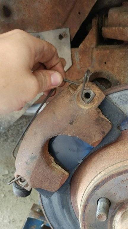

Can anyone tell me which way this thing goes on? (The thing I'm holding onto in the picture) do I have it on the right way? It doesn't seem very secure.
180 degrees from where you have it now, vertically. Put one pin in, hook spring around the bottom, put the other pin in, done. Straight portion of the spring should be about a half inch? Above the bottom of the "horseshoe".
