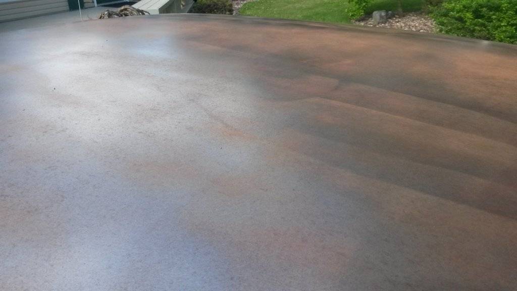

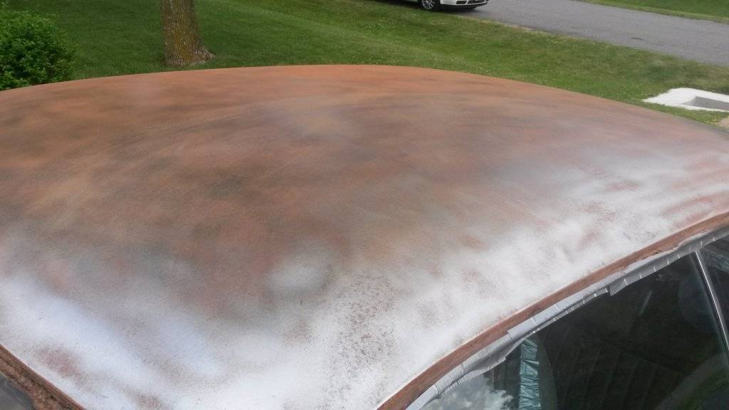

I've been absent a while lately busy with work, but I've tinkered around with some small fixes to my Fury. I put a new radiator fan in, a fixed blade one, it blows a lot more air, the old clutch fan was shot.

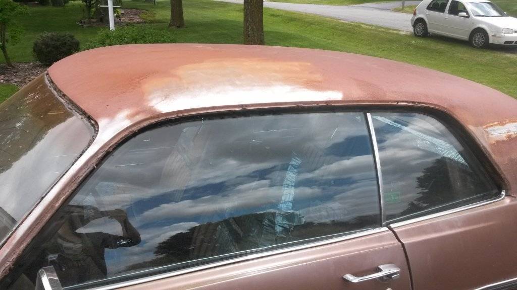

But more recently I started work on the roof. Turns out the rust on the roof was not really bad at all, nothing deeper than surface rust. Anyway I'm finishing it up tomorrow then taking the rest of the week to address other issues related to the roof.
Here's day two's progress
Most of the rust still on there can just be rubbed off, the air compressor didn't take that dust off for some reason.
I already bought some sandable primer, I still have some touching up to do around the edges and there's a small hole that I need to fill some how, I will post a picture tomorrow.

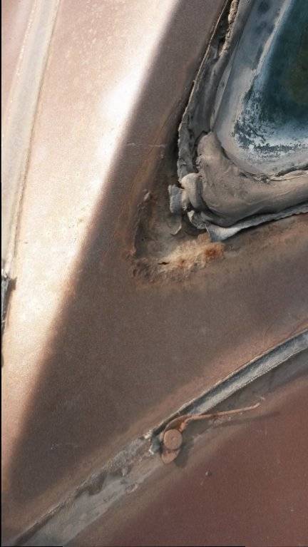

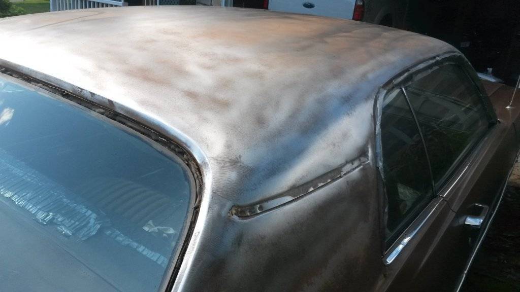

More progress today, all the major sanding is done and I'm gonna try to apply this Por 15 stuff on that nasty rust hole then fill it with fiberglass or bondo or both. Anyhow later tonight I'll start on that
If that's the pin hole at the rear window... keep in mind it will eventually come back to haunt you if its not repaired with metal... temporary fixes are better than no fixes, so don't let that stop you.
What would be a good way to repair it then? Would that Por 15 stuff work? My dad said that it worked for his GTO's floor boards, I guess it's suppose to chemically alter the rust so it can't progress or something.
That Pin hole isn't as bad as the one on the other side, I couldn't get the picture to load but it's somewhere around twice as big as that other one.
I've been working like crazy this summer, And about half my checks are going towards the Fury lol
Pulling it all apart and welding in metal is the only way I would call permanent. That's a lot of work and may be tools and skills you would need to hire out... If you're ambitious get an estimate... if not ready... then for now brush a little OSPHO (hardware store item) on there 24 hours later knock it down with a wire brush and use the POR15 if you have it already... the paint wont seal the hole, so you will need something that will do that. POR15 requires a top coat to be UV resistant IIRC... so you need to paint it with something they say will stick/UV protect. Just accept that rust and leaks will eventually return if left out in the weather (steel wouldn't guarantee anything in that condition either) and some day you may have to have the rear windshield removed and this done in metal. Cars that sit out and experience rain and freeze cycles are always going to be more prone to rust than ones that are protected from those conditions... even a non metal repair may last a decade or more in good storage conditions.
