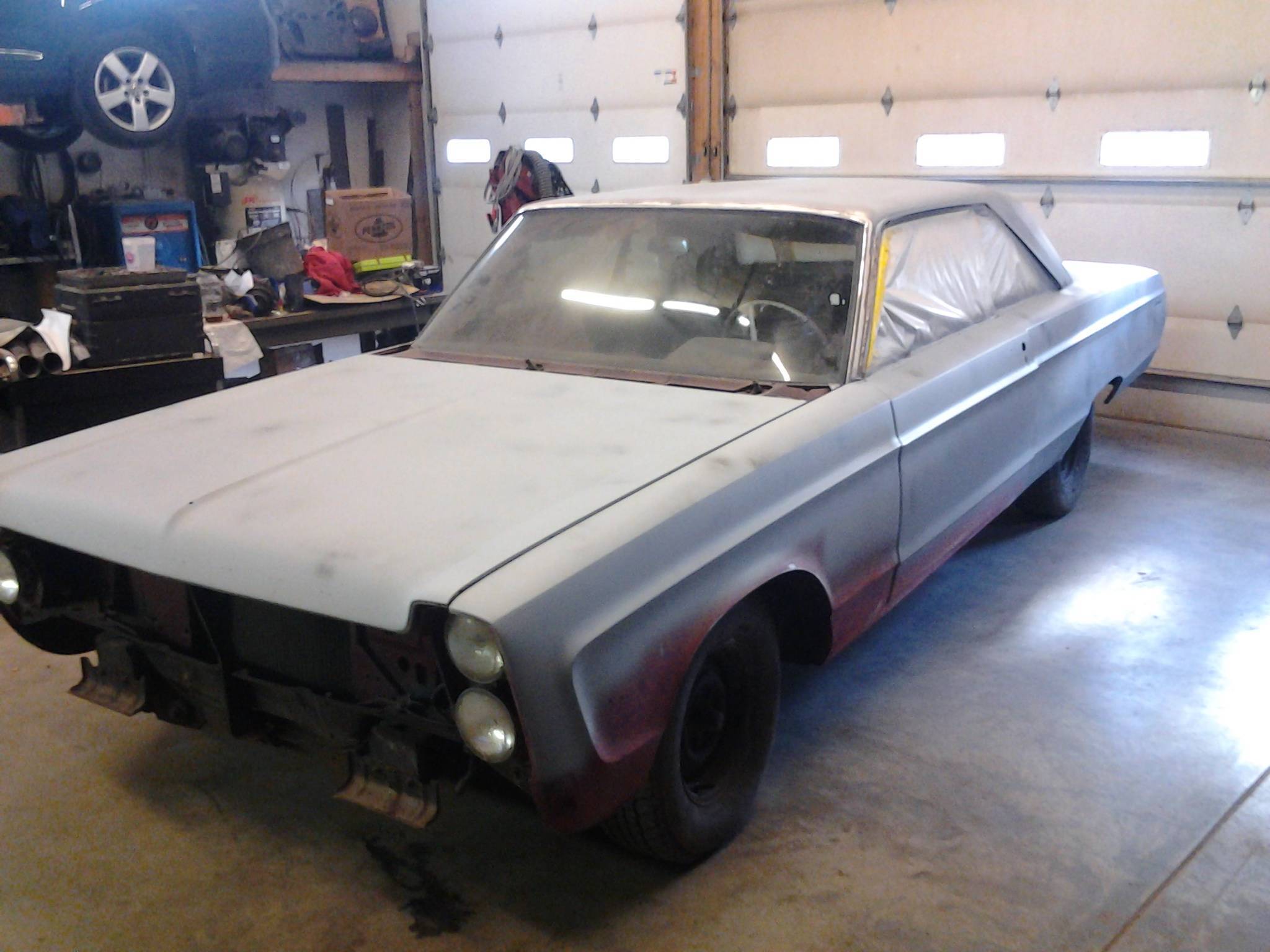

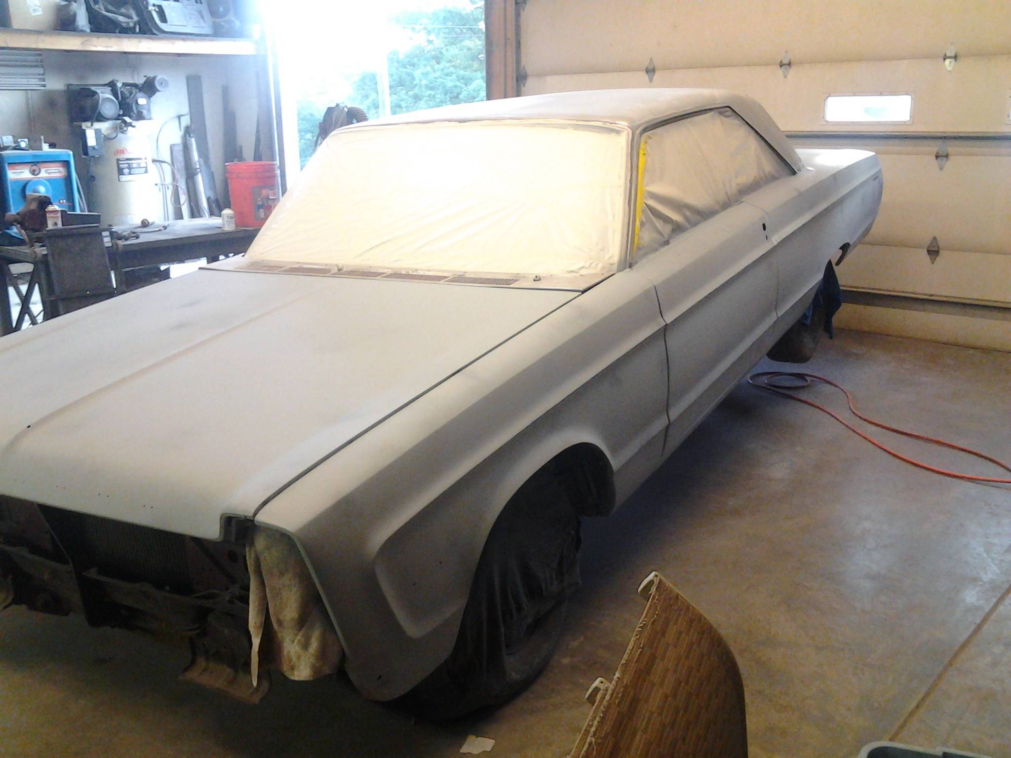

Well looks like Christmas came early here in Wisconsin. Got my quarters in just the other day, about a full half month early.
So far all I can say about them is that they look like they'll work, but they are also a little unfinished. Lucky for me the wheel openings are just about perfect. I'm debating whether or not to bother putting the chrome trim back on the wheel openings when I'm done with it.
I'll put up pictures as soon as I get the chance

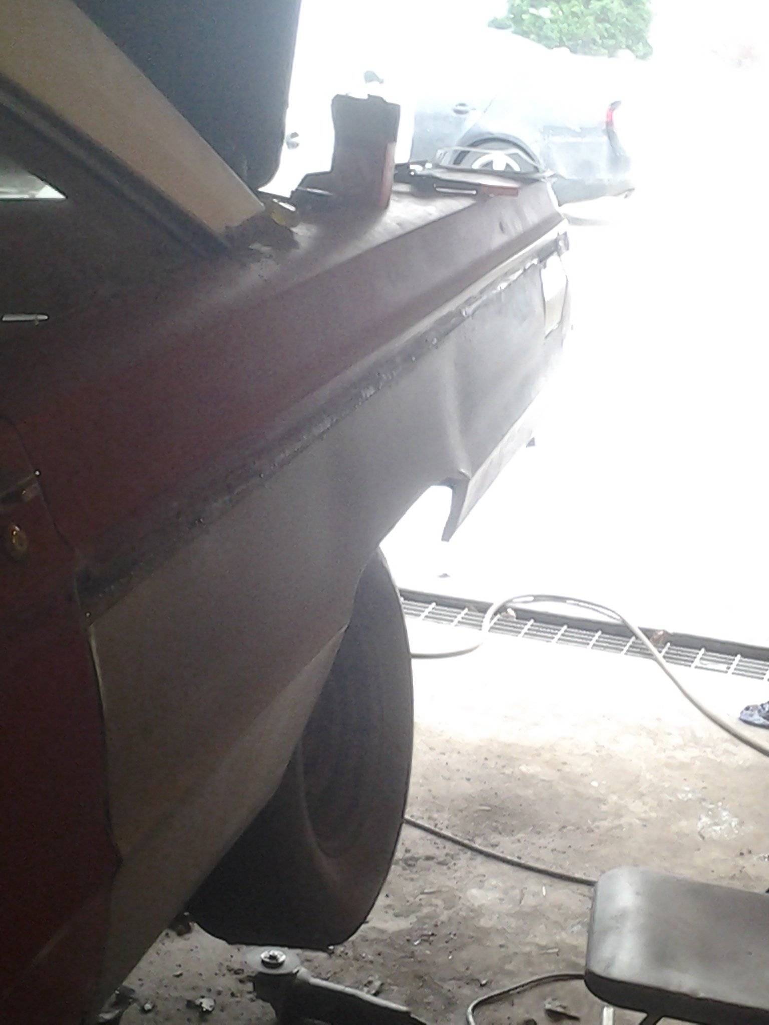

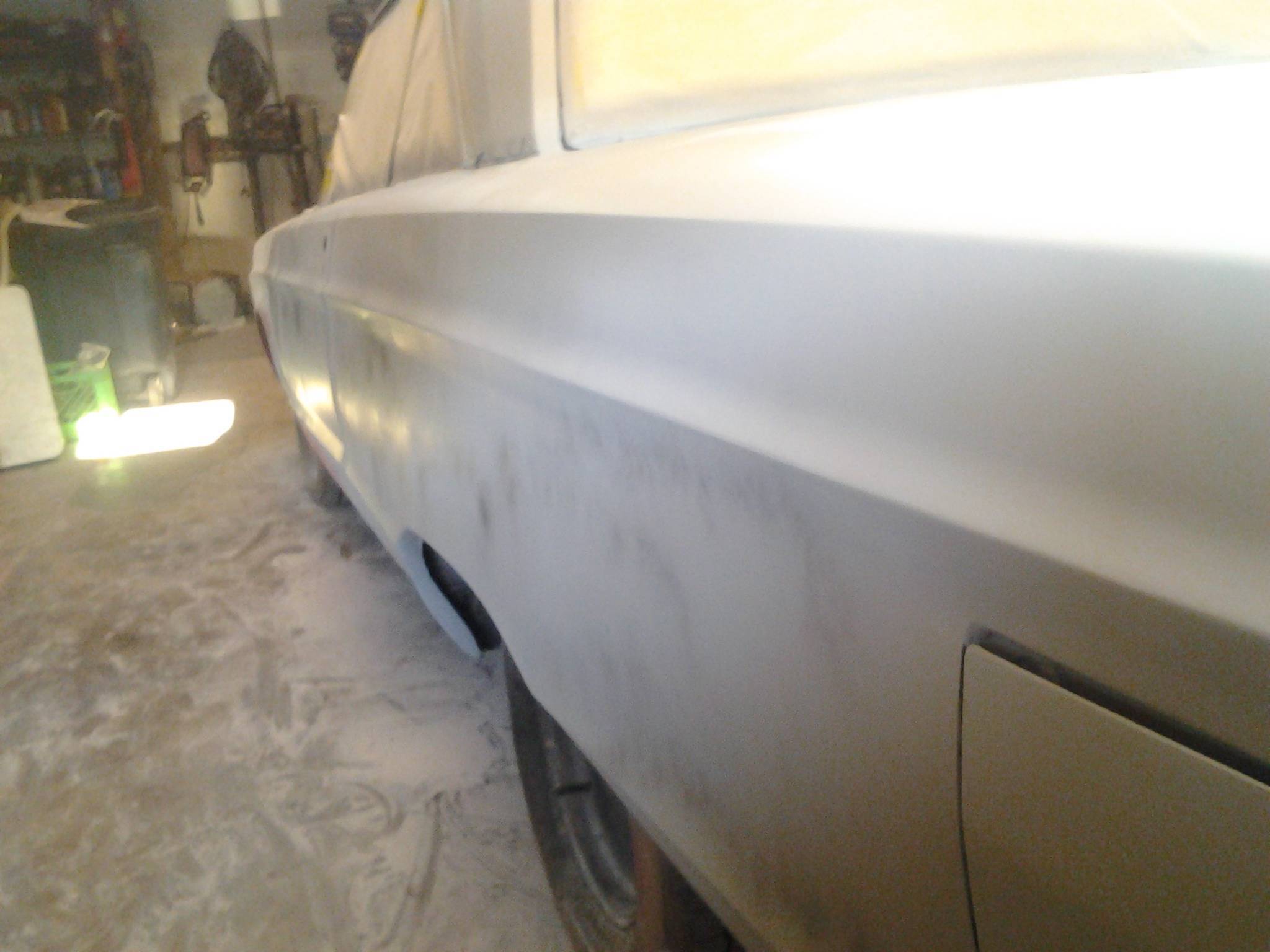

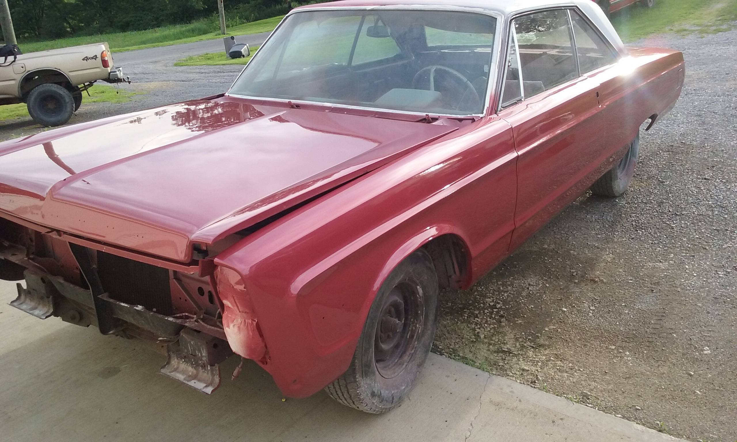

Admittedly I'm working on a tight budget as well... (youngest in college) and I went the "economy grade" panel route. Wildcat in Oregon had a compelete quarter for $1200.00 and that was out of my budget. The drivers side quarter on my car was toast and I used it to replace it. From the body crease down..about half the quarter full length. Thanks to my buddy, he masssaged it out with heat and it turned out good. Not great.. but liveable. The door isn't shut in the one pic so it looks like the line is way off.. but Its pretty darn straight. The rest of the car is real clean and solid. Had to put a patch panel in the lower front passenger fender. The bottom pic is brutal, I cant lie.. but after some heat and quenching it worked. Again.. it's a low budget driver.. have mercy on me! Hope this gives you an idea. Best to have someone with some metal/autobody skills when you buy parts like this.
