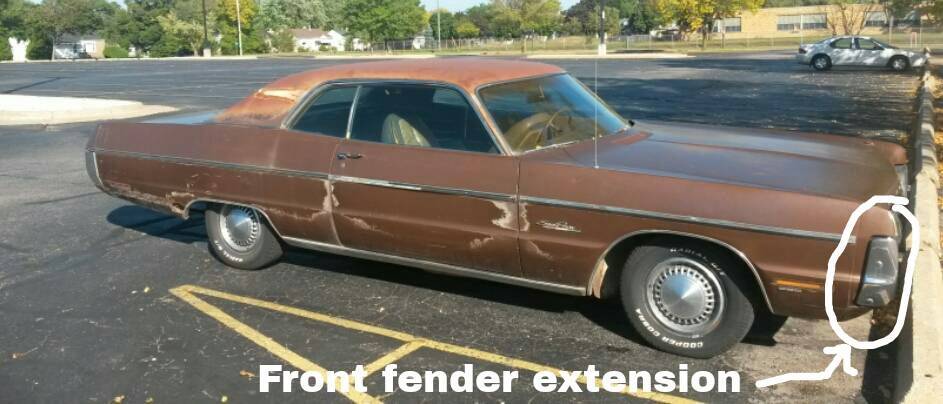

Just wanted to confirm something before I order it. The front fender extensions are those little raised up bits in the front corners of a fuselage C body. Next to the hood. Right?
