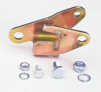

Go with the 1406 electric choke.
You'll also need a carb linkage adapter 1481.
