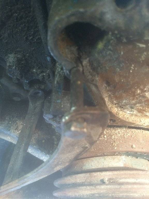

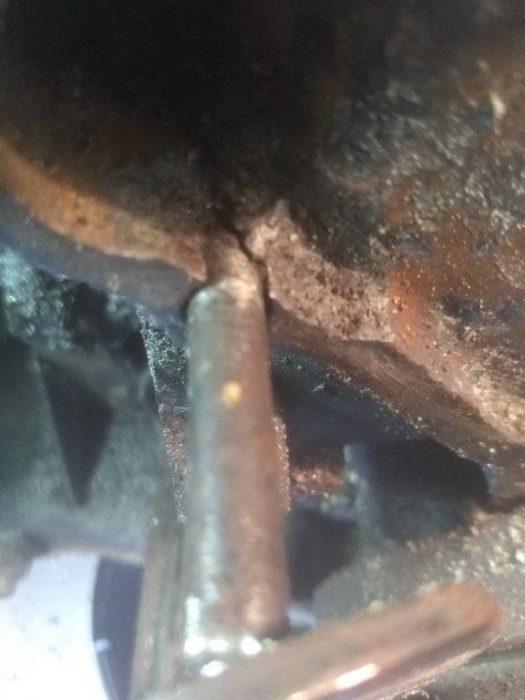

Looks like somebody had repaired the cover where the bolt is because there was some sort of corroded epoxy around it and when I picked at it, it exposed the bolt more...so water got in and now the bolt is frozen...

From what I am seeing in your pic's, the bolt is heavily corroded in the timing cover. I am thinking it probably not stuck in the block just the cover. I have seen this a lot on Mopar's, Ford's and others that the water pump bolts that double as timing cover bolts. Before you buy a new cover have you checked for a used one? I have gotten parts from these guy's in the past also.

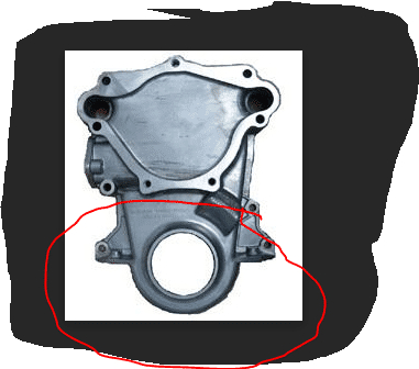

I found one from a 318 on local Craigslist for 40.. when I called O'Rielly, they said they stock two different gasket sets for the timing cover and they come with about 10 pieces... besides the gasket and seal and fuel pump gasket, what else is there?
Timing cover gasket, fuel pump gasket, water pump gasket, front crank seal, oil pan seal and pieces of oil pan gasket. I think that should be about it. Something like this one

Stainless are ok, oem are ok, put thread sealer on the threads and antiseize on the rest of the bolt. Threads go into the water jacket.
