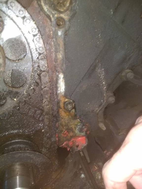

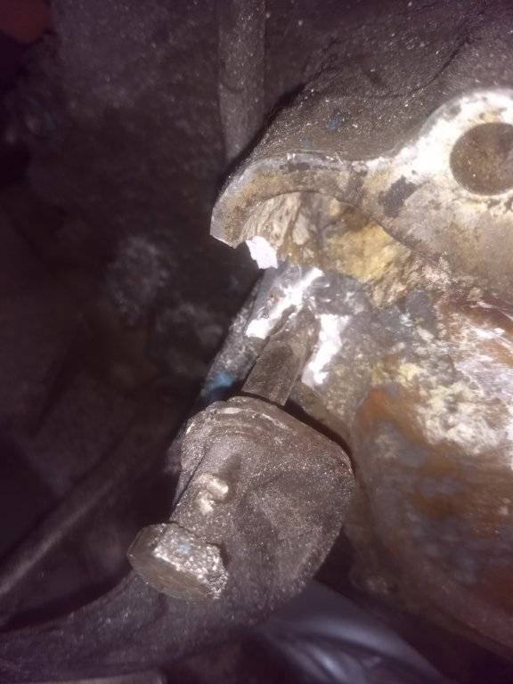

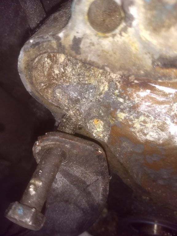

I chipped away at the epoxy repair material and then I took the Dremel and cut the housing around the bolt until the housing broke loose of the bolt enough that when I put the rachet on it it turned!!

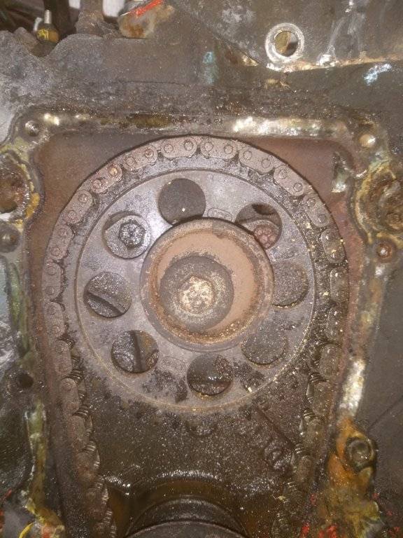

If they are stock gears, the top gear will be plastic and the balancer has to come off to get at the gears. Put a breaker bar on the big nut for the balancer and line up the timing marks to TDC. Pull the distributor cap, rotate the bar back and forth, 12 degrees of slop is ok, 15 is out of spec and 20-25 is at the point of failure for the timing chain.
Plastic gears can go anytime after 70k
Dave

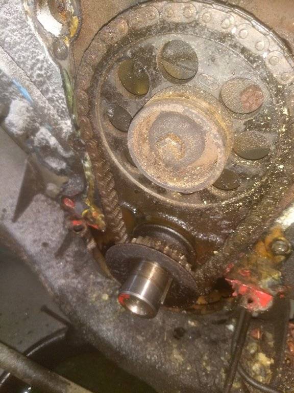

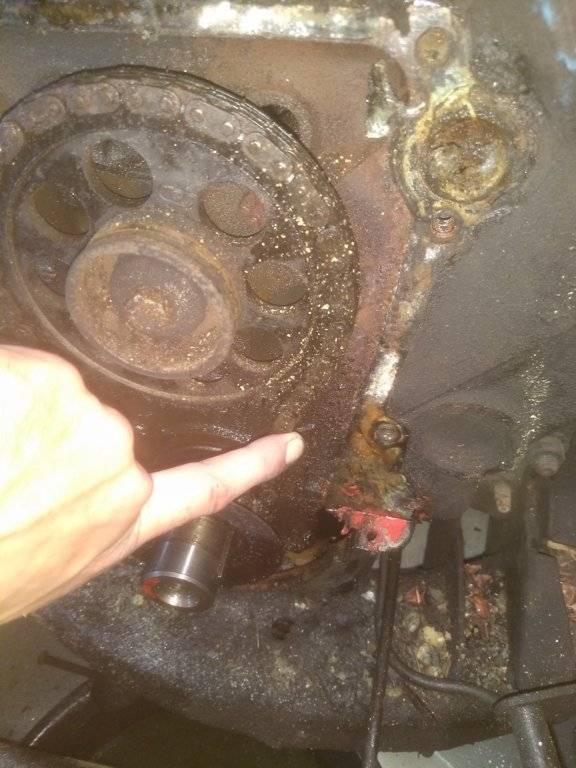

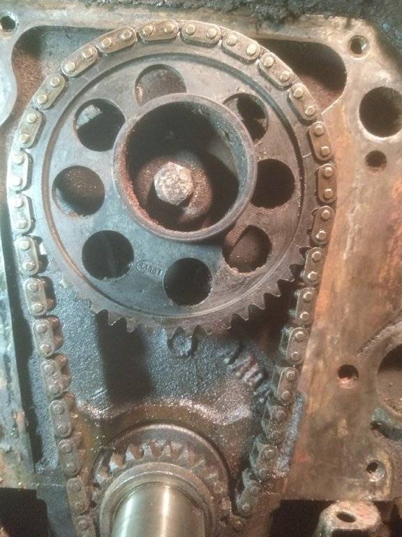

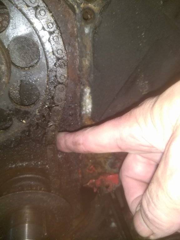

Thanks Dave! I just paid 36 bucks for the new chain and gears. I don't see plastic but it looks to have a lot of slop. What do you think?
Check out the offset that has occurred in that "washer".. I'm not clear on why that has a can shape instead of a flat washer..
I can only think maybe it wasn't torqued correctly and I imagine that could have caused some vibration...

Glad it jumped to life to show you it wants you to move forward with getting it on the road again. That engine will run a lot better with the new chain. Keep the updates coming!

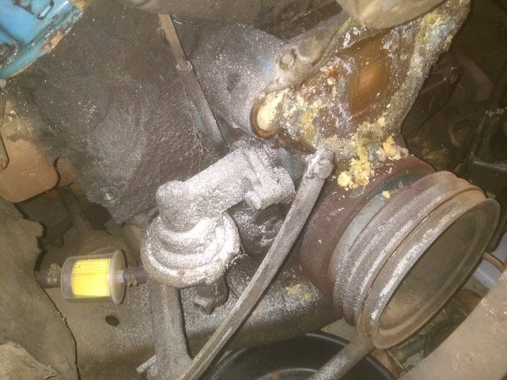

The timing chain is worn out, so you would due well to replace it. Be sure to clean up the eccentric for the fuel pump as it is rusted and all that crud will break loose once the engine starts. The oil slinger on the crank is normal and should look like that. This is probably a high mileage engine, so it in not likely to be in pristine condition, if you plan to sell the car it will be worth a lot more running, so you can probably recover the cost of your parts.

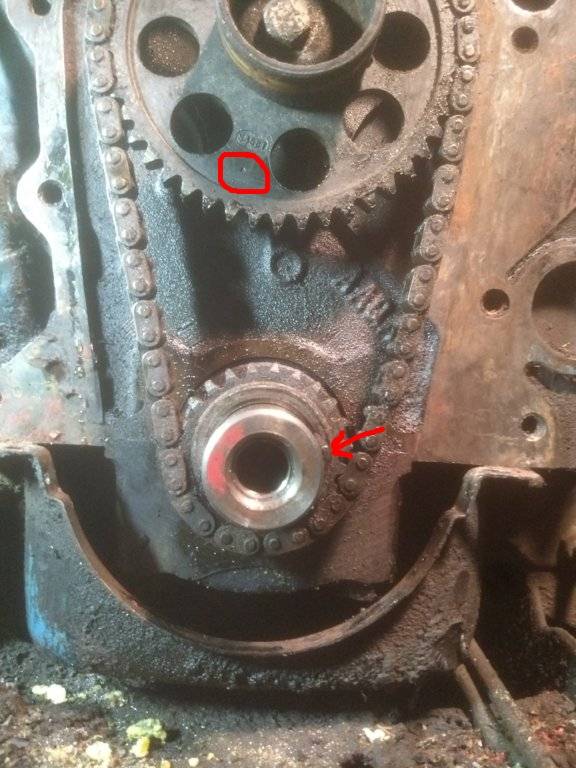

I think that you will find that if you rotate the crankshaft just a little counterclockwise the the little dot will line up with the keyway on the lower sprocket. There maybe a dot on the lower sprocket tooth but I can't see it as you didn't clean it to well. Just take a wire brush to the keyway area and don't worry about any crap falling into the oil pan as it would be the least of your worries.
Great thank you... About that oil pan, I do see crap in there and I'm tempted to stick the shop vac in there (?!)... I'm at work right now but... Does the oilpan come out without major surgery? I'd like to clean it out and change the gasket

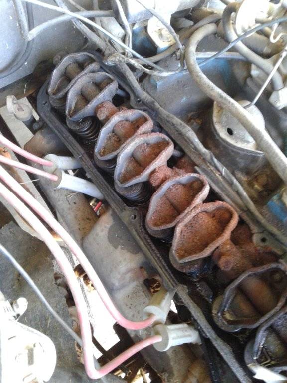

We've already been over this in another thread about the oil pan with replacing a timing chain/cover gasket, pfffft is this the car with the rust inside the valve covers?
IMO with all the crude clogging the two water passages to the block I'd say the motor was overheated and cooked and you really at this point don't wanna see whats in the oil pan.
