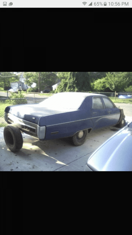

Cool! One other person i know of now with an NJSP Fury. Is yours the blue one I've seen pics of before? My dad ise to have a brown 72' fury III NJDMV scale car. It was "MV109" and it was brown.
actually mine is blue, black interior, hidden headlights, etc.. I havent posted pics anywhere tho. If you recall where you saw it, bounce me back :)

I found pics of this one on a google image search
that might be it .. that looks like a pic from before I owned it. it was low mileage car, rust free, clean as a whistle, with wrecked front end. i replaced stub frame/fenders, bumper, hood, etc, rebuilt original engine.
i searched Google .. but it didnt come up. if you don't mind, and IF you have it, so we don't chew up your thread on my personal crap, PM me a link to the pic? thanks!
