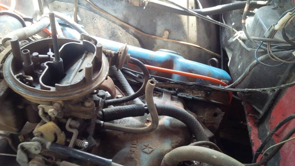

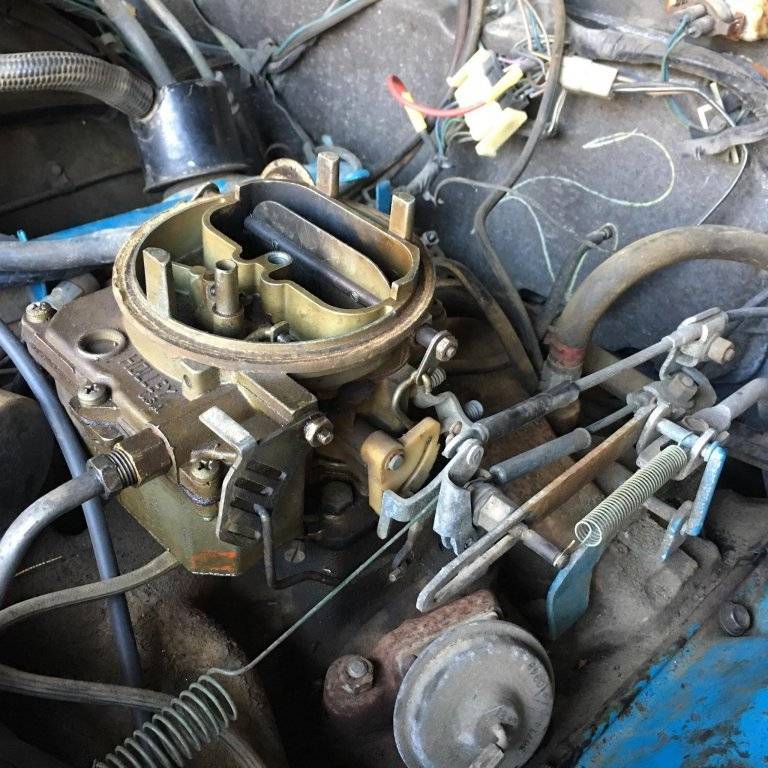

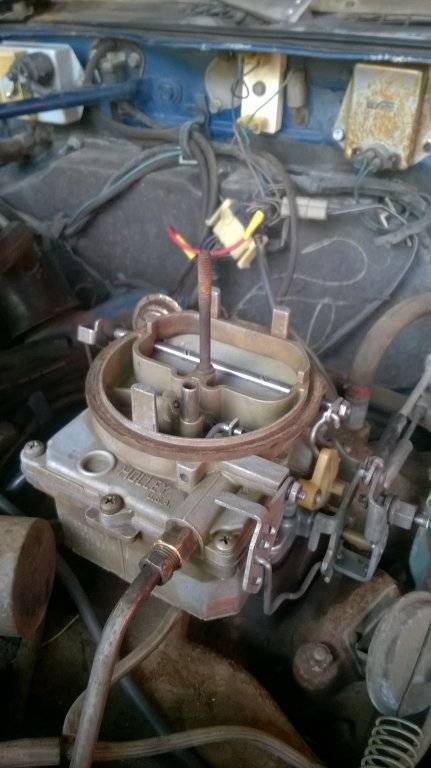

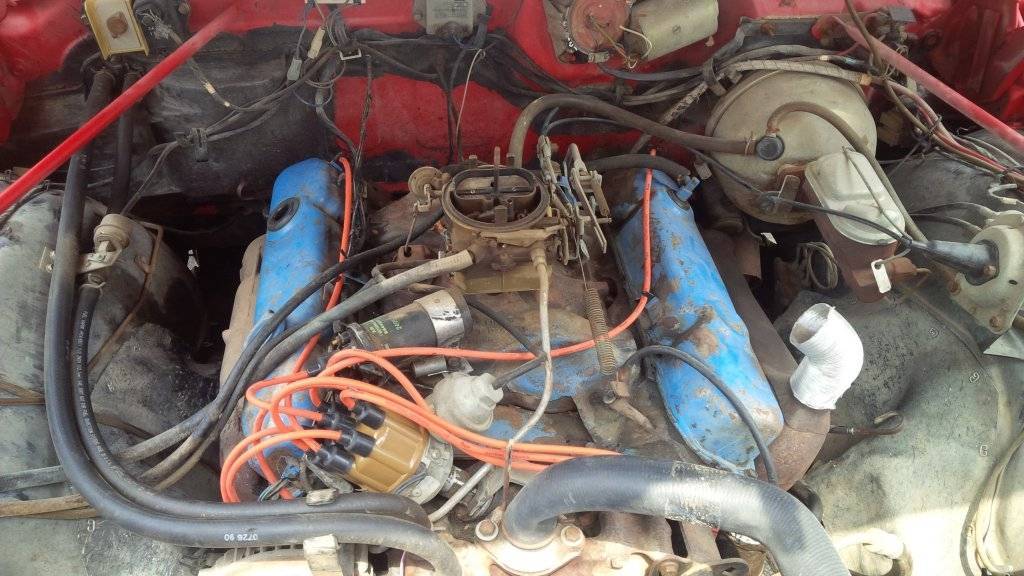

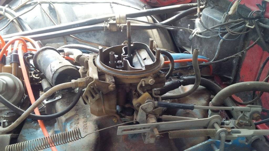

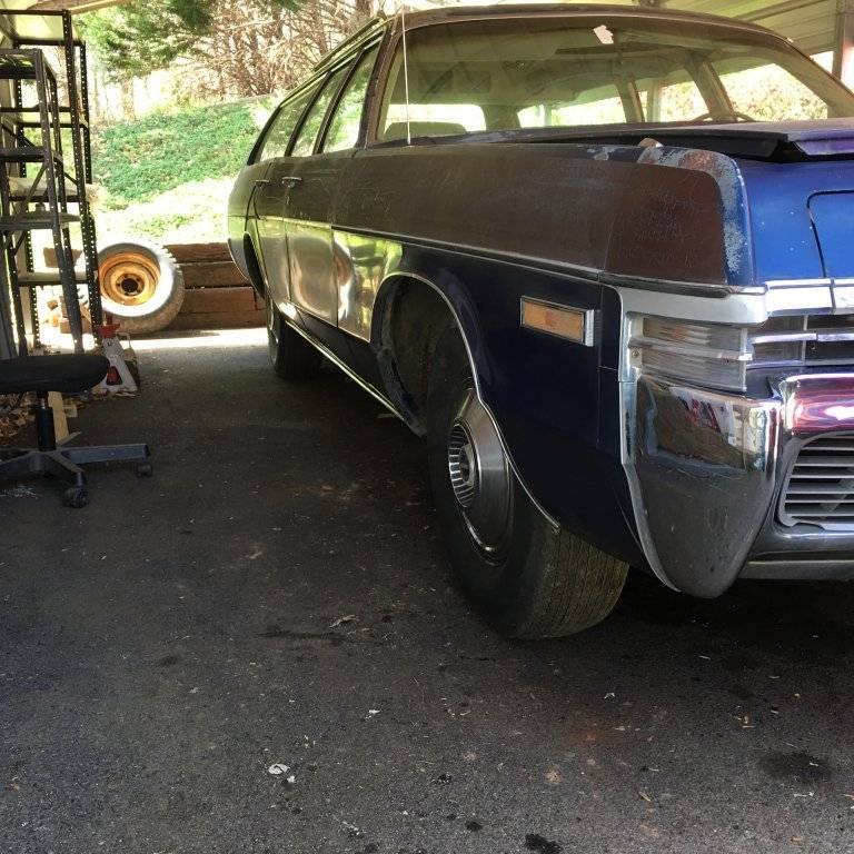

"Restoration" seems a bit presumptuous and overly ambitious at this point. I figured this was as good a place as any to post some pics of some work I've begun. My goal right now is just to make it roadworthy. It's not far off from that, but we'll see what happens as things progress.
Today I got the tailgate glass up. Seems like a small thing, but the motor works, that is a relief! $$$ saved. With electrical power on the car, the switch does not cause the motor to work. Continuity, or lack thereof. So it could be the switch, breaker, or wiring. Not sure if there is a relay, that is a possibility also.
I just got inspired looking at these photos. Noticed white plastic part was tilted up in clean photo. Tilted it to level ran out and stuck my last half quart of non ethanol gas in the jar and started the engine. It is cool and rainy here today so car needed choke. It ran fast at first but I see when the plastic part (fast idle cam) is kicked to 'level', the engine runs slightly slower. Still wants to shut down when set to level, however, if it's not just that the engine is cold, may need an adjustment or two, or automatic choke replaced. So nice to have throttle response instead of engine dying when I touch the accelerator. I will need to get the tank & fuel line cleaned up so I can actually run/fuel the car normally. That will take time I currently cannot spare. One.Step.At.A.Time.Dirty carb now clean. Throttle response much much improved, but idle is way too fast. Fed fuel pump from mason jar, empties it of gasoline in no time flat. How to fix? Adjust screws on bottom of carb in a half a turn or...?
