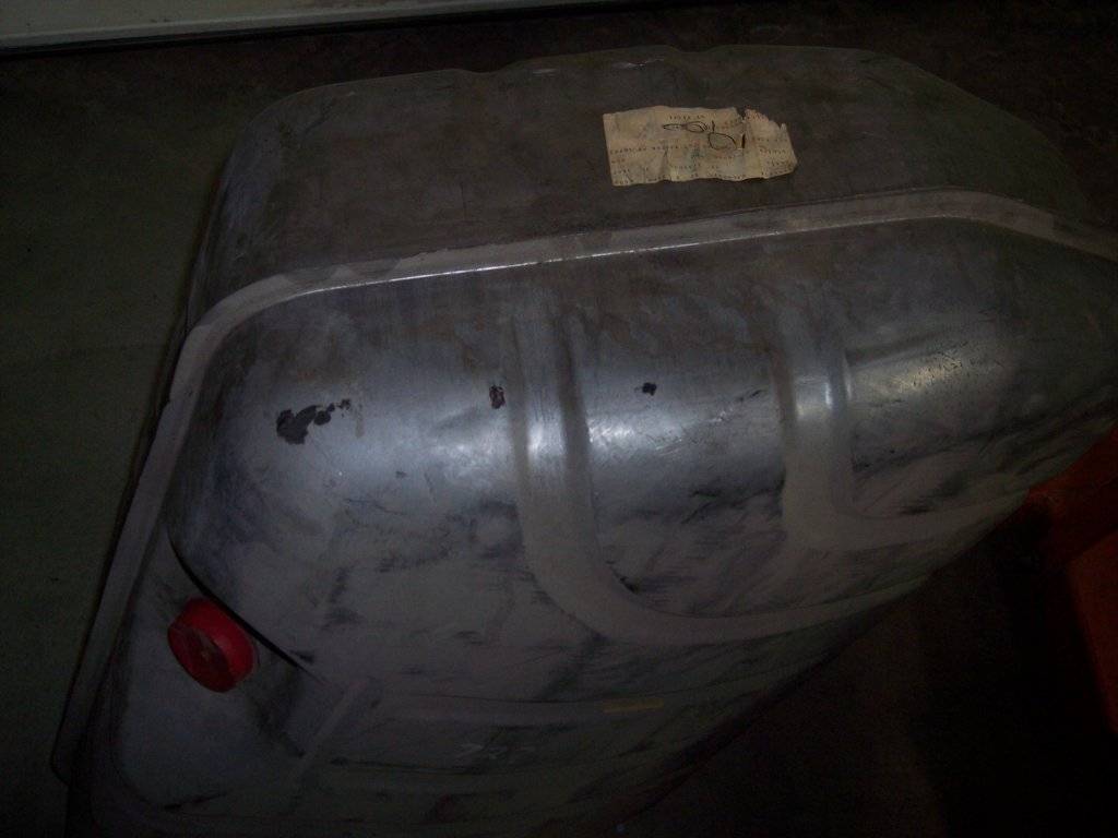

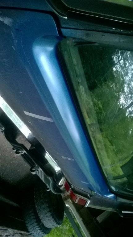

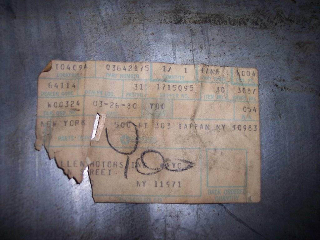

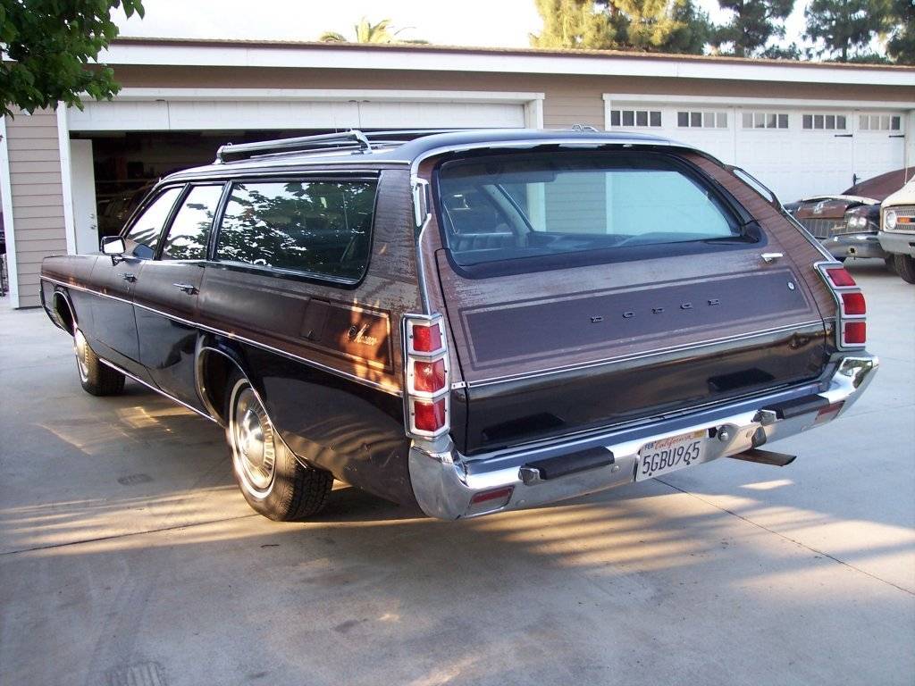

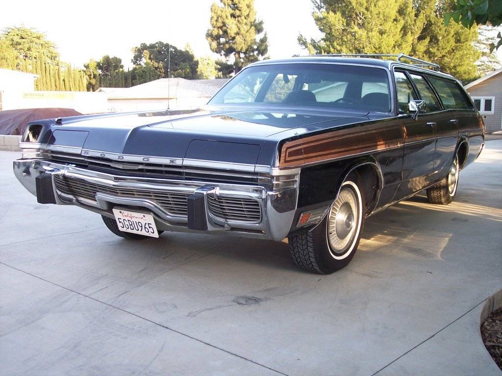

My 73 Monaco wagon had the wrong tank in it (it was from a B body Crestwood wagon) so I had to use my last NOS wagon fuel tank for these models (I enclosed a couple photos below of the new tank) and had to install a new sending unit. A photo of my wagon is attached too. These are great vehicles. I have to believe Chrysler Corp lost a lot of money on each one they built given their relatively low volume and the complexity and uniqueness of all the parts specific to this particular body style.
