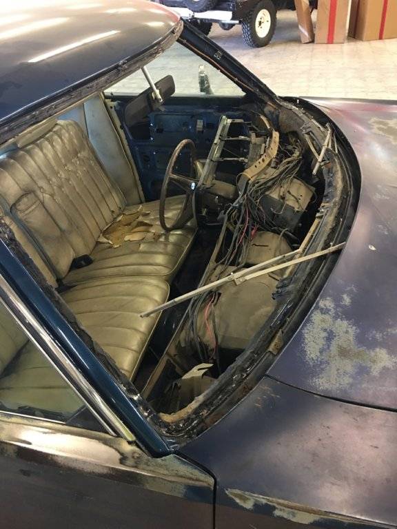

Clean out that window channel and hit it with POR 15 or Rust bullet before putting the windshield back in. They like to rust out.
Thank you for the tip. The original paint is good in the channel itself, fortunately. Below the WS frame on the pass side toward the cowl there is some surface rust & I will get some Ospho on, that should stop it and make it paintable since it converts the rust to iron phosphate.

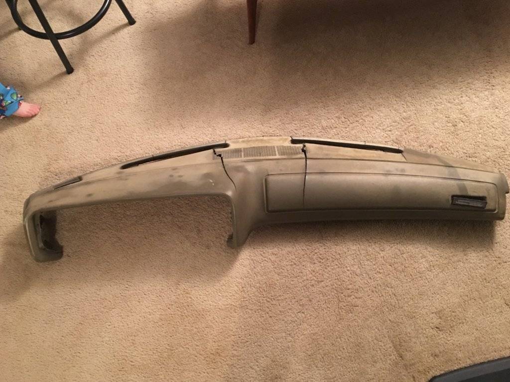

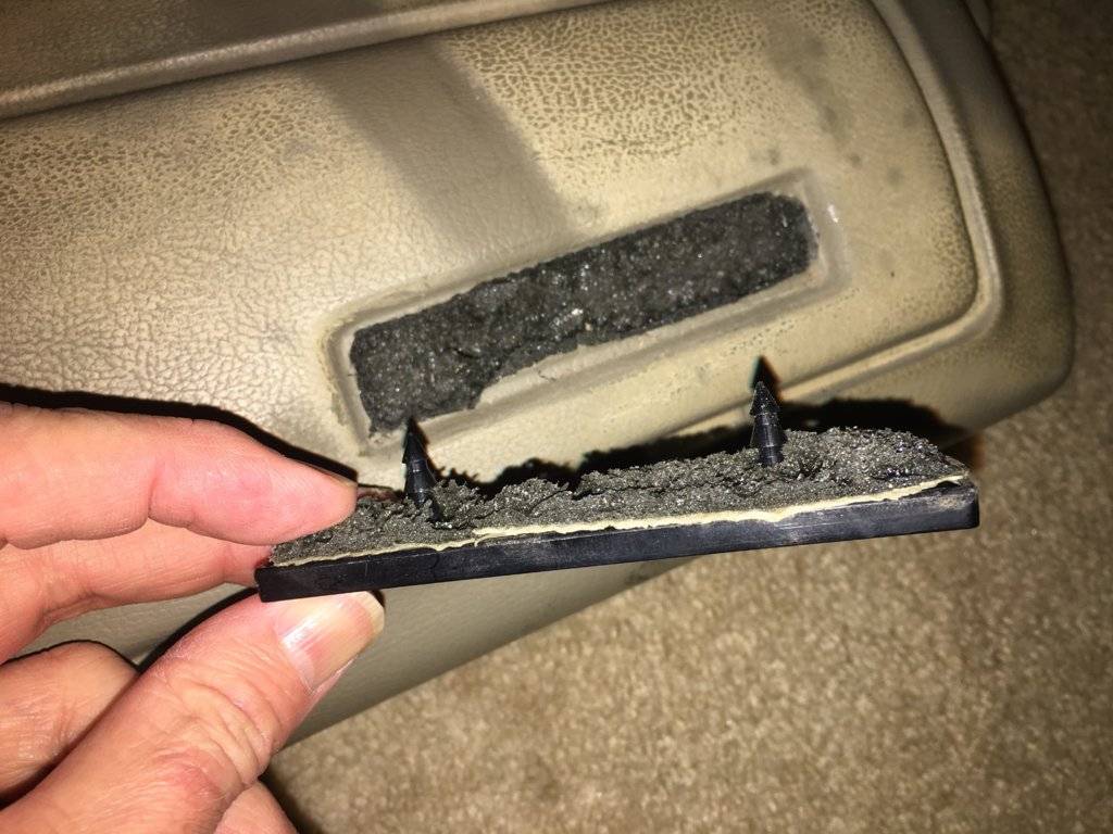

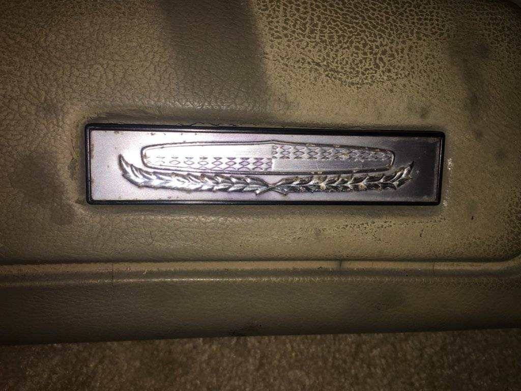

The dashpad removed. Vinyl very rough. Monaco emblem trimmed out carefully. It’s inserted with two barbed plastic studs. Glad I didn’t hack them off unintentionally.
