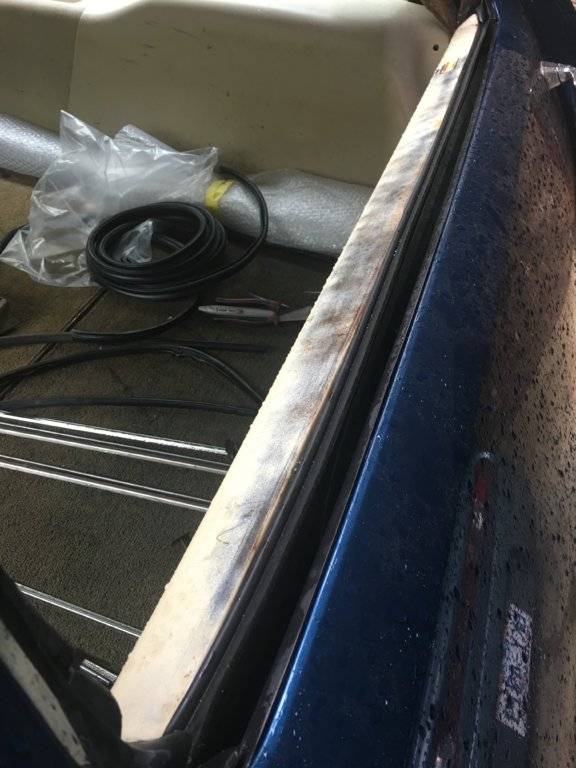

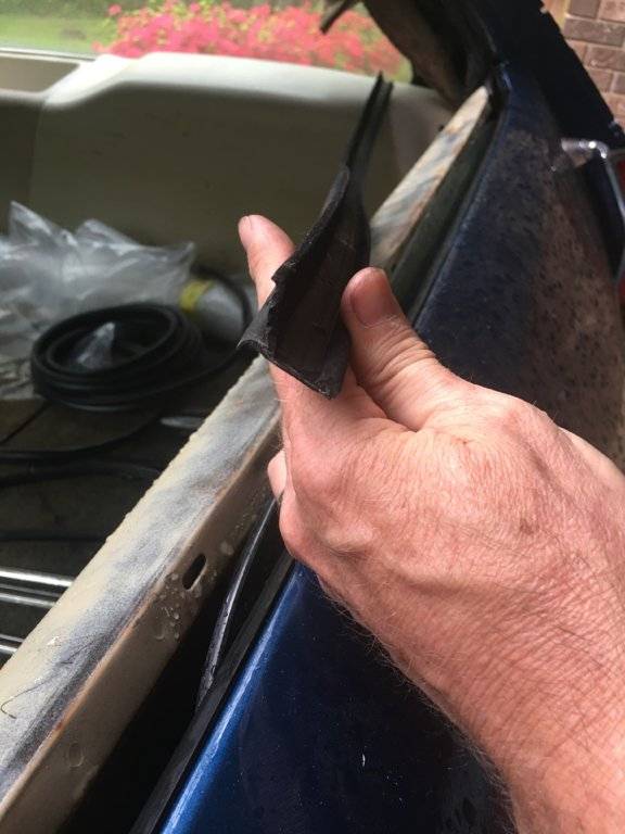

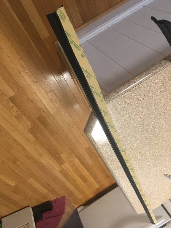

Got some “Outer Beltline Strip” part # 70-3805-61 from Steele Rubber Products of Denver, NC directly from the store today. It’s not an exact factory match but looks good. I think it’s going to work nicely. The function is just to keep dust out of the tailgate and keep the glass from banging in to the tailgate on the inside. It’ll have a nice finished appearance. It is 50” long.

Going to try double sided tape at first to see if I like it. May not hold up but I’ll try it. I can always try some other fastener later.

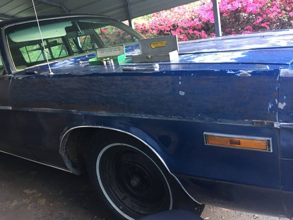

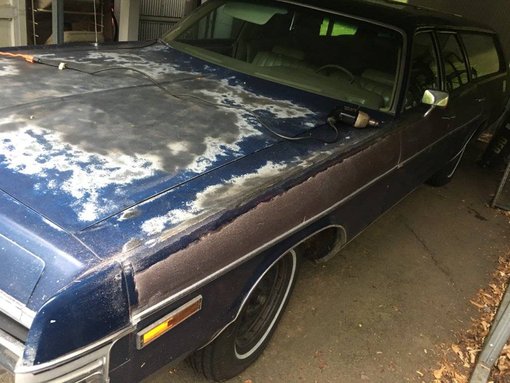

Stripping the old woodgrain off. Started.With a putty scraper. And a heat gun. And lots of elbow grease. Whew! Still lots of adhesive left. Unfortunately. But the vinyl is off the front fender anyway. It is evident that it was never meant to be removed. Ever.
For comparison...driver’s side. I can tell I am going to have to pace myself with this stuff...
A little bit more removed. Bought the 3M decal remover wheel. Still takes a lot of effort.

Try and save the old clips from the original weather stripping....might be able to re-use them on the new part if the two sided tape does not hold.

Working on the drivers side. It is coming off easier on this side. So far. Paint looks better. I guess maybe this was the side that was parked against a wall. Ha ha.
