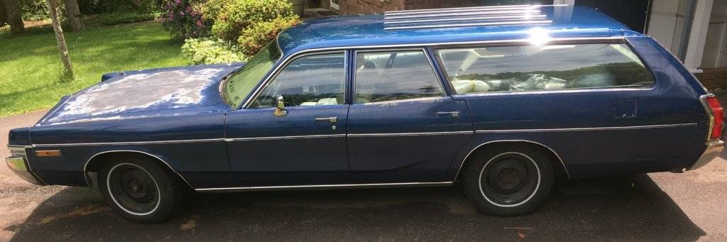

73 Monaco wagon

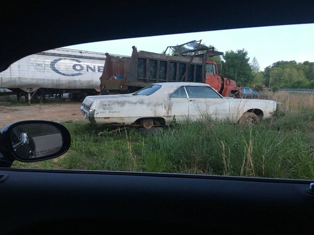

2nd random unrelated photo interjection. Abandoned 300 coupe a few miles north of Pineville, KY off Hwy 25E.

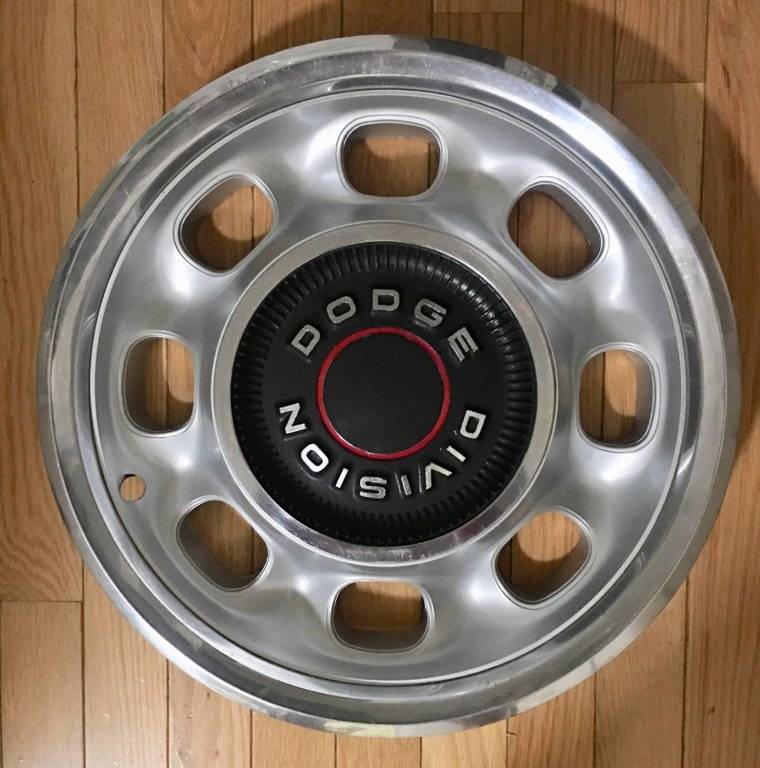

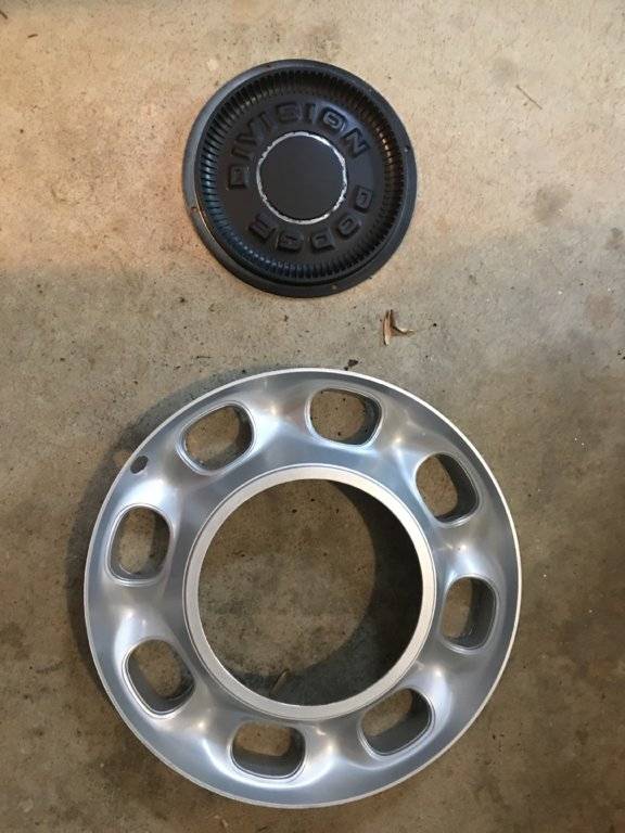

Getting closer, on the wheel covers. Argent paint from Year One.
It was fun rediscovering original paint that hadn’t seen the light of day since 1973.
ImpJay, if I could put this coupe in a box and send it to you, I would. I know you would put it on a shelf and slowly fix it up...’some day’....your Imperial would then have a stablemate.

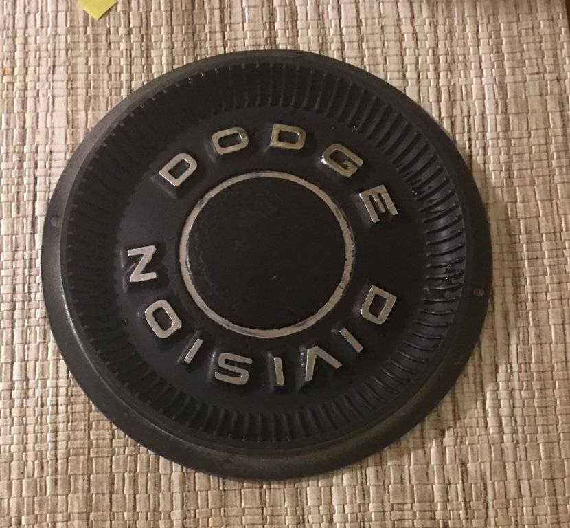

Let it dry for a few days then peeled the tape off the lettering. I’ll have to buff it a bit, hope it gives me a matte black, don’t want flat black and don’t want gloss black either... and then I’ll paint the circle red. Quite a sporty wheel.
I appreciate you attention to detail on those wheel covers.....not sure if I would be willing to put that much time and effort into them. ;)
First wheel cover cleaned, repainted, reassembled. The argent paint from Year One was expensive but I can tell it is a quality paint.

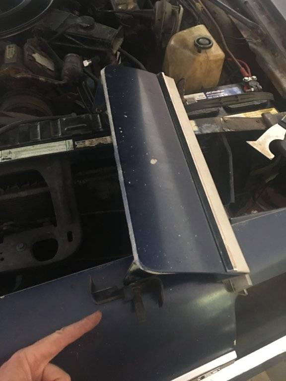

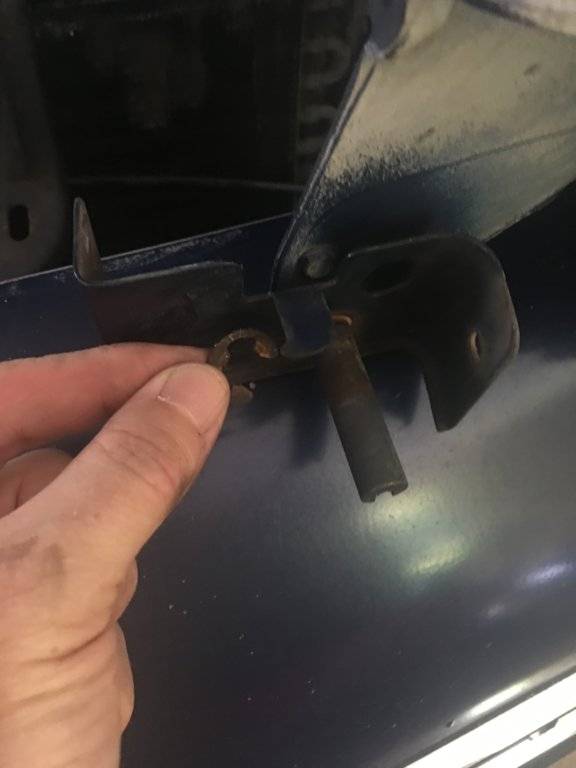

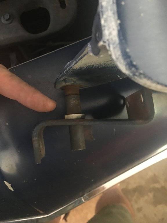

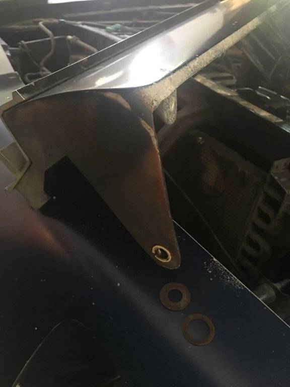

Removing headlight covers for painting. First disconnect the square bar ( pops out easy). Next unscrew the three bolts. Then slide off the circle clip and clockspring. On the other end of the cover two washers will fall off, one big one will (probably) still be on a hanger stud and the cover assembly, then slides out with a little jiggling. Three washers total.
