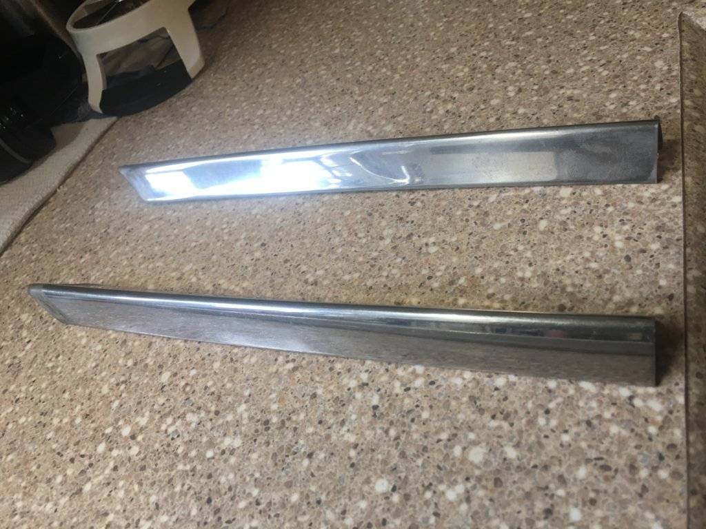

Stainless steel trim reinstalled beneath grab handles. A little hazy but not bad. Stainless is rarely ‘bad’, you know?
Cleaned it with rubbing compound. Has some very light horizontal scratches where it probably went through an automatic car wash a few hundred times. I’ll get a polishing wheel and do something about those ‘someday’, in the meantime it’s a five footer and looks just fine.
When you install this it needs to slide up and over the plastic retainer (which is now under aluminum tape).
I used some P-80 evaporating lubricant where the end slides onto the chrome grab handle.

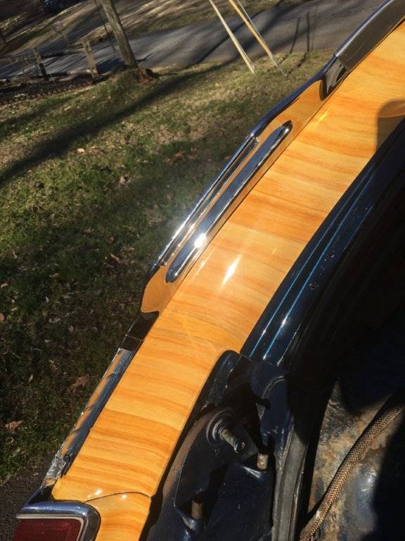

Had to remove taillight housing. A few delicate but persuasive taps on the end with a rubber mallet, and, voila, all done. (My pics go from driver’s side to passenger side but...you get the idea!)

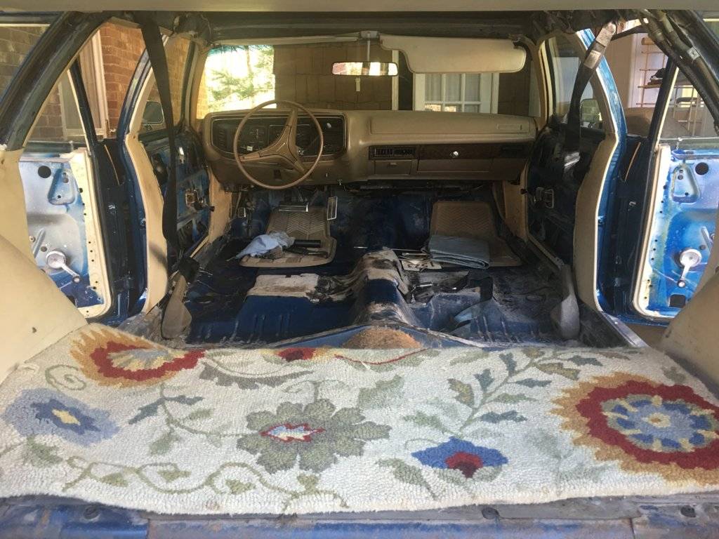

First steps. You know...
Remove seats.
Here’s a view you don’t get very often. New carpet! Ok, not really. I think it came from mom’s...the kitchen...
If I want the reward, I am learning I have to persevere...

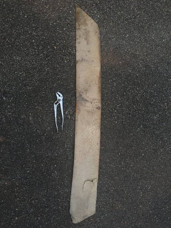

Here’s the paperboard. I think it goes under the headliner under the rear air deflector. Somehow.
I bet if I go back into this thread to 2017 I’ll see where it went.

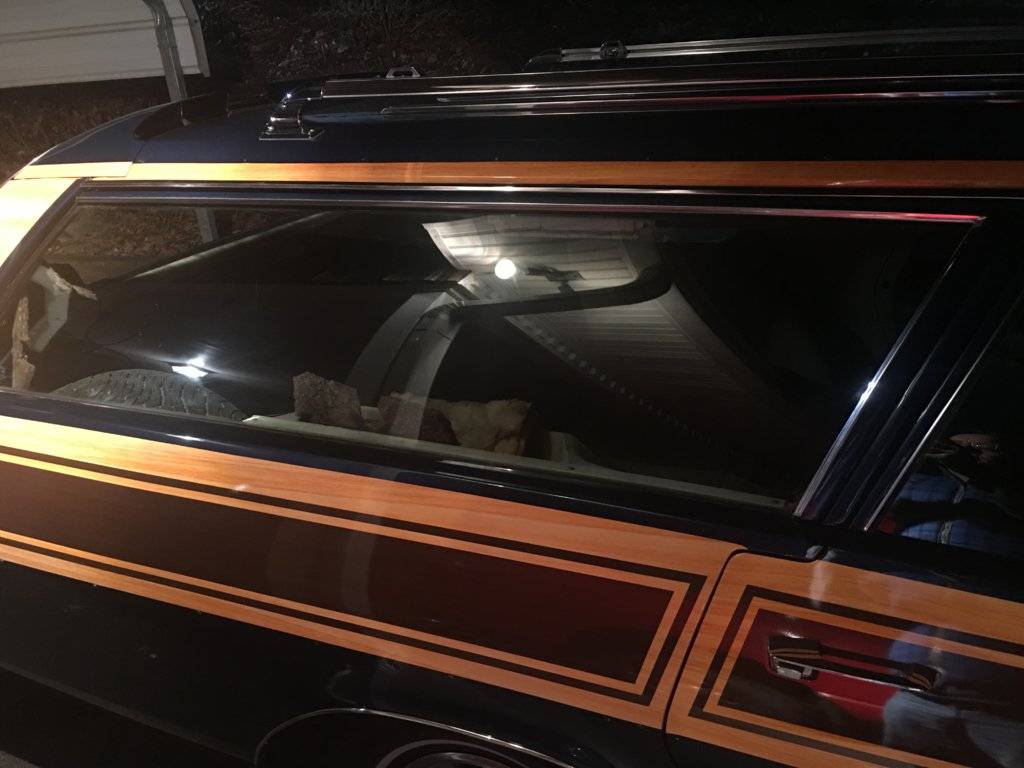

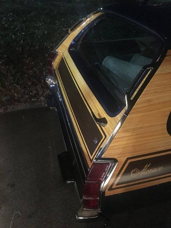

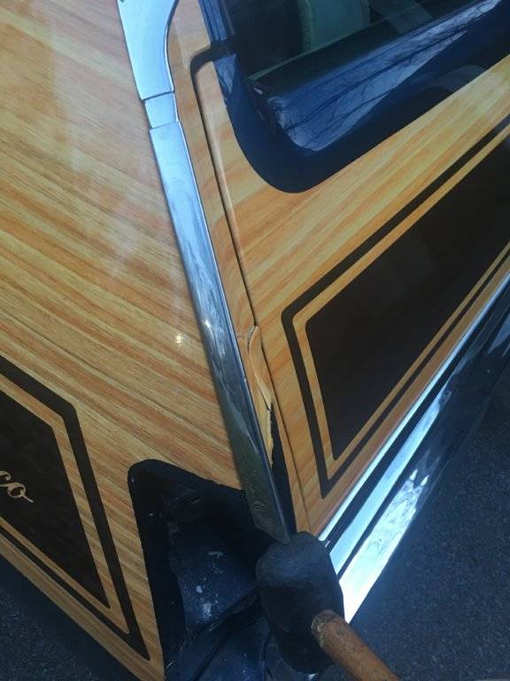

Cargo area window trim reinstalled, painted strip and stainless.
I chipped the paint in one spot. This isn’t one of those Facebook “everything is awesome” posts. This trim is not easy to install and if I was made of time I would have documented visually better.
While it is still fresh in my head I will record what, from my experience, seemed to be the best order of installation. “What worked for me”:
You have two painted strips per side, and two accompanying stainless strips. One set is near-vertical and the other is horizontal.
If installing, recommend you attach the near vertical paint strip first. Two stud-clips with 8/32 nuts attach it by poking into the C-pillar behind rear door. Then attach near vertical stainless strip. Use a rubber mallet to tap/clip it on. It helps to know how far up the strip it goes. That was what caused me to chip the paint (ugh). Tap the stainless with the mallet toward the front of the car. I think it helps to start at one end and work it on along the length of the strip. That technique -working along the edge - is essential when attaching the horizontal strip, which you do next.
The stud-clip rotates within the horizontal strip at the back of the car. Make sure it’s locked inside the strip before you start to screw on the nut or else you’ll go crazy not making any progress while turning the nut with a socket/driver. A good technique is to drop the tailgate and stand by the tail light while holding the ratchet/driver with one hand inside the car while using your other hand to press the trim against the car on the outside. Obviously the front end of the horizontal painted trim needs to tuck in to the near-vertical C-pillar painted trim FIRST.
Once the stud of horizontal painted trim piece is ALMOST snugged down, there is a trick - you have to tuck in the lower edge of the horizontal trim into a groove feature that runs along the rubber window gasket. Once you get it tucked in to that groove, finish tightening down the nut.
If you get this far successfully...hurray! You’ve done better than me with my trial and error methods.

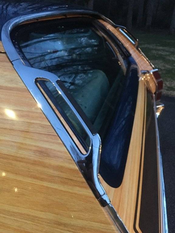

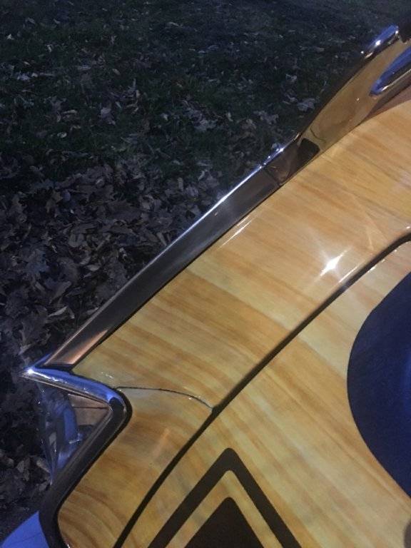

Next, take the last piece, the horizontal stainless trim, and put it in place starting at the C-pillar end/ toward front end of the car. There is an L-shaped gap-opening at the front end of that stainless piece that slips over the near vertical piece. I’ll post a photo. Once you’ve fit the gap piece end of the horizontal stainless strip over the top end of the near-vertical C-pillar stainless piece, attach that end to the horizontal painted metal strip by tapping it with a rubber mallet into the groove along with the metal trim piece, again using the technique of working it along the edge from one end of the trim to the other. By the time you get to the end of the now-conjoined trim pieces, it should all feel snug against the window seal. The technique of tapping with a rubber mallet is crucial. It shouldn’t feel like you are forcing it, it should be somewhat cooperative as you go. When it is snug and on there correctly, you’ll know it by feel: the rubber mallet will not be moving the pieces together anymore. You’ll just get a solid “Thunk” when you tap them.
The upper corner. Horizontal upper stainless piece goes on last, start here with downward facing “gap” piece covering end of near-vertical piece, to align and then attach it. Patience and a lot of hand-fitting go a long way with this. I can imagine some training must have been necessary at the assembly line when they brought a new worker in to do this job! “Technique”
