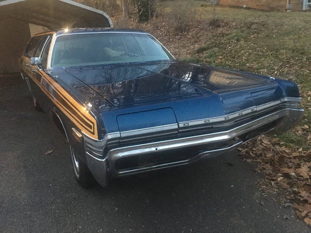

Cleaned up step bumper. I forgot to take a “before” photo tonight but had a previous pic.
Full view after attaching the new passenger mirror. Cleaned some dirt off the bumper, too. Happy New Year!
This car really needs a period correct Airstream behind it. Or towing a vintage restored wooden Chris Craft speed boat on a trailer. But, that would require I set up a “GoFundMe”, at this point...
The wagon just gets more and more beautiful as the trim and shiny bits go back on....more of these for Ya'....:thumbsup::thumbsup::thumbsup:
Thanks. Can’t wait to get it put back together. But I have to be patient, only so many hours at a time I can give to this project.
I am just afraid that every vehicle I have from now on is going to have to be this shade of blue.

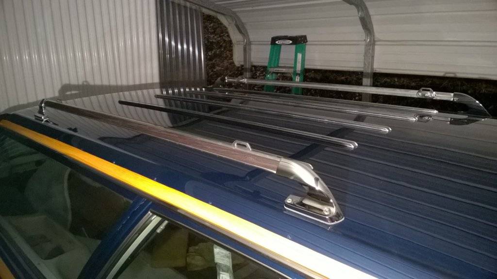

One other comment. I marked the black plastic pads that go under the chromed “feet” with LF, RF, RR, LR, for left front etc. I used a Sharpie marker. Probably didn’t have to do that but it helps ID things faster when doing re-assembly.
I used 3M Black weatherstrip adhesive to attach/seal the screws that bolt the “feet” to the body. I’ll check for leakage with a water hose before I acquire/install a headliner.
Not having a roof rack installed on this particular car is like an Elvis impersonator with no hair. It just doesn’t work. (Especially with the wood grain).

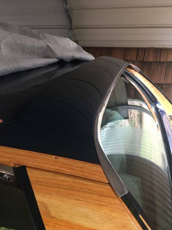

Re-installing the rear rain/air deflector. Been a long wait on this one! I had to take it back to the wrap shop because I missed getting the rectangular strips done.
Re-installing the rear water/air deflector. Been a long wait on this one! I had to take it back to the wrap shop because I missed getting the rectangular strips done.
PS Gotta give props to Mike and his team in metro Charlotte at Atlantic Wraps, they did the little strips on the end of the wing for free. They do good work.
