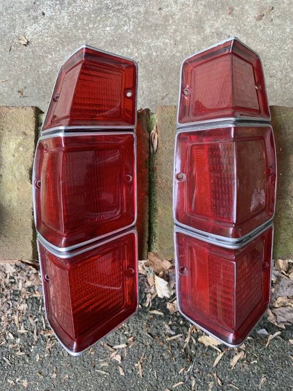

Touch up of the silver on the tail light lenses. Before on the right, after on the left. I think these are Polara lenses because they are not all silver, they have black bands between the silver.

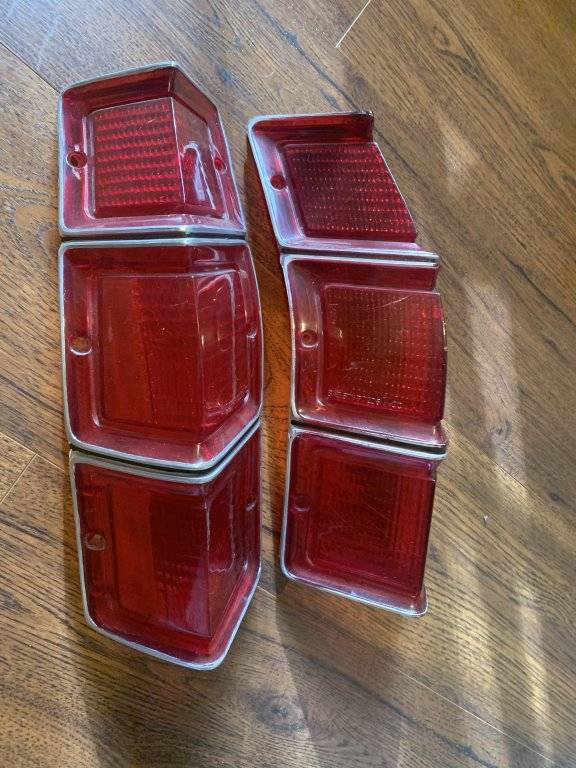

Replacing the drivers side taillight. The one currently in is “not bad”. I am replacing it with one “slightly better”. Have to paint the edges onto the replacement first, however.
Old (removed) on the right, newer donor on the left. The one on the right was just a bit faded.
Installed! While I had the lens off I cleaned the terminals and bulb contacts with a little steel wool. Things can get a little green over the winter.
Thats well made and now you have one for reserve. I also have a pair for reserve - you never know :)
Agreed. Small(-ish) cosmetic items, better to have a spare if you can find them now. Becoming more rare and more expensive, every passing day.

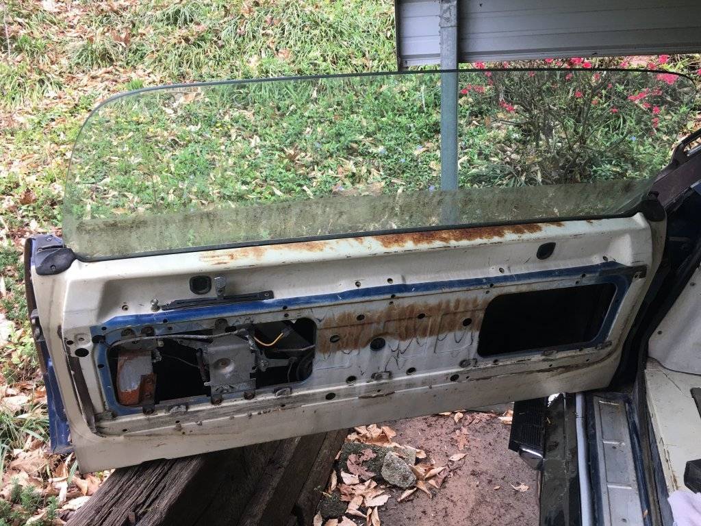

Today I got the tailgate glass up. Seems like a small thing, but the motor works, that is a relief! $$$ saved. With electrical power on the car, the switch does not cause the motor to work. Continuity, or lack thereof. So it could be the switch, breaker, or wiring. Not sure if there is a relay, that is a possibility also.
Im redoing a 69 300 convertible and time after time ive found one simple thing to do first for these electric motors and switches. Open them and use alcohol to clean contacts. I was looking for door switches, vent motors, etc and couldnt really afford the cost of used replacements. Ive fixed 4 switches, 5 motors, and 2 door solenoids, saving me thousands.
