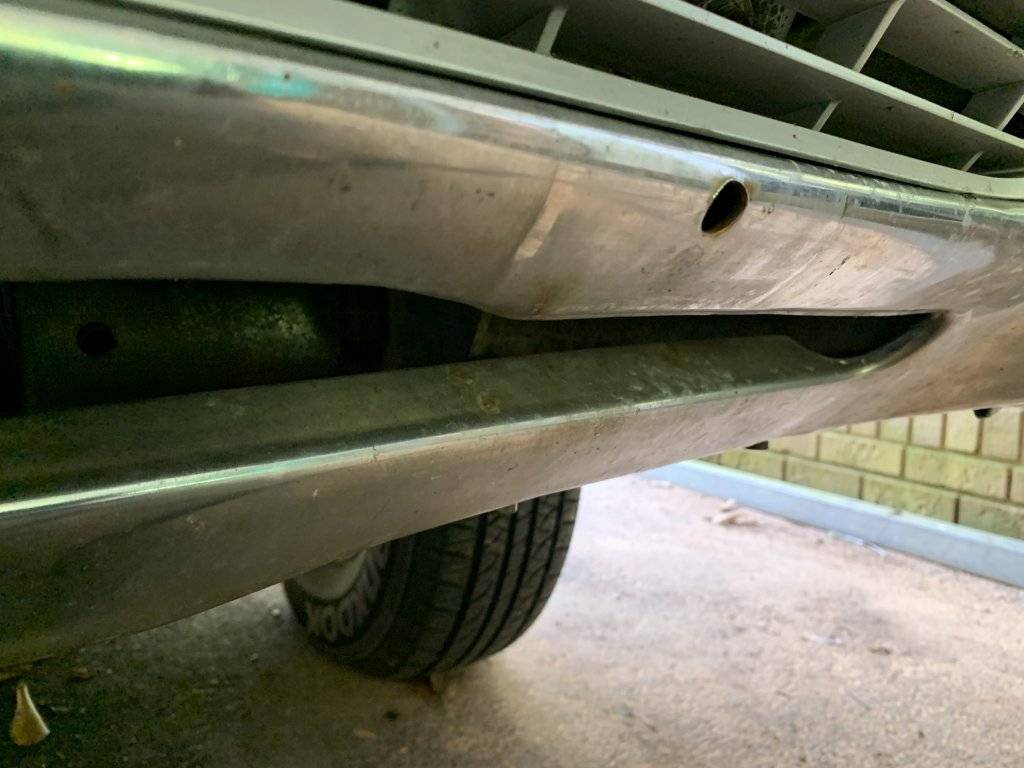

Not sure if your front bumper is tweaked or out of alignment, but there's only a couple bolts on each framerail to loosen if it's merely misadjusted. It helps to have a friend around when you do, that bugger is heavy!
Paul…

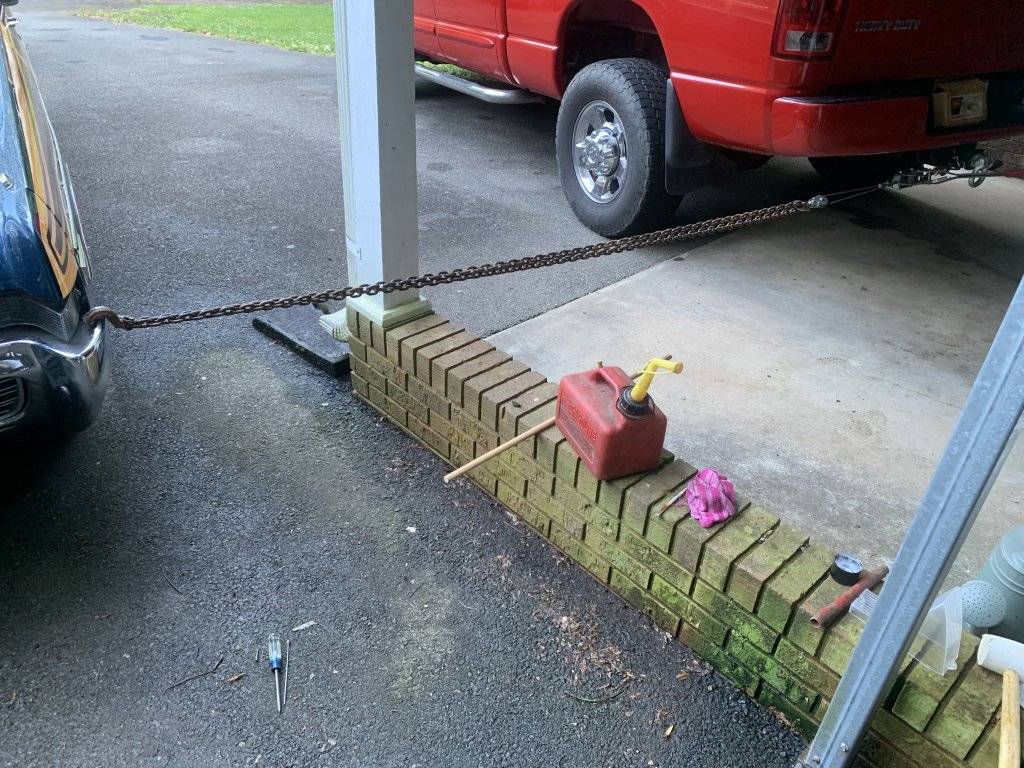

It’s been a long time since you wrote the note asking about the bumper…
I took some action…

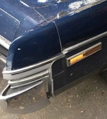

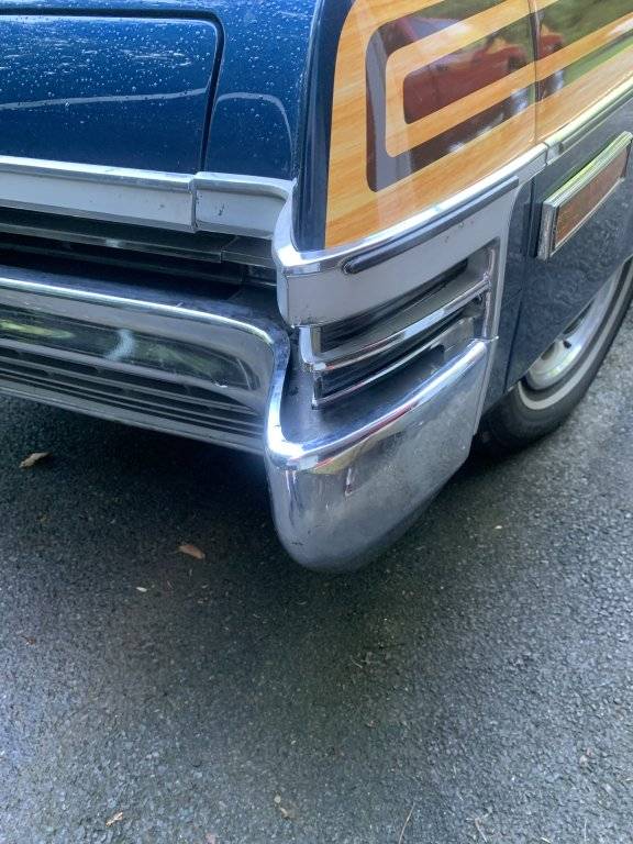

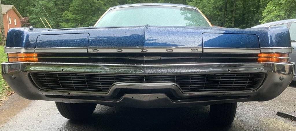

I used a come-along and put some tension on the end of that bumper. I think it looks better now…it was definitely…tense…on my part. I probably should have been standing behind a wall or something. Glad the chain didn’t fly off.
See the new photos from today. Pleased with the results. “Kids don’t try this at home.”
Wait. This is a bit better comparison. Forgot I took a “before” photo today…

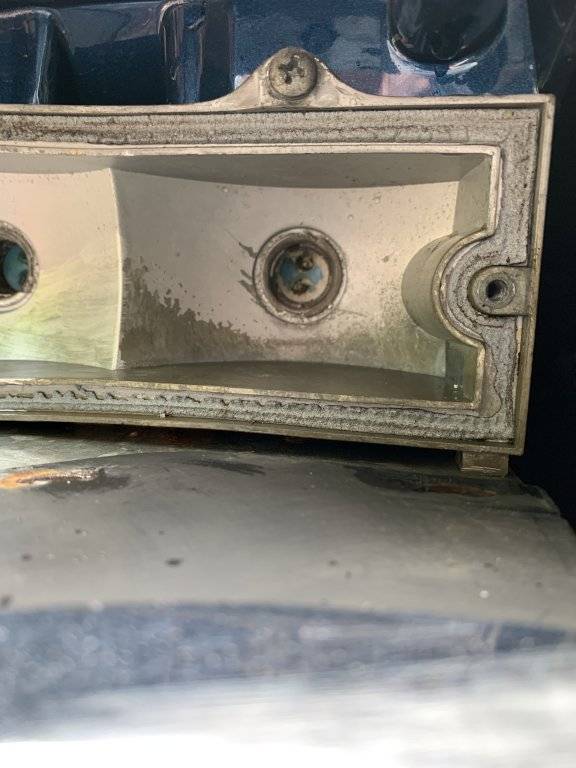

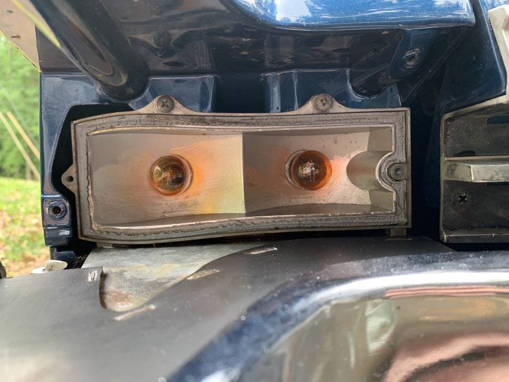

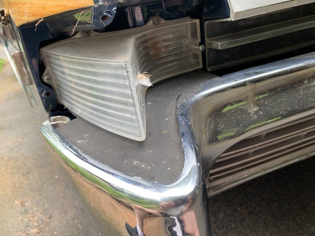

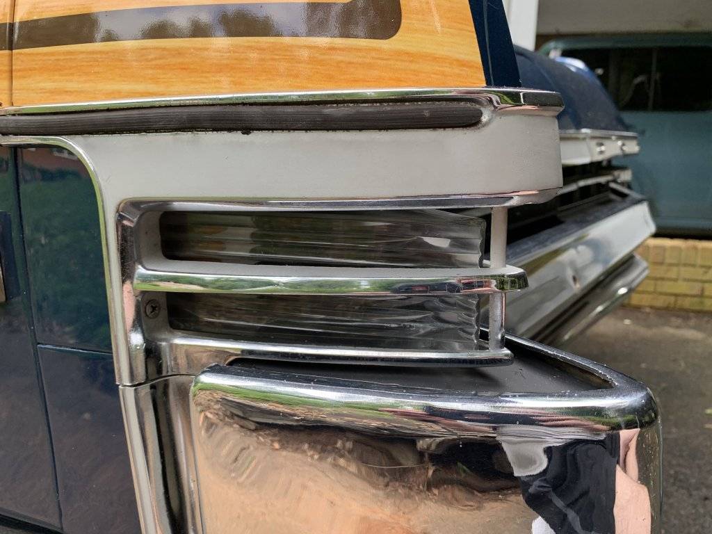

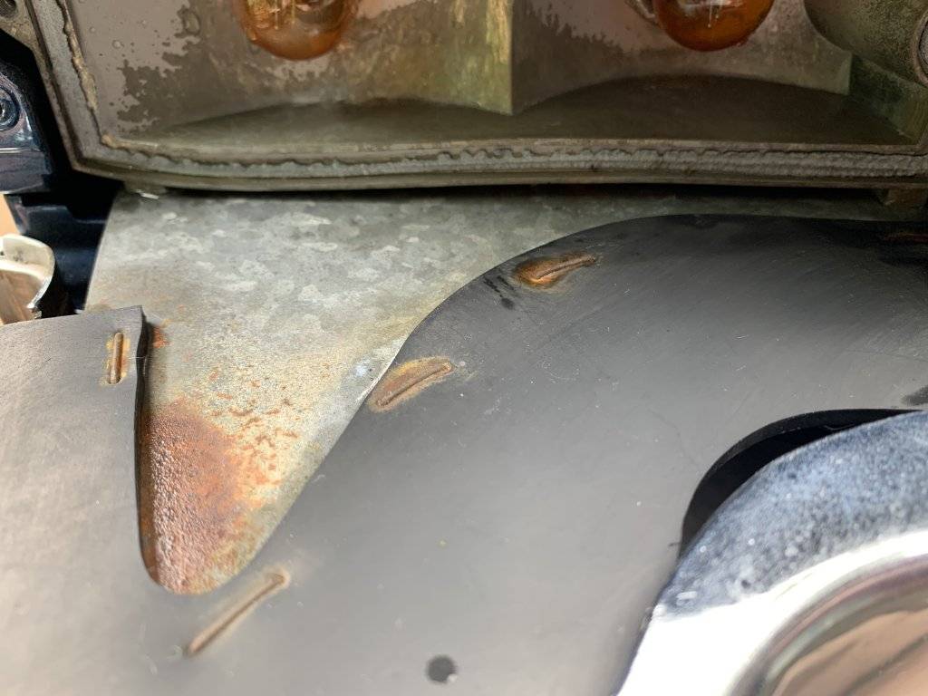

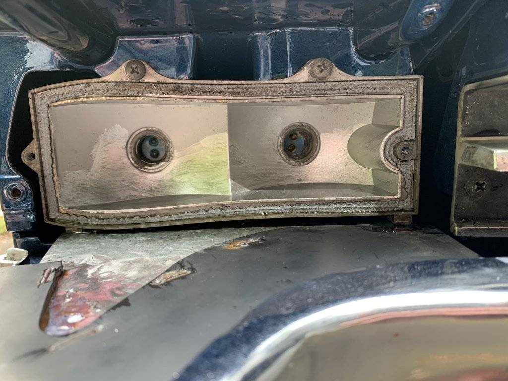

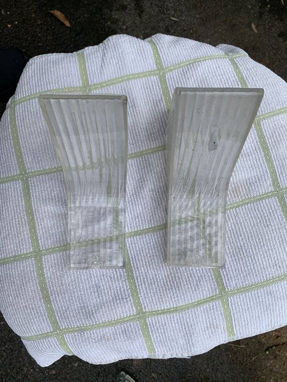

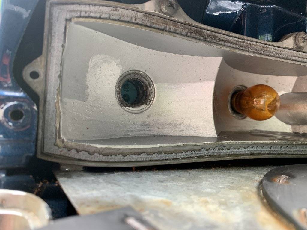

Replaced both front parking light lenses today. Started on passenger side. Take out three screws from the bezel…
Old lens wasn’t too bad, just a little milky. Cleaned up a little surface rust on the galvanized part, took out the bulbs and cleaned out a little corrosion with a toothpick…did some touch up silver paint on the internal reflector…

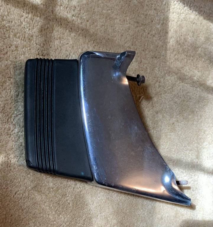

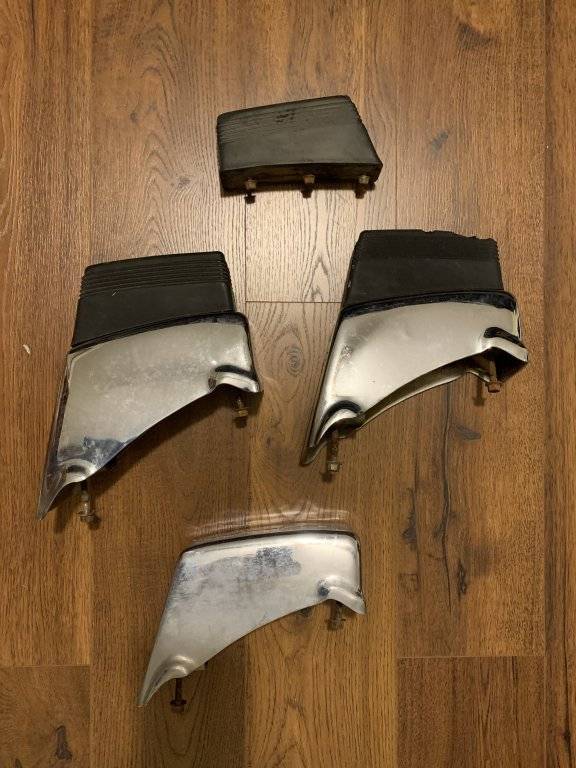

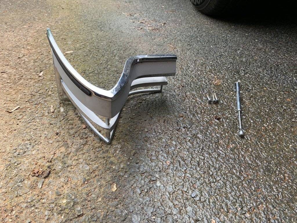

I got the bumper guards out of the attic. Going to have to do some mix and match with the (1) replacement pad I got. And some cleaning…

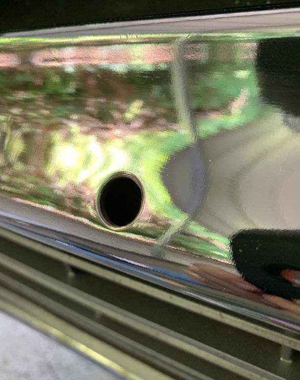

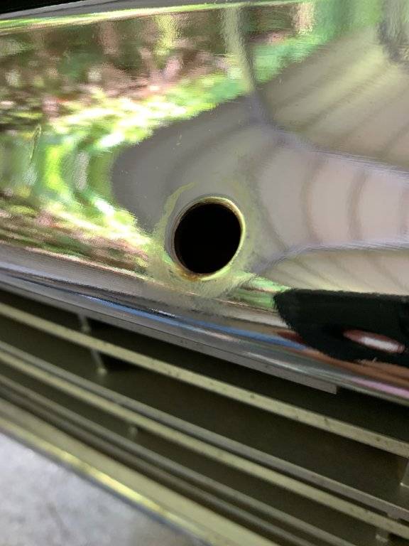

A little chrome polish on the salvage yard chrome part. And some glycerine on the salvage yard black rubber part, to soften and shine it up.
The bumper. Amazes me how grungy it gets just sitting in the carport, as little as I drive it (seasonally). Where do the bug splatters come from, etc.
Kicking’ it old school with chrome polish, #0000 steel wool (thanks for the tip, Manny!), and Tar & Bug remover.
