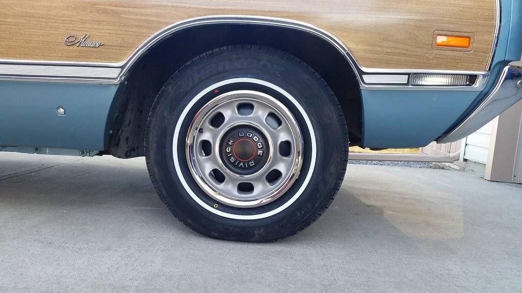

So that's interesting. I didn't realize those were hubcaps! Thought they were actual wheels, from the first photos. The style is nice. How much do you want for them? Is it possible to send them off some place to get refinished? I have to keep things in perspective on my end... am trying to focus my budget on "roadworthiness" items right now, frankly.
Yes, they can be restored. The one's on my wagon were done, and the previous owner indicated it was around $200/cover in CA. It is a 3 piece unit, the centre dish, the cast section with the holes, and then the stainless ring. Darn things must weigh near 10 pounds each.
