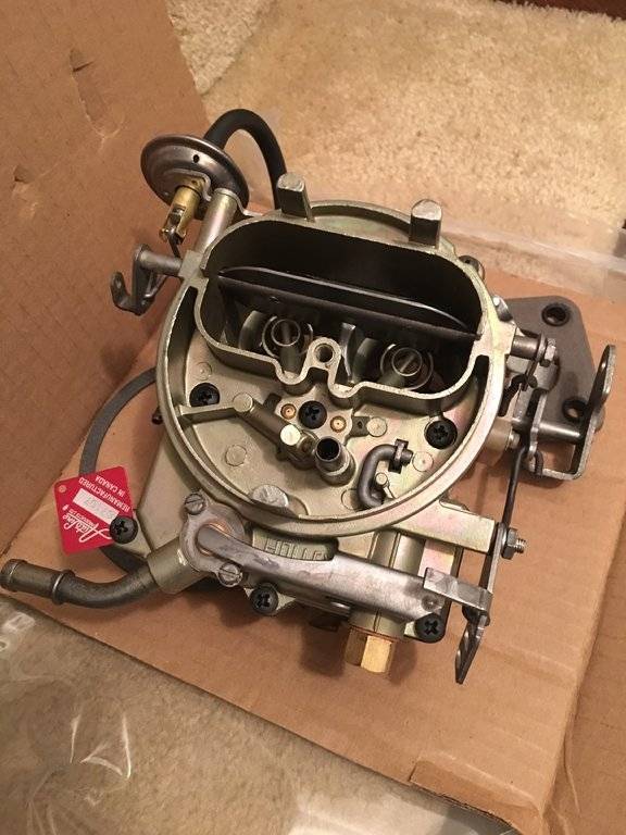

It arrived. Was surprised to see it actually is a Holley. The ad on Rock Auto listed a Rochester as what they would give as a replacement, for a 73 Monaco. Still not sure I want to give back my old Holley for the core. But I would like to apply that $65 core fee elsewhere. Not like I have a numbers matching 'Cuda.
It looks good. Clean. New-ish.

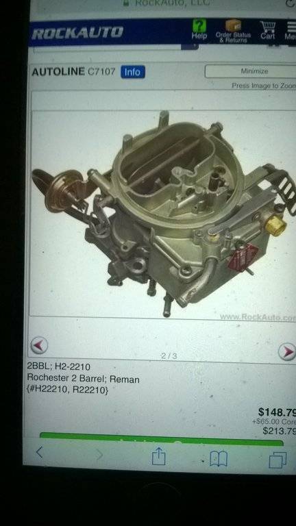

I do not understand why you have been thinking you would be getting a Rochester brand? I could never find that brand in Rock Auto's list, nor do I recall Chrysler using that brand very often, if ever on a 360?
Especially do not tighten the wingnut on top the air cleaner any more than necessary to keep it in place. If the air cleaner is on the verge of rattling, you have it about right.
The listing said Rochester on Rock Auto's site, when I looked. I'll see if I can make a screen snip and post it. I knew my carb was a Holley, but didn't know enough about what a Rochester looked like to know any better, when looking at the carb on their site. It looks similar but a bit different than mine. The large metal tube in the front on theirs is not present on mine. Presumably that is for the carbon canister. Also, their replacement carb has an exposed lever running left to right over top the carb, covering the word "Holley". Mine does not. I assume there were just minor variations of the same general design over the years, changes made for ease of manufacturing, cost savings, emissions improvement, etc. Frankly the carb I am taking off looks slightly cheaper.
Yes... I know enough about carbs to know Rochester was a GM part, and who among the Big Three would want to buy 'the other guy's' parts? But I am sure it happened. If there was a business case, Engineering, Accounting, Marketing, Sales planets all aligned... I believe GM supplied power steering and or tilt/telescoping steering wheels to different makers. AMC had no shame in using FoMoCo parts, on the CJ, etc. I bet to be a carb supplier was to get beat up for cost constantly....commoditization.
But yes sir it is a Holley they sent. Why their listing says Rochester I do not know. Web designer ignorance meets customer ignorance. Nonetheless I got what I needed!

Looks like the same one I got. I think it will make a great difference. you don't have to tighten the carb bolts and nuts too hard. You don't want to warp the base.
Dave
Thanks Dave. I need to find out torque spec and use my torque wrench.

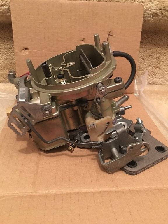

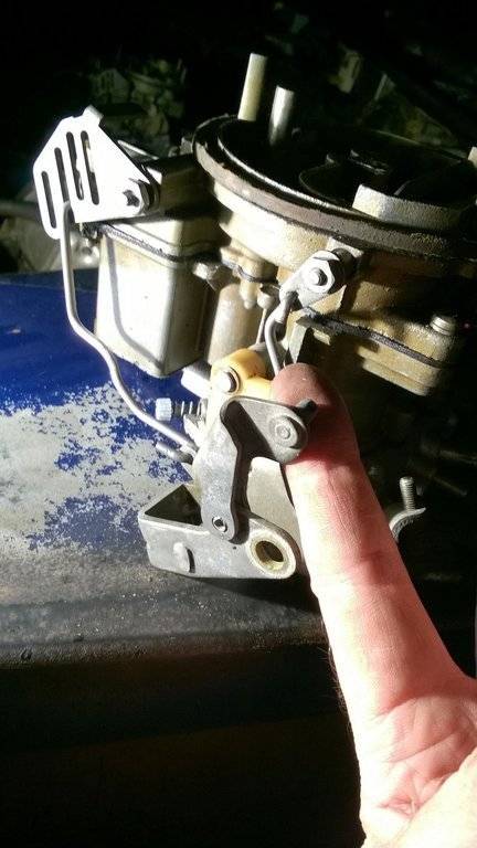

Autoline Holley did not include the lever shown so I had to scavenge it from my old one.
Got the Autoline rebuild and installed it. Waiting for time to replace fuel pump and filter. Took old carb out and it was full of fuel and spraying ok, but when I unhooked the fuel line from carb it was dry as a bone. I'm baffled.Must be a blockage somewhere in the line.
That link is an optional one and used only on cars equipped with speed control.

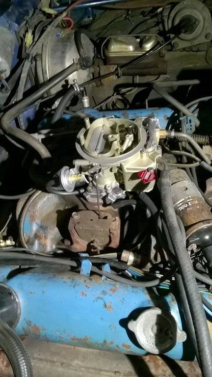

Re-man Autoline carb installed. New Delphi fuel pump installed. New clear fuel filter installed. Car starts and runs. Acceleration seems a bit flatter than with previous carb, maybe a timing/tuning issue? But bigger issues are this:
1) After 24 hours since running, the fuel filter gets empty of fuel. Apparently it drains back to the tank? Does it need some kind of one way check valve to prevent that?
2) Once I get it running, it has same problem as before, I have to really give it a lot of gas (push on accelerator pedal and raise up rpm) in order for the car to go up hill. Tranny slipping, or...? Solution?
Its hard to tell what is going on without actually being there in person. I guess you have to go over everything from the start til you find the problem. Sorry I couldn't be of more help.
