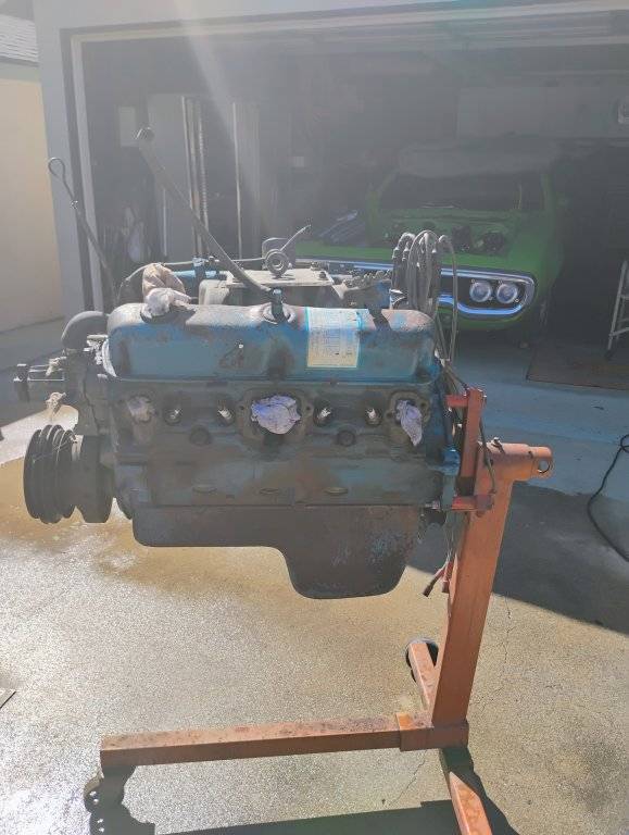

Hey guys I recently pulled a running 360la out of a motorhome has 50,000 miles on it. So my plan is to do a mild rebuild on it to swap into my 66 fury III daily driver I plan on later doing full rebuild around a year from now once I stock pile some parts. Ok so I've been looking online trying to find the engine specs(horsepower/torque) but can't find any info. It has a Edelbrock performer intake and 4bbl Carter AFB carb on it, I pulled it out of a 76 tradesman but the block casting year says 75 any info you guys can provide will be appreciated.
Block casting dates can pre-date the model year of the vehicle, if the vehicle was an early-in-the-model year produced vehicle.
In your case, the actual specs of the motor would be for a 3/4 or 1-ton van chassis of that model year. Probably the same specs as a D200 pickup, I suspect. Which also probably means the same cam and CR as the low compression car engines of the time.
In the Chrysler world, "Motorhome" means something from the days of Travco and similar motorhome chassis vehicles, which then relates to some more-HD than normal 440s. BTAIM
The vehicle probably had the "car" style ThermoQuad 4bbl and the matching cast iron intake manifold. The current manifold and carb you mention are probably there for a reason OTHER than better power production. End result is that power should be the same as the as-produced motor, most likely.
It is very possible that you will need some 1967 LA mounts for your car? As Chrysler changed styles in about 1972 or so, so your van-chassis mounts are most probably the later style.
Aim for something in the spec range of the 360HP cam. The current carb and intake manifold will be fine. Hopefully you got the electronic ignition items from the donor vehicle?

I pulled the wiring harness and everything it was hooked to it as the guy was going to scrap the motorhome. I've read online that I can use the engine mounts for the 318 poly In my car just have to use washer and spacers to compensate for the difference. When the time comes hopefully that is so because I don't really want to buy a set from schumacher. I already bought a centersump oil pan kit from mancini racing. Ok so from what you've said the horsepower is probably like 240? I'm just trying to figure out if I should go through with a stroker kit when I do full rebuild cause I'm aiming for around 350 to 400 HP build.

The engine shown with a 12-17-75 block casting date is a 1976 model year engine. Within the motor home and other chassis builder industries, the finished product model year can be even later, but the Chrysler assigned model year for the engine should be 1976. The sticker on the valve cover, if original and still legible, should provide some additional detail for tune up settings, emissions, etc.
The engine build information is on the front left of the block right below the cylinder head. It will be similar to the following example:
6M 360 5270 1234
Where:
- 6 is the model year, 1976
- M is the build plant, Mound Road
- 360 is the engine size
- 5270 is the build date, in this case January 1, 1976
- 1234 is the sequence number for the engines built that day.
1975 and 1976 truck/van/chassis 360 engines were available in two versions, 360-1 (light duty), 360-3 (heavy duty). Both 360s were only available with two barrel carburetors originally. Holley model 2210 was used on 360-1 Federal and Canada applications. Holley 2245 was used on California 360-1 and all 360-3 applications.
General specifications for these 360 engines include the following:
Horsepower = 175 (net) @4000RPM
Torque = 285 (net) @2400RPM
Compression ratio: 8.4:1 (360-1), 7.9:1 (360-3)
Hydraulic tappets
Camshaft intake valve lift: 0.410", Duration: 252
Camshaft exhaust valve lift: 0.400" . Duration: 256
Head castings: 4006337 or 3769974
Intake valve size: 1.88"
Exhaust valve size: 1.60" (exhaust valves have rotators)
Timing gear/chain: 360-1 is nylon/single, 360-3 is double roller
These specifications are for the original equipment.
