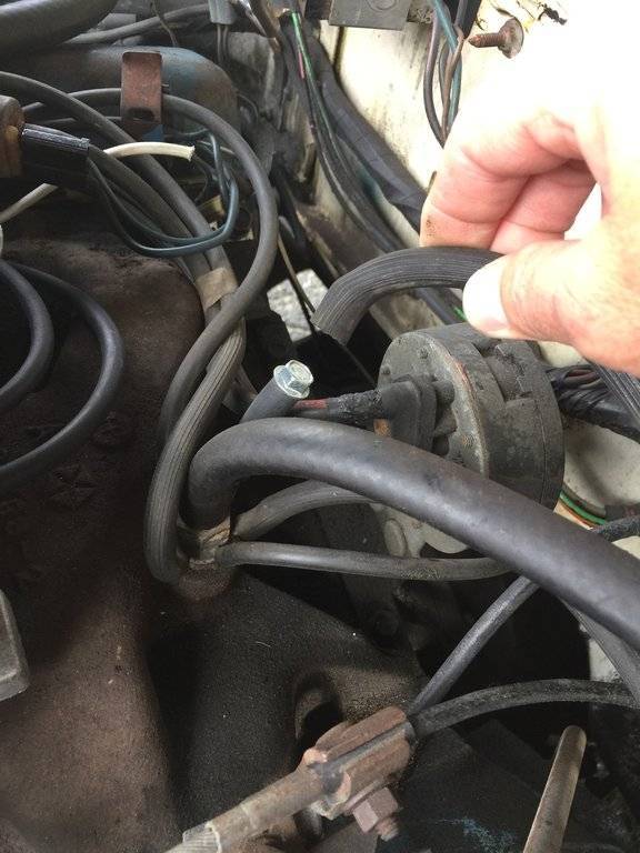

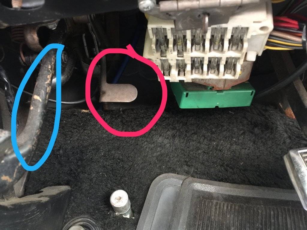

Stan's the MAN!!! My 75 had the same issue, Stan recommended I disconnected the vacuum line to the Ebrake release! Which is under the hood behind the Carb.. And VWALA!!!! No more whistles.. and you can still manually release the Ebrake by foot.. (Note) be very careful when releasing the Ebrake manually using your foot! That release is right next to your fuse box under the dash. One slip of the foot and your fuse box is on the floor.. FYI no Bueno!!!!!
I'll take a picture of mine and post it if you'd like, I would guess they're in the same position between 75 and 76.
Here ya go.. the RED circle is the Manual Brake release..next to your fuse box.. Please be careful when releasing it!!!! I use my hand just to be safe, and the BLUE is the Ebrake peddle as a location reference, The other pic is where MY vacuum line for that brake release WAS connected. I found it easier to disconnect under the hood, (right behind the carburetor on the manifold) vice under the dash. My car is a 75, yours is the 76, I'm not sure if it's in the same location, but at least the pictures will give you an idea of what to look for. Hope this helps, keep us posted.
