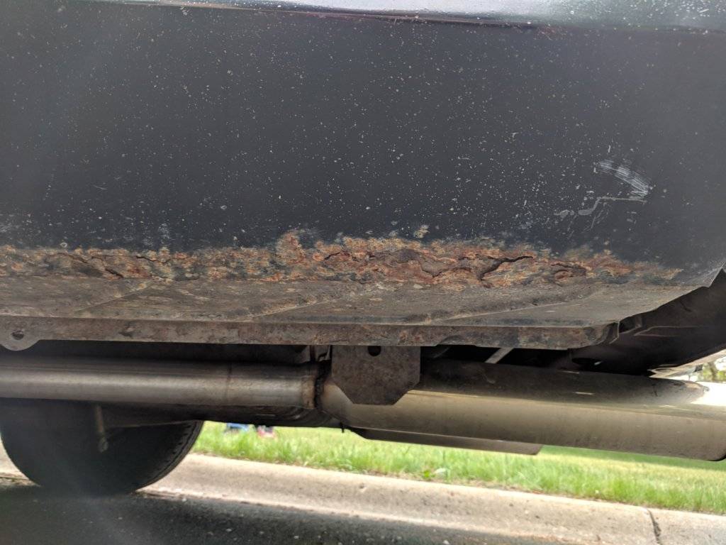

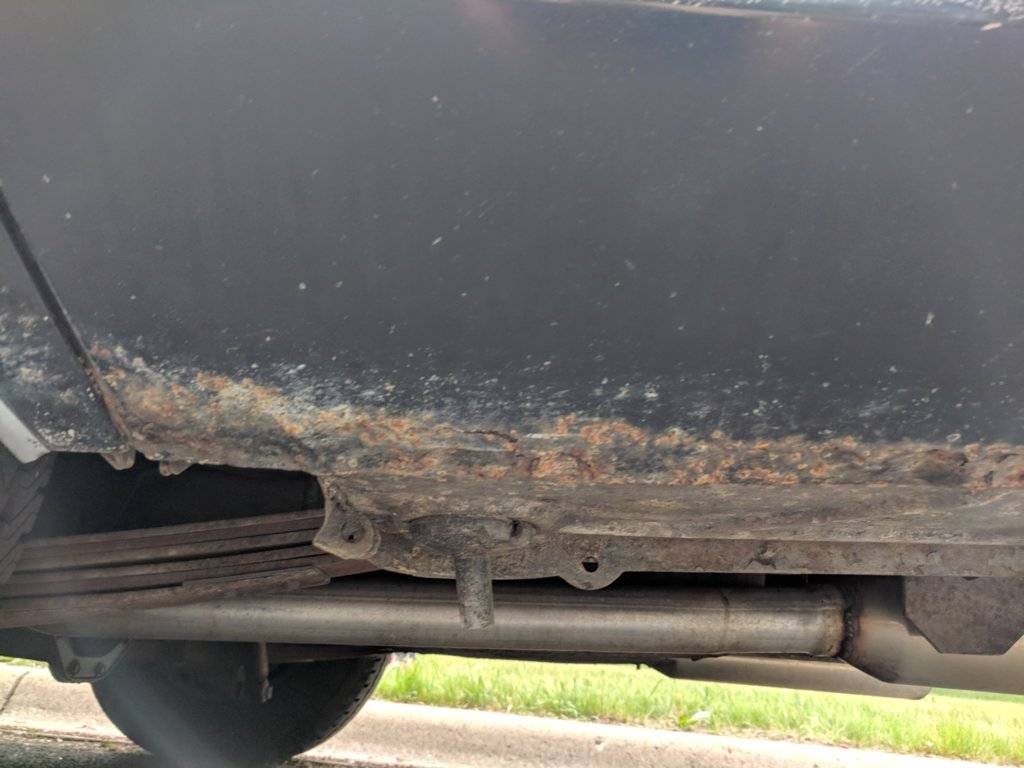

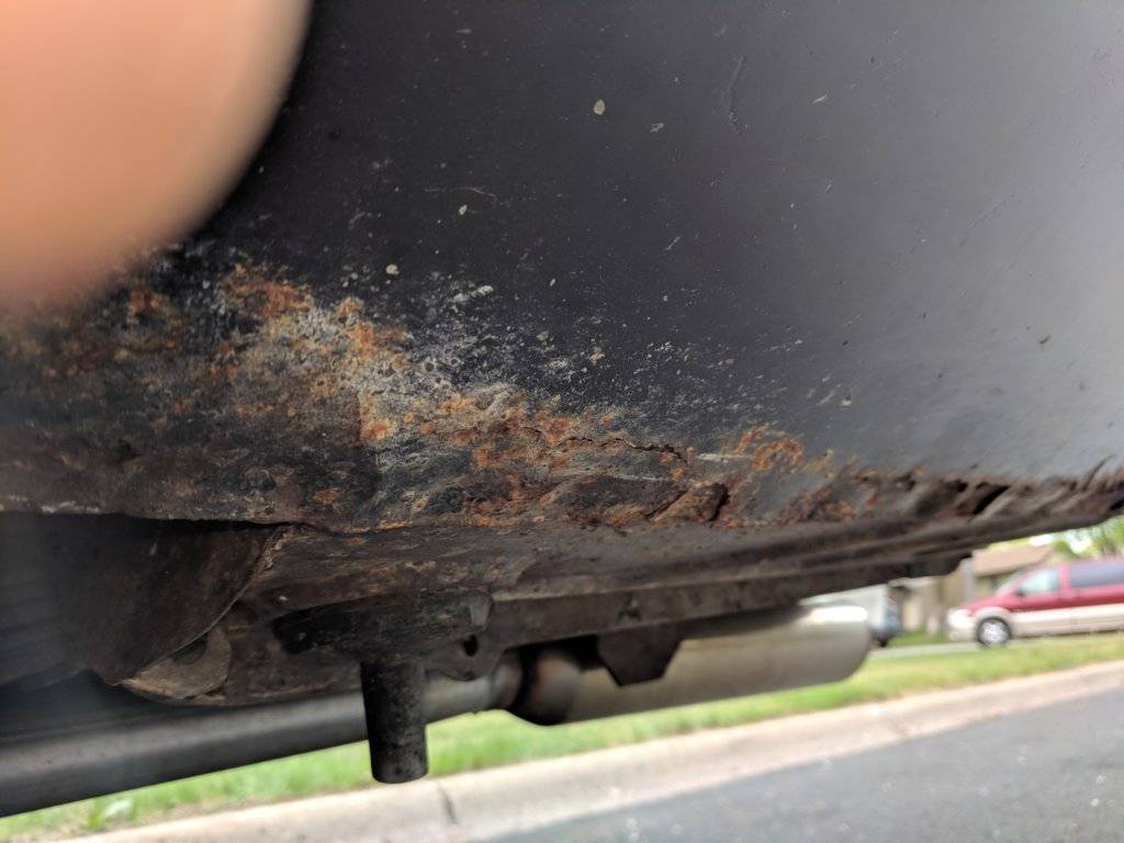

LocuMob (youre the best man - thanks) did me a great favor and checked out this New Yorker. End of the day, it was less original (a few high-performance mods) than I wanted, and had more "project-like" issues than I was looking for.

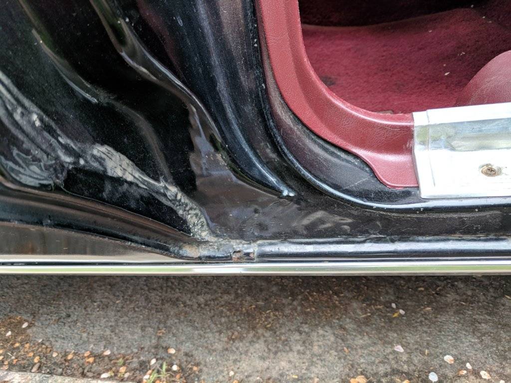

It was a clean, solid car ..mostly (driver-side low is where the body issues were, quarterpanel low where commando1 suspected - good call) .. and definitely NOT a basket case.
Again, no dissin' the seller or the car ..BUT while NOT a "diamond in the rough", it was more like a "cubic zirconia that needs a lotta polishing".

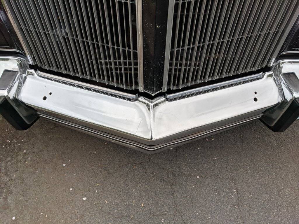

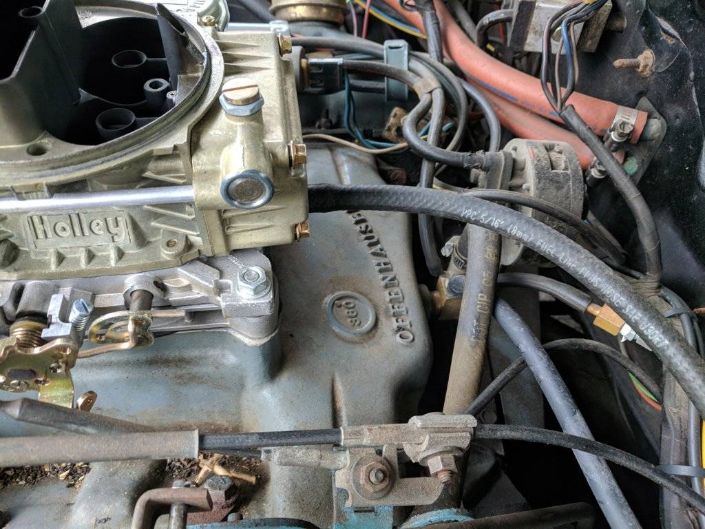

It had a 3:55 gear (seller explained the 2:71 gear in trunk was a spare .. that made no sense so he didnt know that was the ORIGINAL gear?), engine was strong and had build documentation, but as UNoriginal as it could be, spray bombed pass quarter, assorted dings all around of the pesky kind, pretty but ruined front bumper, driver side rust low, and curiously misplaced "fender tags".
i repeat car was NOT a basket case .. but had I bought it sight unseen i woulda been pissed. Seller just didnt represent this car properly, had every chance to, but finally LocuMob had to go see it to help me erase ALL the curiousities/omissions about it.
My offer would have been $2200, to max $2500 - no kidding, I did NOT make any offer at all though given seller wanted $4000.. I give seller benefit of doubt (seemed like a nice guy) he did NOT intend to mislead .. just inexperienced maybe?

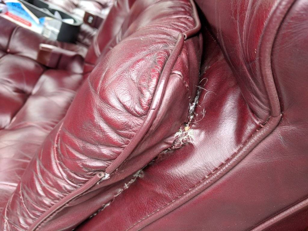

That is the typical condition of these cars. It would take $10k-$20k to restore this one. If the rear quarters are that rusted there is rust under the vinyl, under the rockers, under the side trim, the cowl has some rust issues. There is no saving of that leather....its done. Plus I'm sure there are door panel, dash pad, sail panel issues too. Best bet is to find a low mileage rust free car out west for $5k-$8k and be done with it.
BTW, there are zero parts being repopped for these cars so it is getting almost impossible to find a donor car that has anything interior wise in better condition than we see here.
