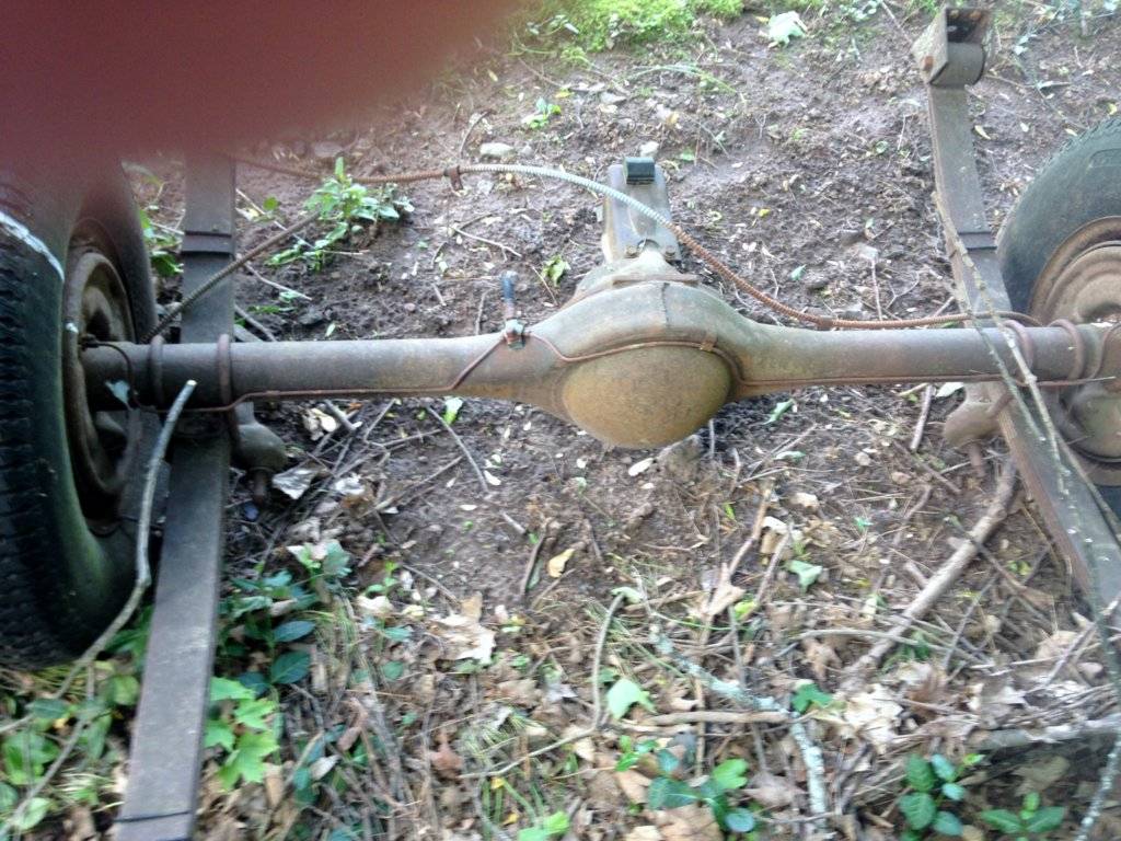

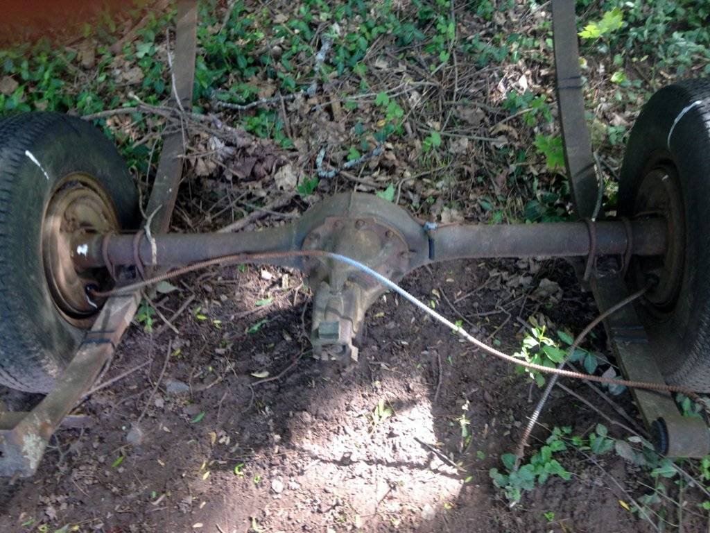

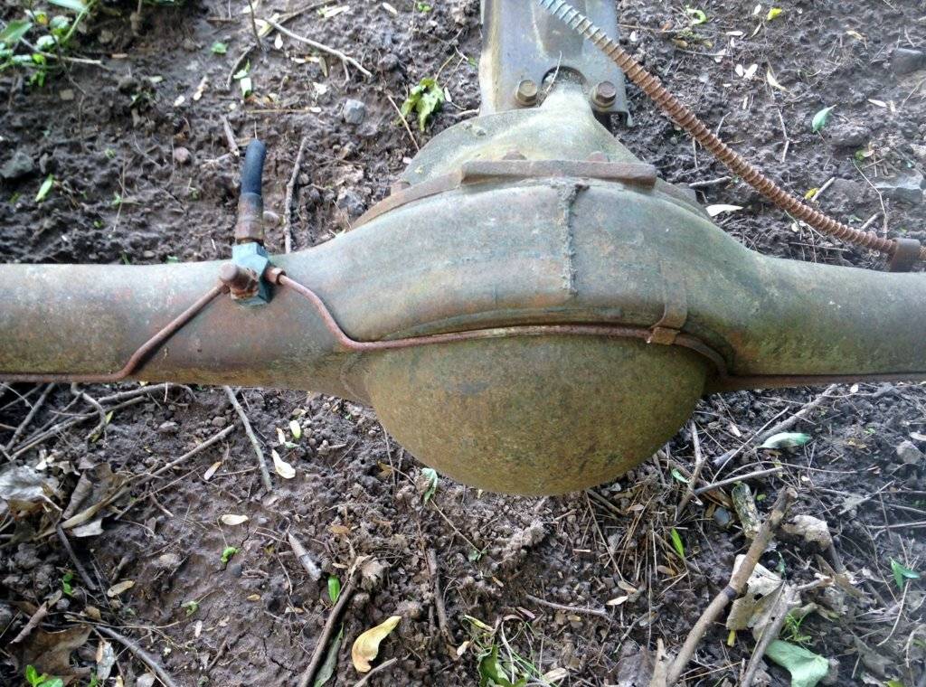

Anthony, I have a complete 8 3/4 rear end out of a '68 Fury. Come up to Connecticut with a truck and a $100 and take it away. It has a 2.76 gear but I also have an open "carrier" with a 3.23 gear that I am looking to sell.
