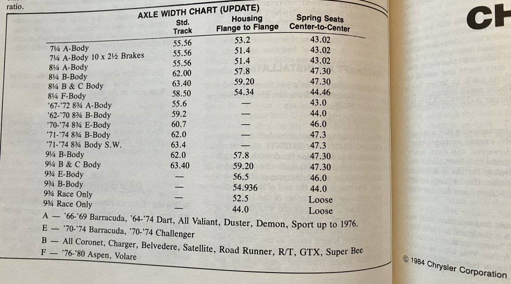

Are all 69-73 C-body 8 3/4 housings the same flange to flange, and spring center widths? I recall reading the 72 Fury axle housing flange distance was widened but may be misremembering this. DC chassis book does not mention c-body 8 3/4. Thanks.
