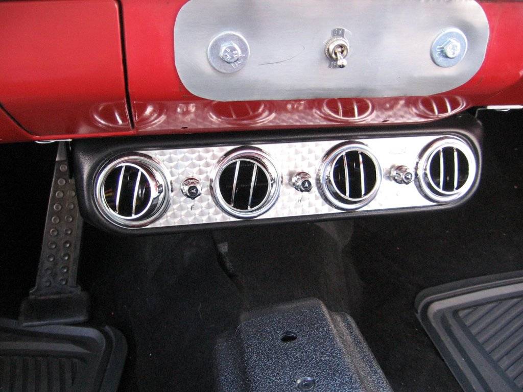

I just put air in my 63 Belvedere beater. Got it from Speedway Motors, Vintage Air .
With engine brackets out sourced from another vendor the cost was about $1400 all done.
Mine was heat and air. Air alone would cost less.Works great in Nevada's 100* + weather.
