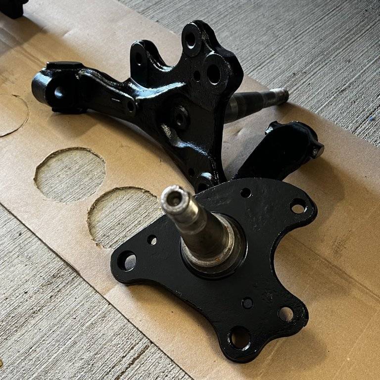

I’ve been working on mostly the mechanical parts of the car so we can get close to putting the motor back in. Currently I’m re-working the front end because as you might recall, I’m upgrading from drums to discs !
Break components came from Chris Sherman, so thankful he was able to give me a great deal on the setup!!!

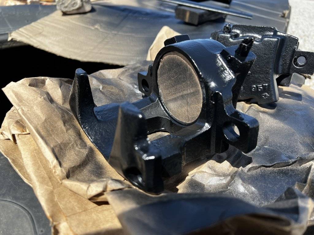

Along with the theme of my frame / various components - I went ahead and prepped and painted everything satin black.

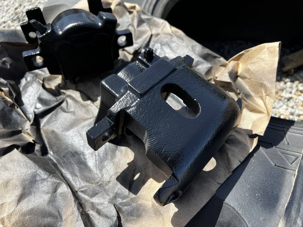

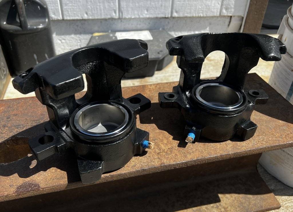

Painted these calipers yesterday, but when I lifted them off the cardboard I had them resting on - the cardboard stuck to the paint! So I scuffed them down and re-painted them today. Wasn’t much work. Going to be putting new pistons, seals and bushings for these.
Metal coat hanger or bailing wire are your friend when painting things like this. Nice work!
I did use that for some of the lighter components!!! But I could only paint outside and it was windy so I had to wait for the wind to die down and then go paint :lol:

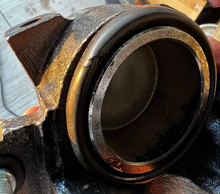

Spent today fine tuning and detailing my brake system. I had been waiting on new pistons, seals and boots for the calipers. I wasn’t about to spend $$$$ to send them out for something so simple. Took me a little bit to try and get the seal to set just right, but I FINALLY got it to go in.
Calipers are a bit sticky now from the AGS Sil-glyde I used to lube the seals and piston with… that stuff gets everywhere! Was real careful that no dirt got stuck to the piston.
Here’s the caliper before. Had a little tear in the dust boot. Figured that with the attention to detail im giving the rest of the car, I might as well clean and rebuild these too.

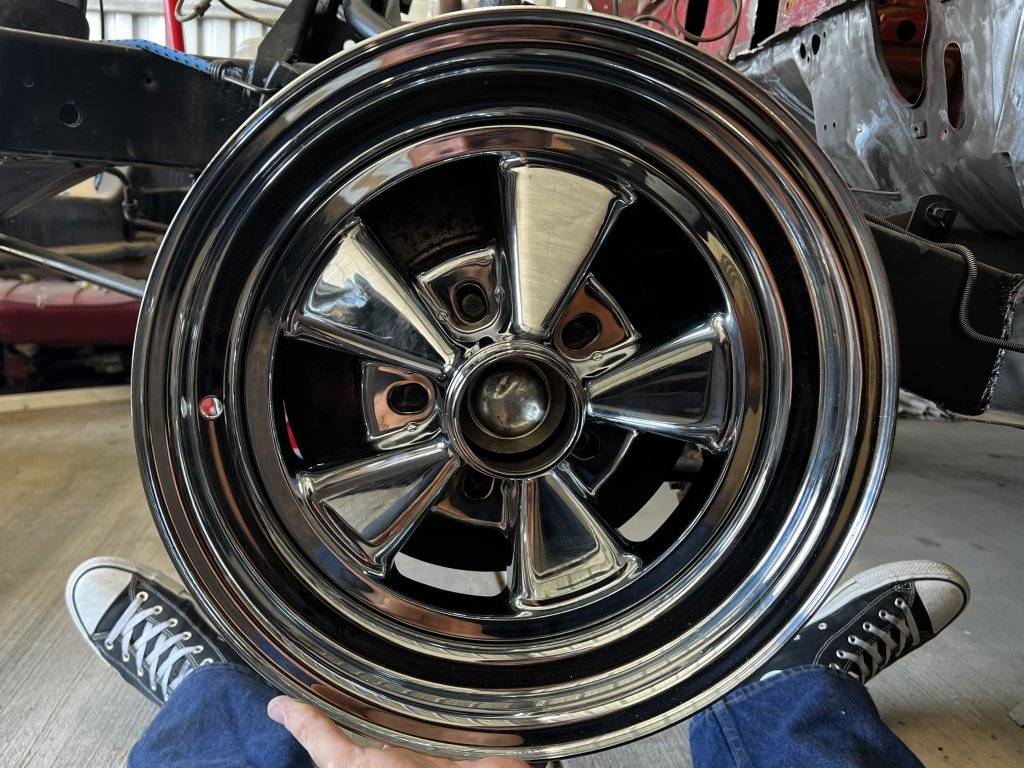

Brake rotors are new, just light surface rust from sitting! I didn’t take pics, but I masked off the contact area of the rotor and painted the raised “hub” area and around the studs. This is so when my Cragar SS wheels are on, you won’t be seeing rust. Can’t stand it! Instead it’s a clean semi gloss black. I’ll take pics when I get back to the car …
15” Cragars were a great fit!!! Took everything apart again for fine tuning like I said. This was before I painted the rotor. The frame has been sitting a long time, so I’m going to give that a nice detail before I assemble everything once again.
Are those slotted mags?
I have slotted mags and they are not the easiest to put on. 4 bolts are good and the 5th is a REAL pain on each of them ...
5 spokes always remind me of a Hot Wheels car - I love them!
They are indeed slotted! A real pain, especially with those dumb oblong washers LOL. It takes me a while to get them on and off! It seems there's a bit of a trick to getting 'em on just right. I would really love a pair of true vintage '70s Rocket racing wheels. 5 spoke design. SO hard to find especially in 15x7

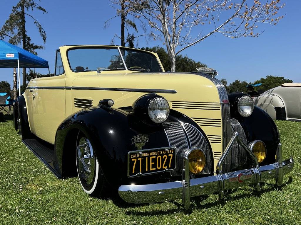

Beautiful and rare 1939 Pontiac

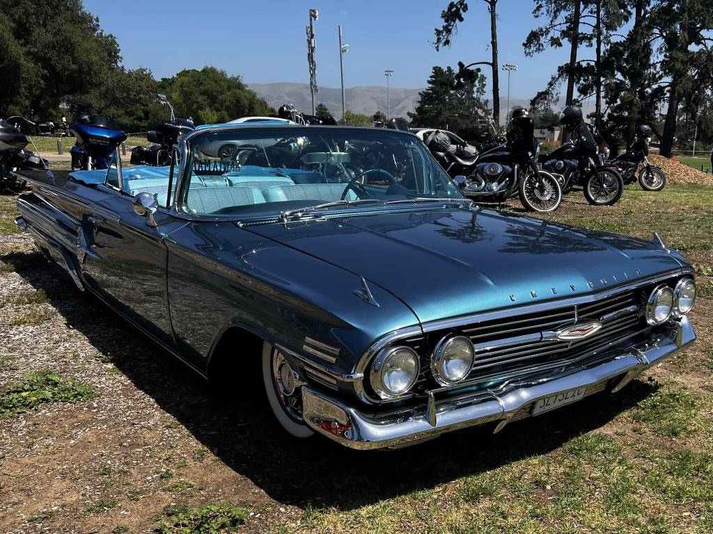

That blue Chevy convertible is gorgeous.

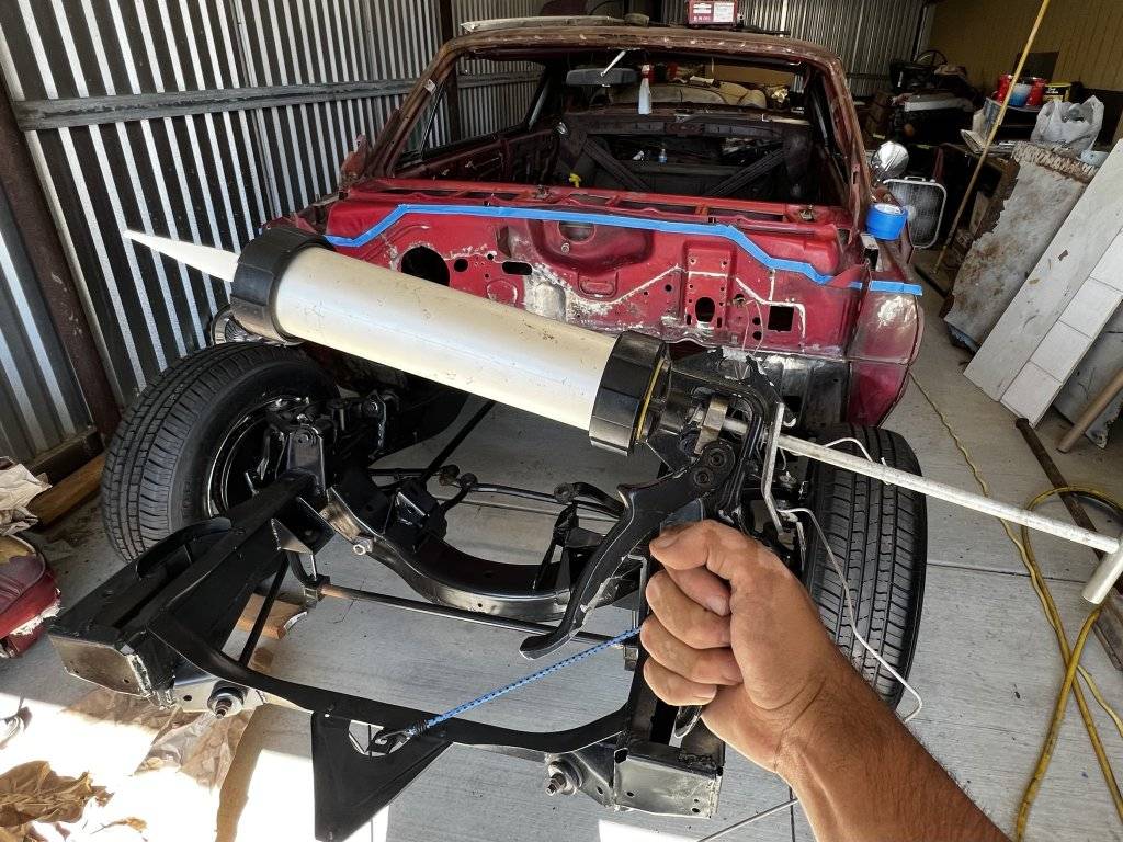

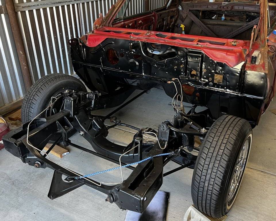

It’s been a while since I’ve posted on this thread! I do apologize, life keeps getting in the way of me and this car. I don’t live with this car, as it lives in the next town over on my friend’s 1 acre property. Aside from a crazy work schedule and balancing other things, I try and get to the car as much as I can! Where I work, the schedule is not static, always dynamic. One week I work graveyards, the next will be day time and the other will be the swing shift. Another thing that can be tiring is getting scheduled 7+ days in a row but on 2 separate pay periods …

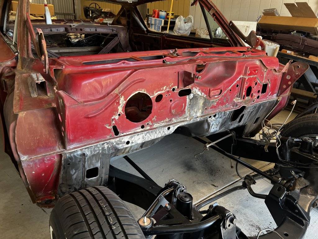

Needless to say, I’ve been able to make the best of my time with this car lately. We have been buttoning up the floor patch work. It is not pretty by ANY degree, but this isn’t a points restoration. It’s my first time really welding and after the undercarriage is coated with undercoating, and the inside is painted black with POR-15, layered with dynamat and carpet - no one will ever know!
Painting the interior will come soon. For now we are focused on getting it RUNNING. Keep in mind, I’ve had it for 2 and a half years and I’ve never once heard it run. To our knowledge, this thing hasn’t ran since late 1979 to early 1980. I’ve gone through many many different ideas for how to do the engine compartment to this car - but in the end, I settled with flat black.

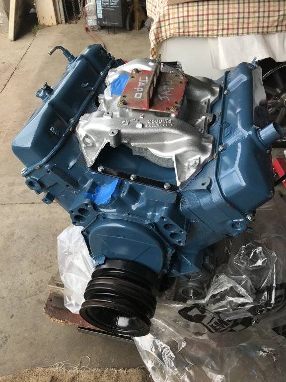

A reminder of the 440’s progress. It was rebuilt last February, I still haven’t taken it out from it’s wraps.
I have Cal Custom style finned valve covers for this motor. I plan to polish them up real good, and a matching air cleaner! John Watanabe of Touch of Style cc rebuilt this motor for me. Machine work done in Oxnard by a shop whose name I don’t recall at the moment. John (who also goes by Japo, a spanish nickname) is the son of a local drag racing legend. He’s been around cars his whole life. He grew into lowriders but is still a drag racer at heart!
I want to paint the engine a light metallic blue color, I believe that with the polished aluminum / chrome look - it will be absolutely gorgeous!

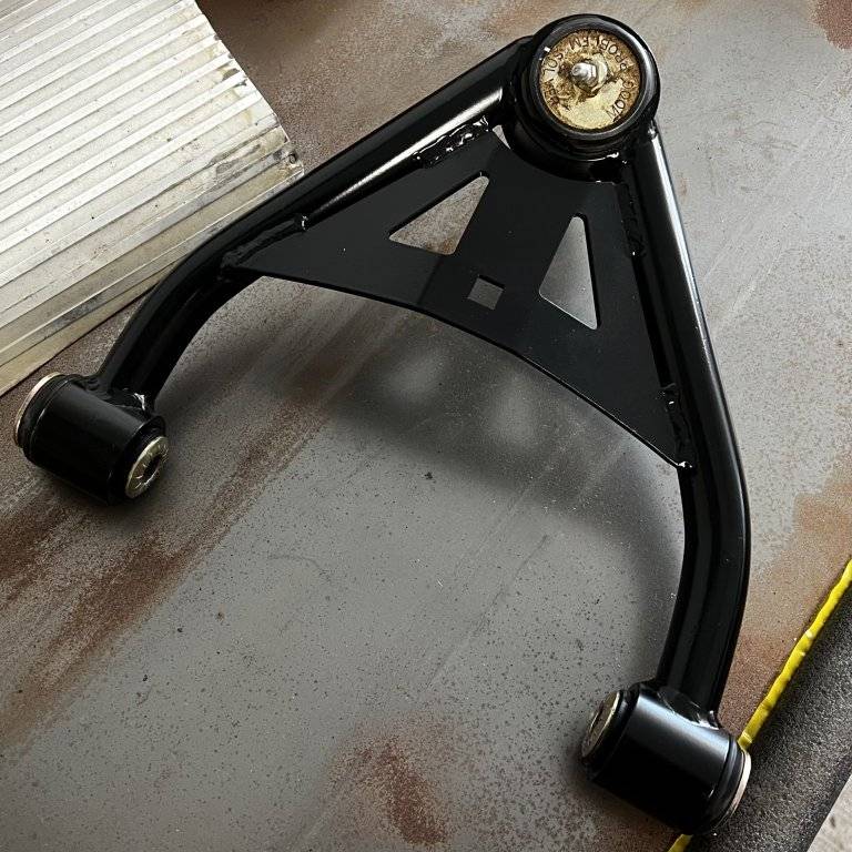

I have to mention too, the front frame / suspension is fully rebuilt and detailed. There are 1972 C Body disc brakes, I rebuilt the calipers myself and detailed the other components. The brake booster was rebuilt by Brake Booster Exchange. Hoping everything looks as nice as I envision it…

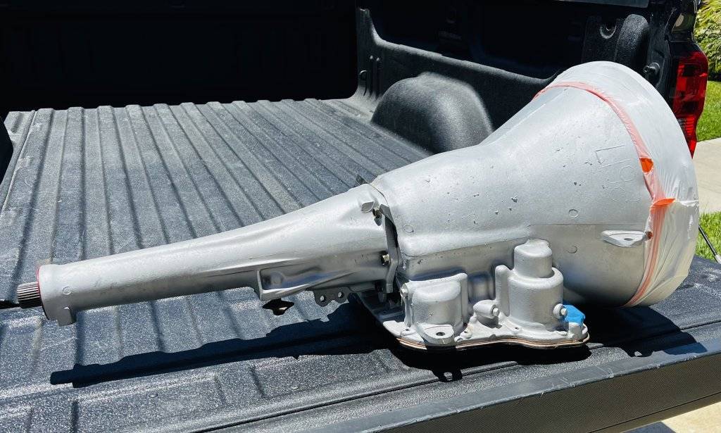

Oh yeah, can’t forget about this 727 tranny either. It was rebuilt with a TransGo TF-2 kit.
Next step is to get a new driveshaft made. I have 2 junky ones that came in the trunk of this car. Hoping the local drive shaft shop can use the the 2 broken ones as a good template for a nice new one!
