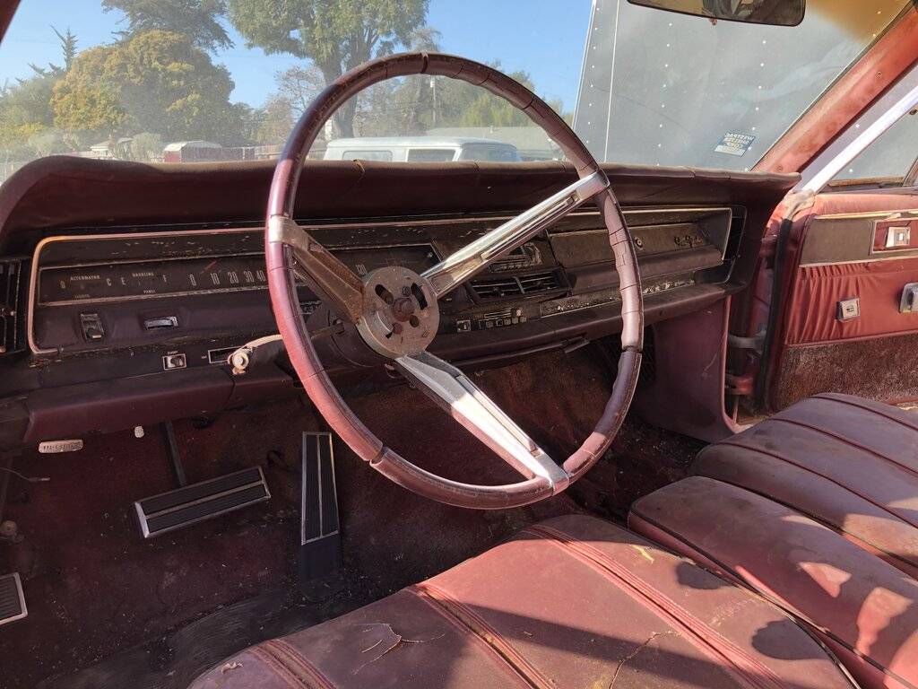

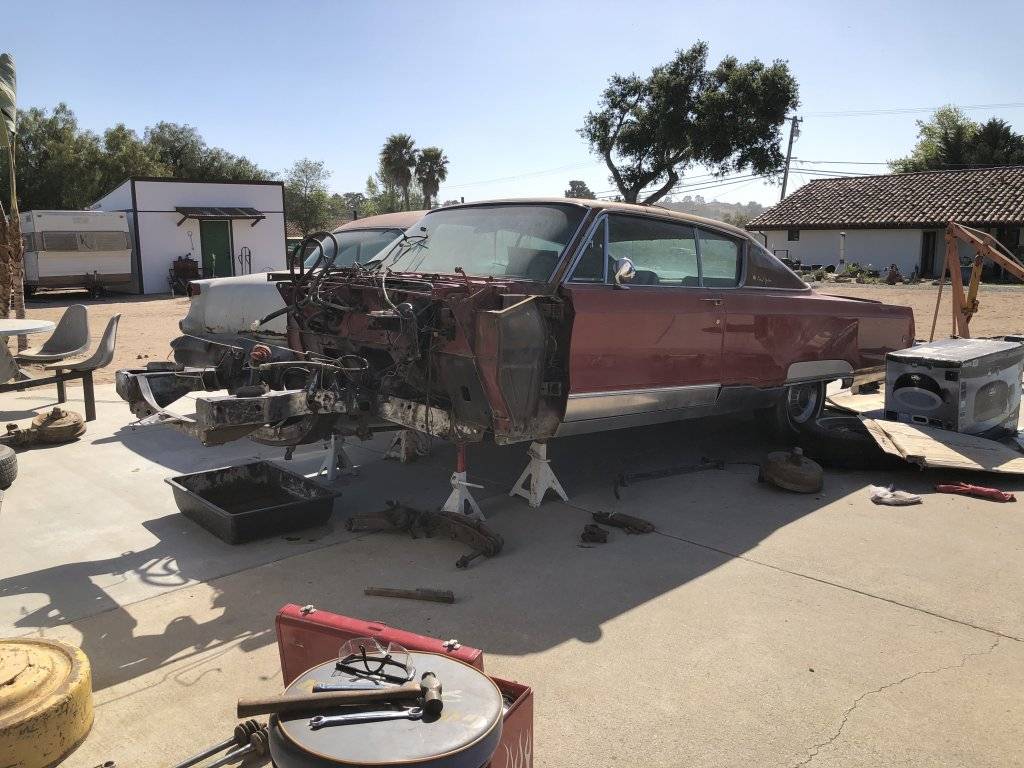

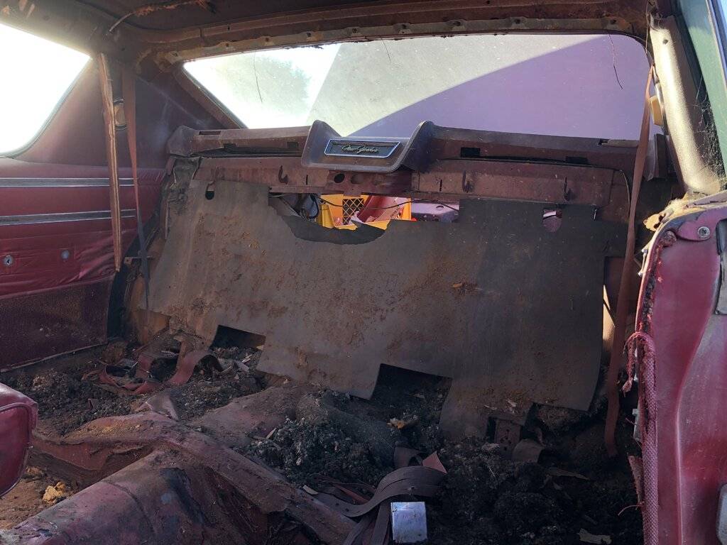

I turned 19 about 3 weeks after I bought my car in early January of 2020. I didn’t do much to the car while I was 19. First, I began to remove the interior. The dash was terrible!

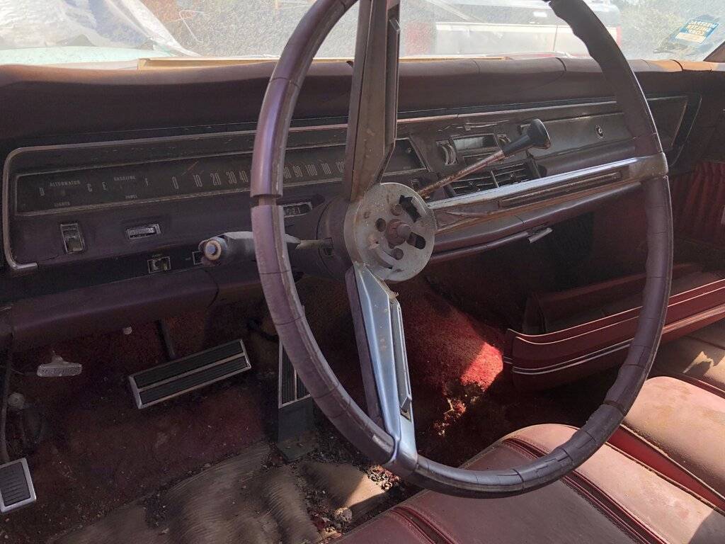

After sitting in the desert for 40 years, the interior became very brittle. Seat foam was hard and crumbly! If you sat on the seat, it would just turn to dust. Not only that, but this car became a rats nest. INFESTED with mice from top to bottom. The amount of urine and other feces they left was disgusting. Because the car was left with windows closed, it was like a greenhouse effect of rat piss evaporating and tarnishing any of the stainless / aluminum finish in the car. My floors rotted out as well! I tore out what was left of the carpet. It was pretty bad

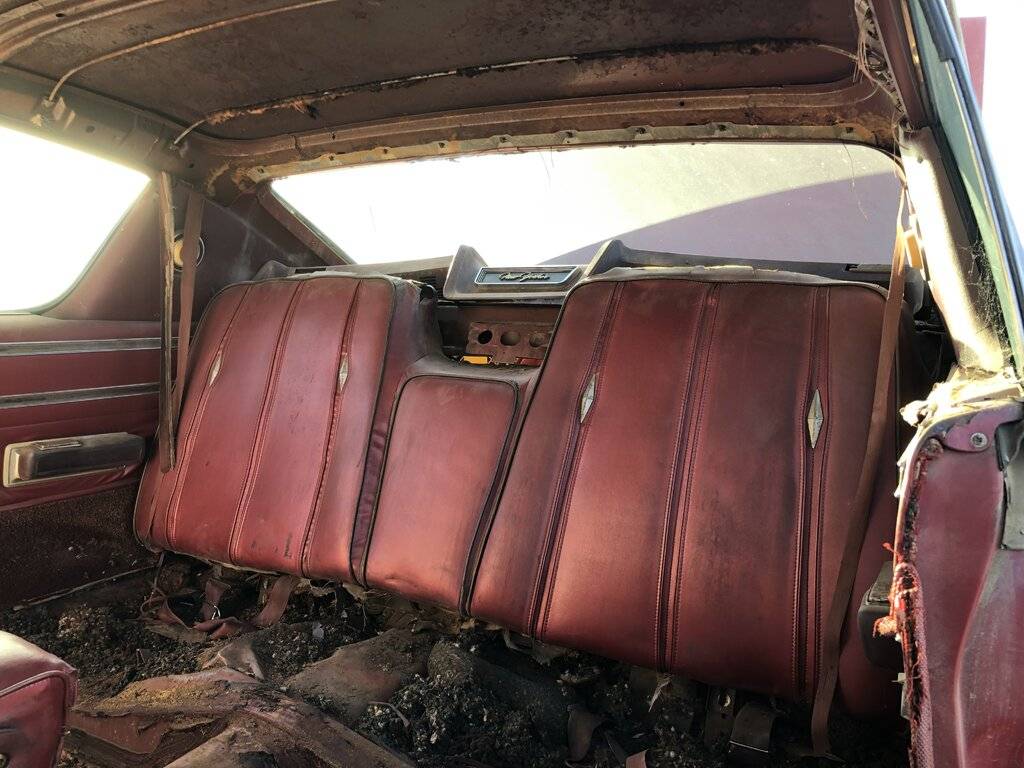

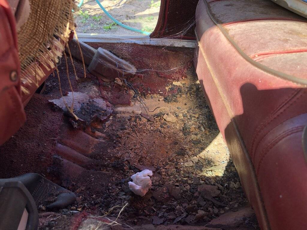

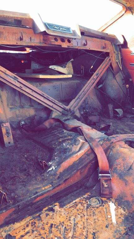

i found that my floors were rotted pretty bad! Especially after I removed the rear seats

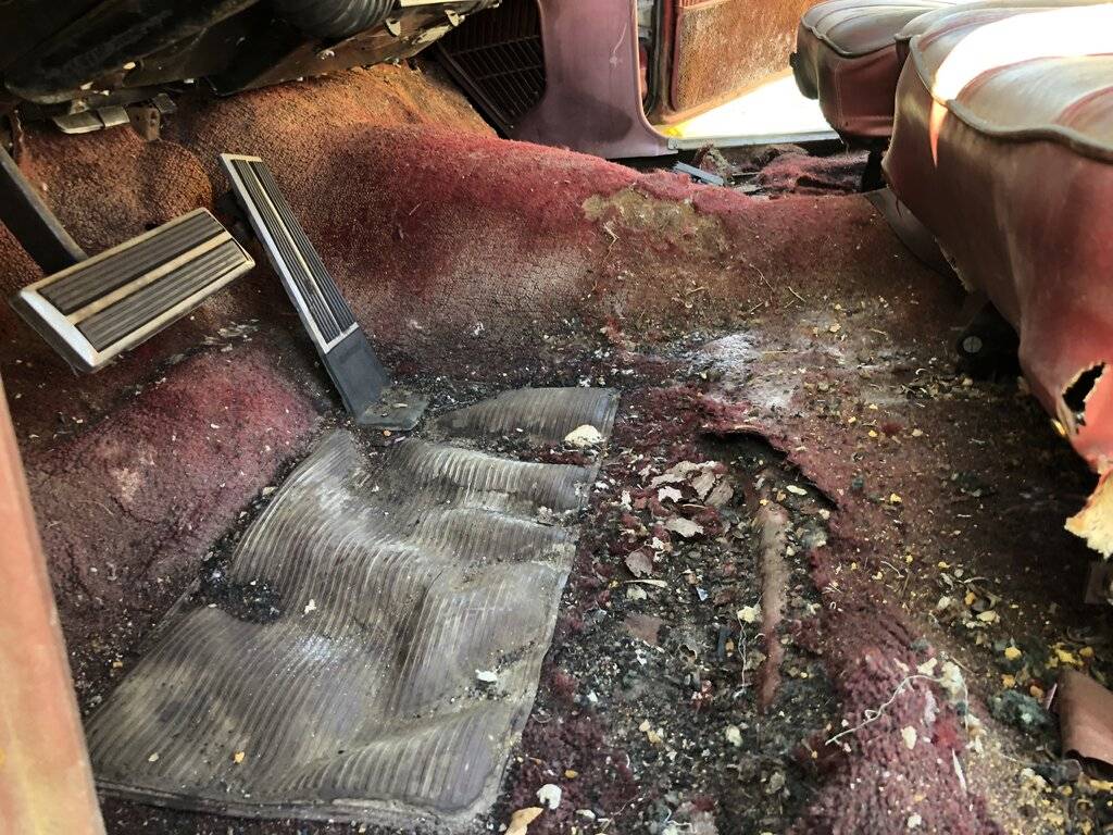

All in all... you could say my interior was pretty trashed (still is as I type this )

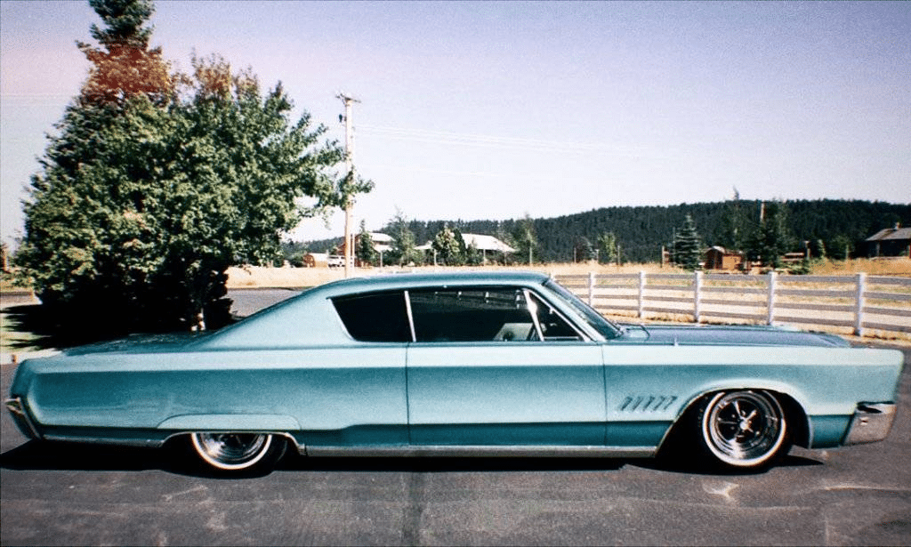

Long term goal: yes a lowrider juiced with 4 batteries and 2 pumps. I’m a traditionalist however, I don’t care for 3 wheel motion or even hopping. My vision is a clean sky blue metallic paint job, lowered on some 15” Chrysler Magnum wheels with thin whites. The hydraulics will be more of a lay and play setup with accumulators for a softer smoother ride. I wanna drive this car everywhere!

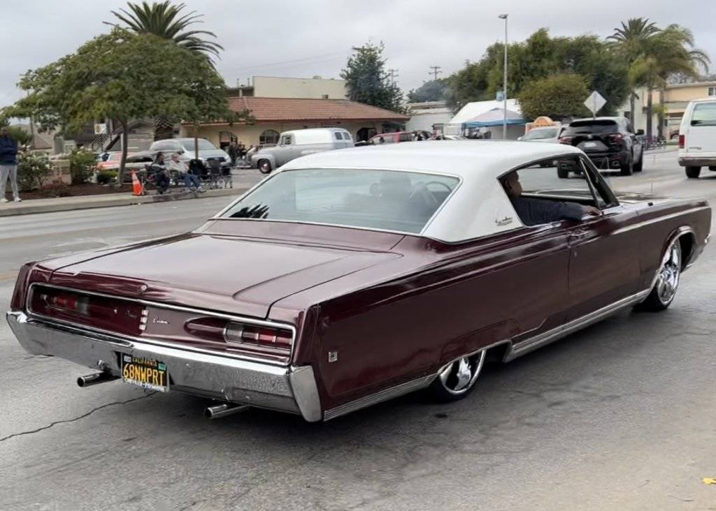

Personally, I think it’s way easier to juice a c Body than it is to bag one. The shock mounts are a perfect location for a hydraulic cylinder. Although, you’ll probably need to cut that driveshaft tunnel and raise it towards the rear so the driveline doesn’t rub… My FB friend had a slammed 68 4 door in Colorado on juice. With the accumies he said it rode the way it did when it was stock too.

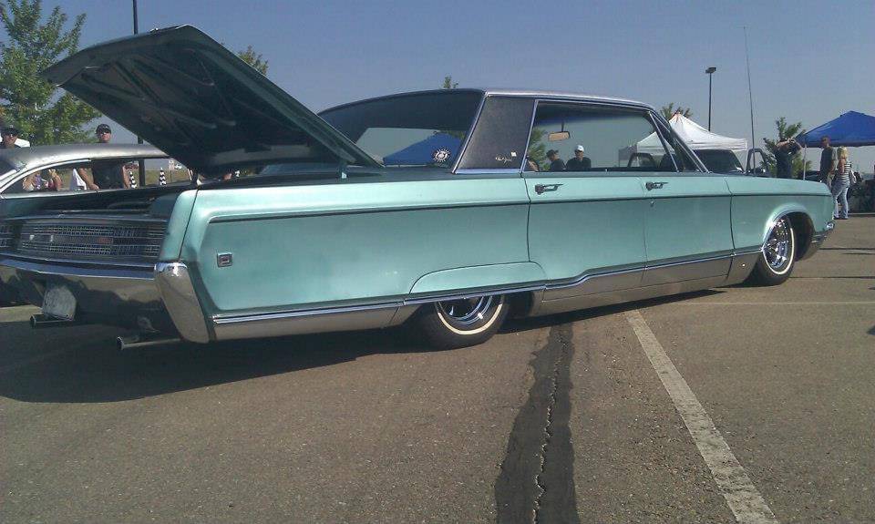

Here’s one low Newport that showed up here in Santa Maria one year for a big car show.

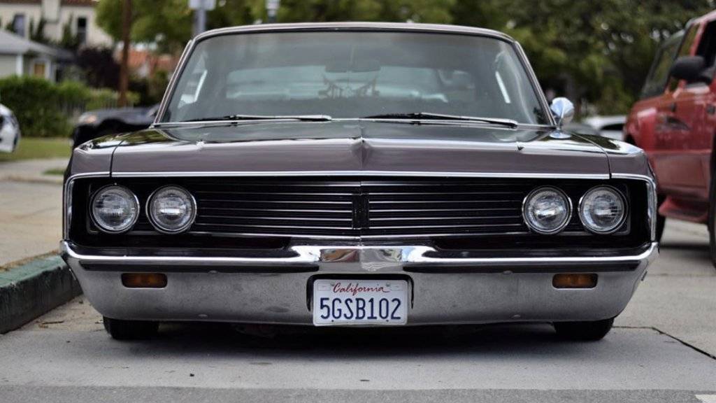

And here’s a pic I took of the one that cruises around town all the time

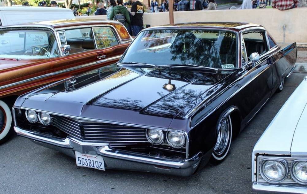

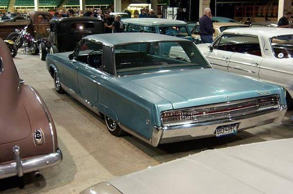

Mine is the exact same light blue as the first picture. Man just talking about this stuff gets me stoked.

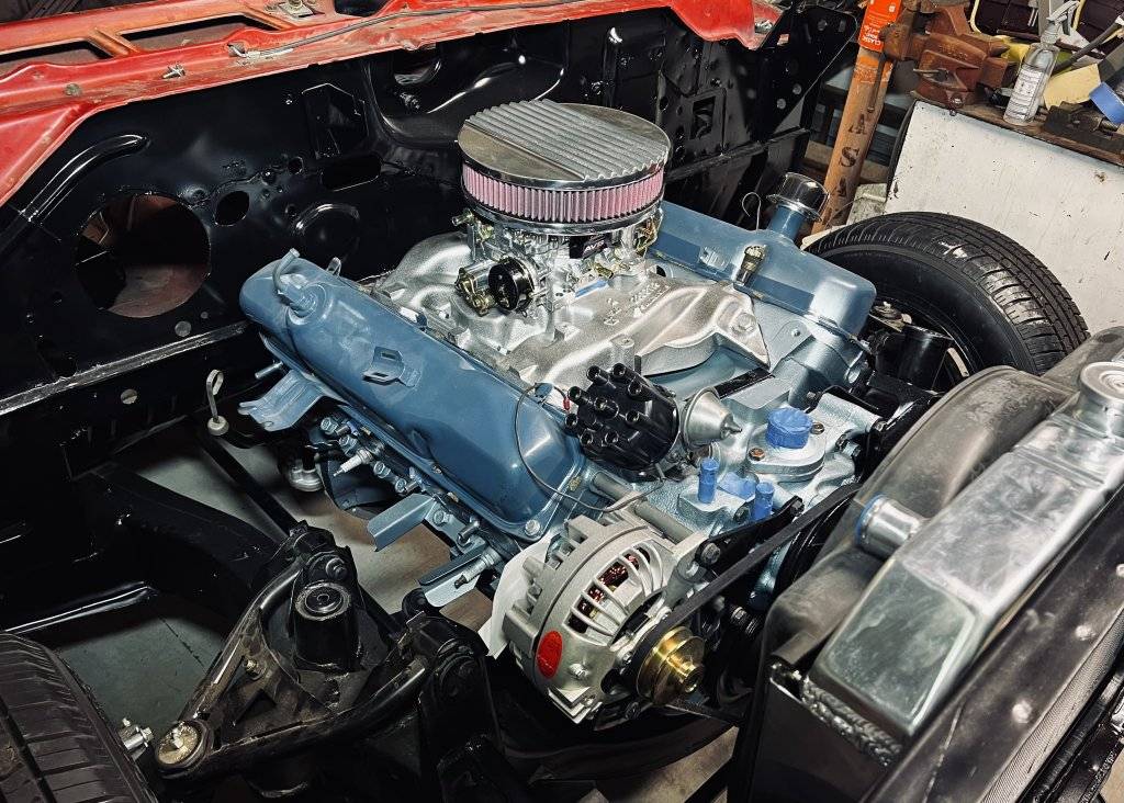

Current status on the 68! It is ready to be driven. The heater box is close to being done. I’m working on trying to figure out a few things, like how to keep the linkage free and not bind up.
The plan is to install the heater box before dropping the dash in place. I have basically all NOS switches for the dash, since mine were all toast. The dash frame will be sanded, primed and painted satin black to match with the dash pad.

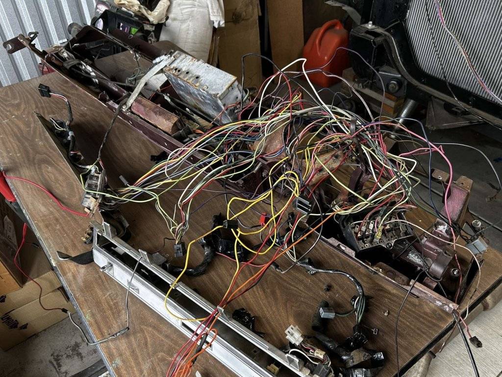

As for the wiring, don’t even get me started. I’m having it done professionally by an acquaintance of mine who’s done many of the show cars and daily drivers in town. The fuse block is trashed on my 68, so it’ll probably end up getting replaced with a modern GM style fuse block. All wiring is going to be cleaned up, replace the connectors that aren’t good, and bypass the ammeter while we’re at it. I’ve already converted the gauge inside the cluster to a voltmeter. Currently my dash looks like this
Not fun whatsoever! But it’s gotta get done. I have a CLEAN 8 track stereo and matching bezel, rebuilt cluster …. The dash is gonna GLEAM. I can’t wait to see it shining at night.
Once I drop heater box and dash in, I can re-install the steering column, hook up the tranny linkage and kickdown, hook up the throttle and plumb the brakes… she’ll be ready for her maiden voyage! Oh but I can’t forget, it needs an exhaust. Probably going to go with dual 30” glasspacks.
