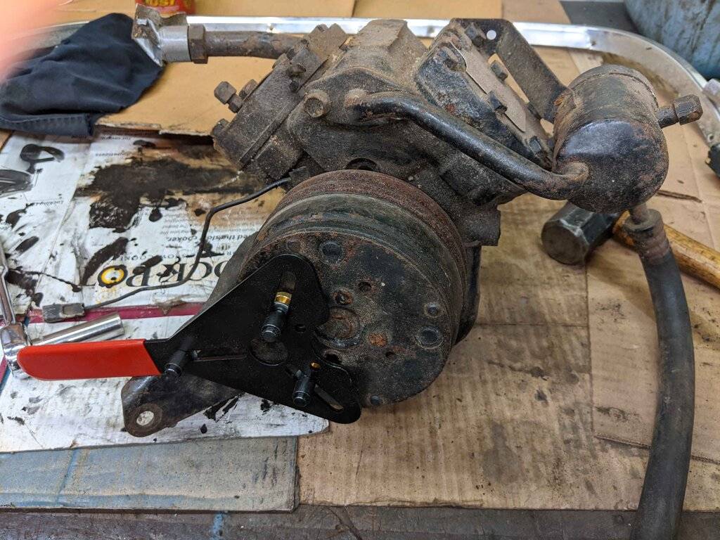

AC Clutch Tool, 1973 Compressor
Do you know if a clutch from a 4 prong pulley/hub is the same?

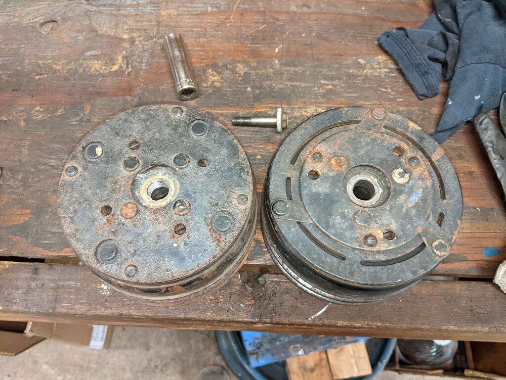

The parts book initially shows only one clutch and one field coil for '73 v/8 equipped cars. If memory serves me correctly, the 4 prong hub super-ceded the 3 prong unit and was a bolt on, but I am not sure. Parts book shows #3502327 super-ceded by #3502746 but it does not specify as to if the newer unit is a 3 or 4 prong.
Dave
Dave
Thanks for the info on 4-prong!
Pulley and clutch are same.

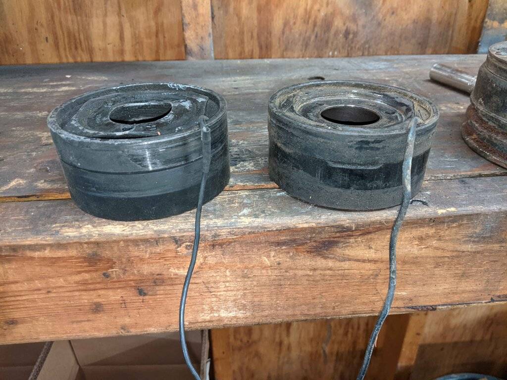

Good clutch on right. 4 amp draw and no damage.
Powerbuilt tool works on 4 prong. Thanks @65sporty
