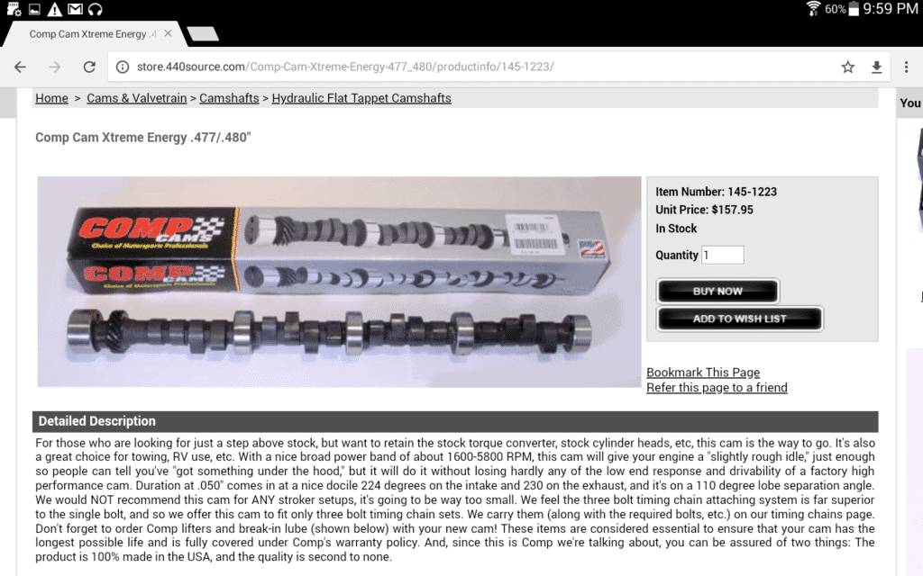

Thanks guys for all the input, i guess i misled you on the shims i ment the washer type shims that are on both sides of the hold down blocks, they said i don't need them but i thought they would line up a lot better with the valve stems than they did ? I will enclose a photo of the cam i got, it says i can use my stock heads and so on but i did not see where i needed adjustable rockers until i installed it and it says in the instructions they are required ?

Those are to spread the support across the shaft and space the rockers properly, You have to run those, yes.
Adjustable rockers are only required if you are running the anti-pump-up 867-16 lifters. The standard 822-16s do not require any adjustables.
In both cases, you must make sure the lifters have proper preload. With the 822-16s that would be .050-.100". That's a large window and is usually in spec with typical rebuild work and parts. With the 867-16s the preload is .005-.015". That's a lot harder to hit without using adjustables which is why they say they are a must with those lifters.

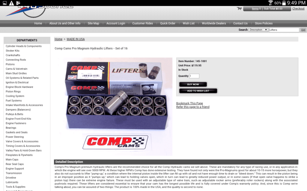

The lifters iam using are comp cam # 145-1001 its what they recomended for there cams. I will enclose a picture and discription of them.
Your reading too much into this. Your valve to piston clearance is huge in a stock engine and the chance of your valves hitting the piston without a complete mechanical failure is slim to none. Use your stock rocker arms and push rods. Anything with less than 300° duration and .500" lift is not pushing any limits.
Yes good rocker arms will net you power due to better geometry and a more true ratio, like maybe 5 hp at the levels you are at, and not from the rockers you are looking at.
If i run the 822-16's with the cam i have do i need adjustable rockers ?
Moper listed those in his post as not needing adjustable rockers. The other anti pump up lifters are for stock racing classes where you have to run hydraulic lifters bit need the engine to rev really high. Your cam and pistons are not designed to do this.
Thanks for the info, do you think I can run my stock rockers with the cam and lifters I have now ? I don’t really want to bother with rollers if I don’t have to.
No offense but Source is not about supplying really good tech.
The Comp catalog lists the 145-1000(822-16) with an optional 145-1001(867-16). That's the same for all the XE line including the XE Hi-Lift. If it were me, the Hi-Lift versions would get the 867-16s. The other XEs really don't need it. I've run the XE294H to 6500 with standard lifters with no problems... Source wants to sell you more parts.
The plain lifters are fine for the cam you have. Source # 145-1000
